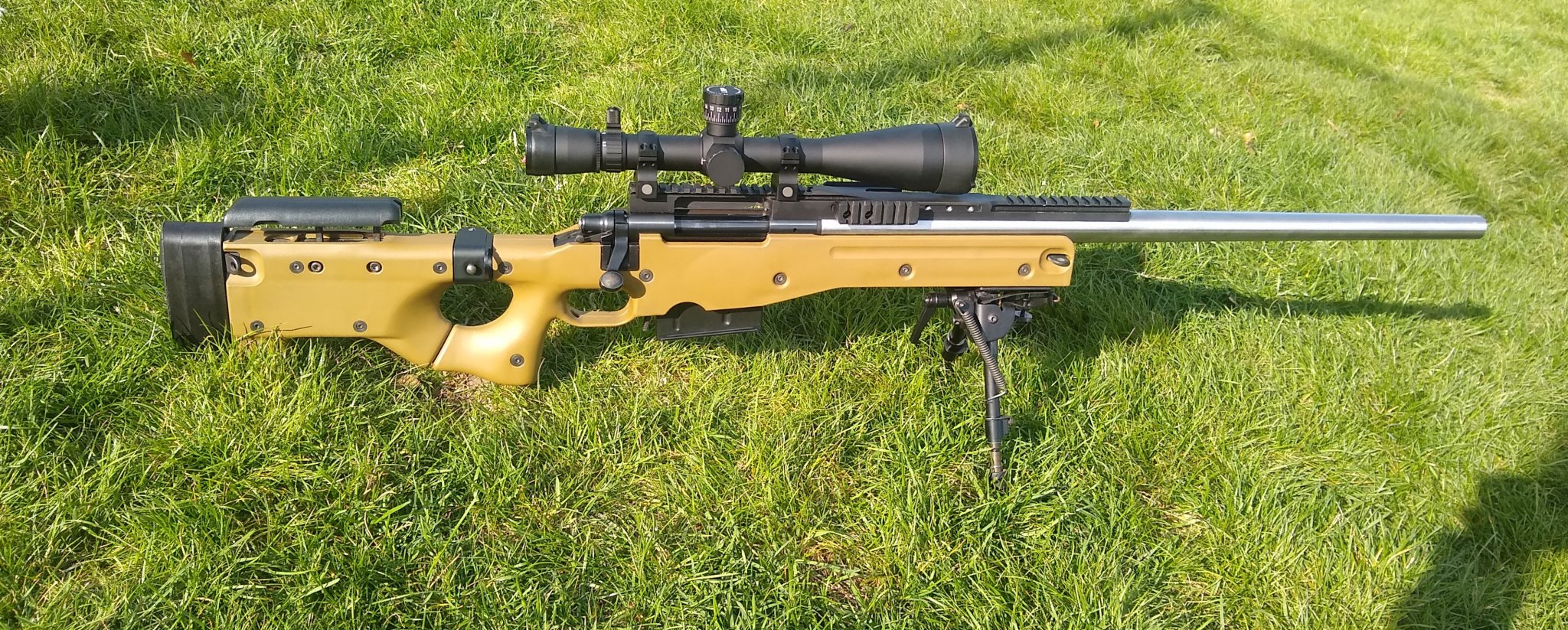

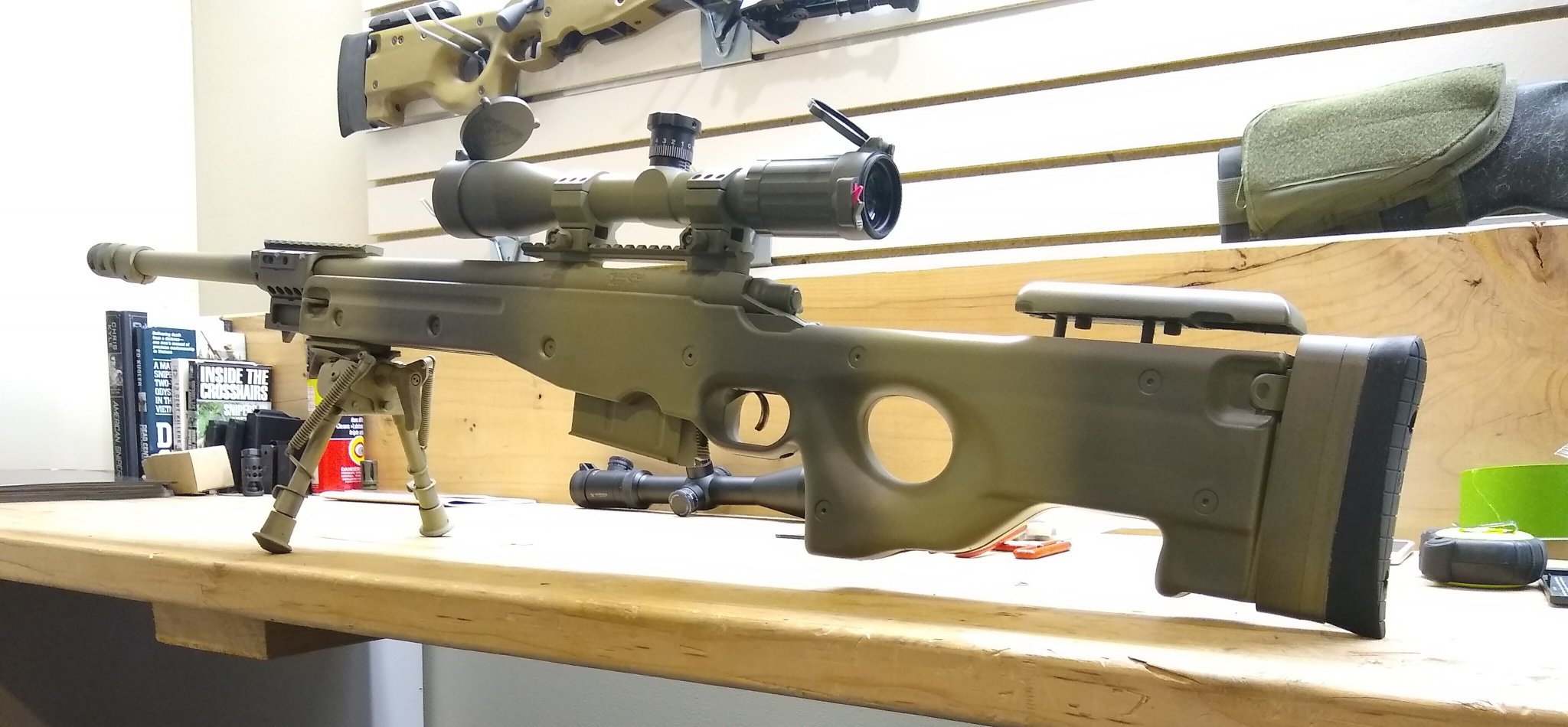

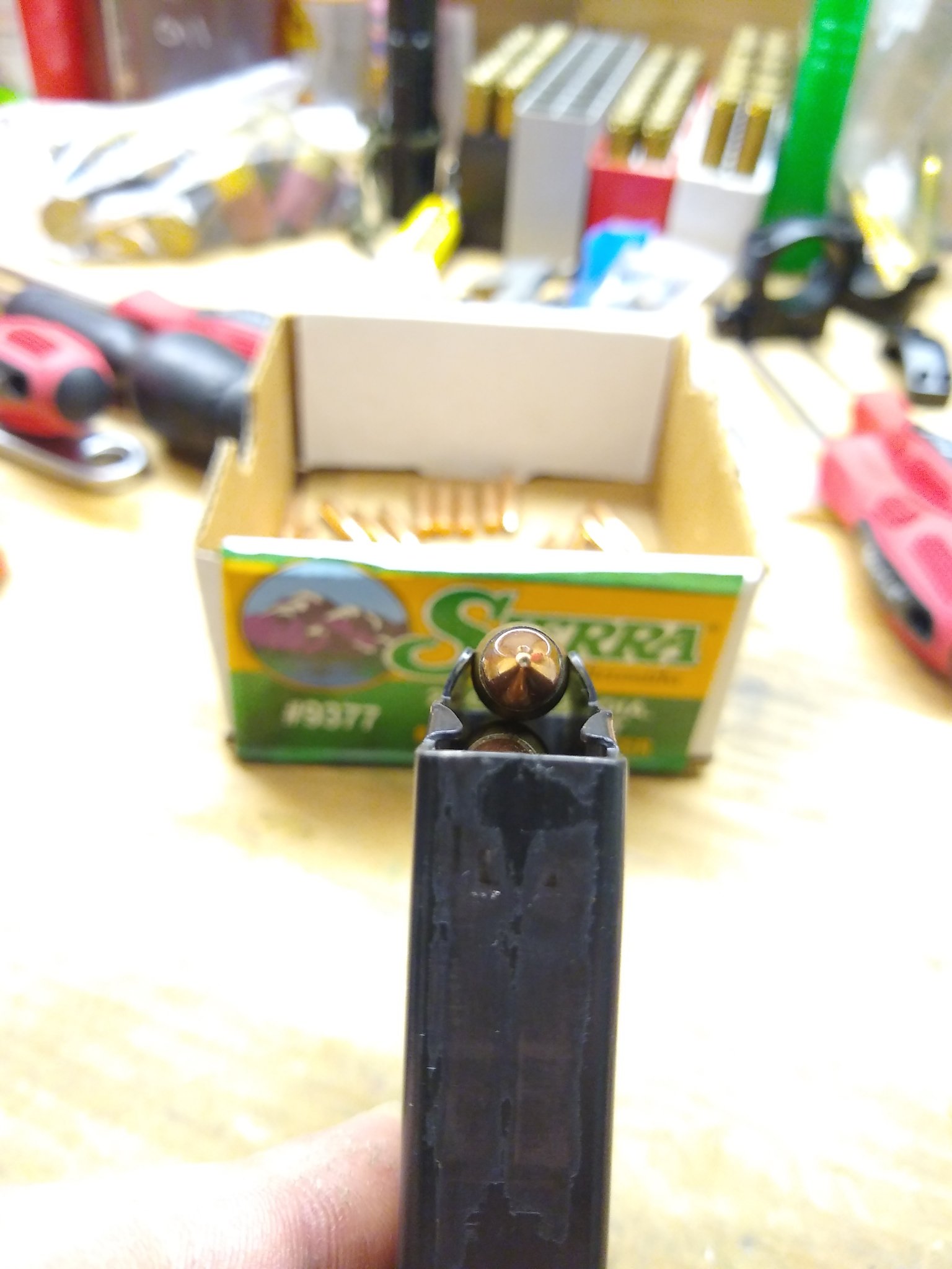

You can easily tweak the lips of a .300 wm A.I. or Accurate magazine to accept the 30-06 cartridge. I have done it with great success in three separate rifles. All with A.I. stocks running 300wm magazines with the 30-06 and Remington 700 pattern actions.
- Jon

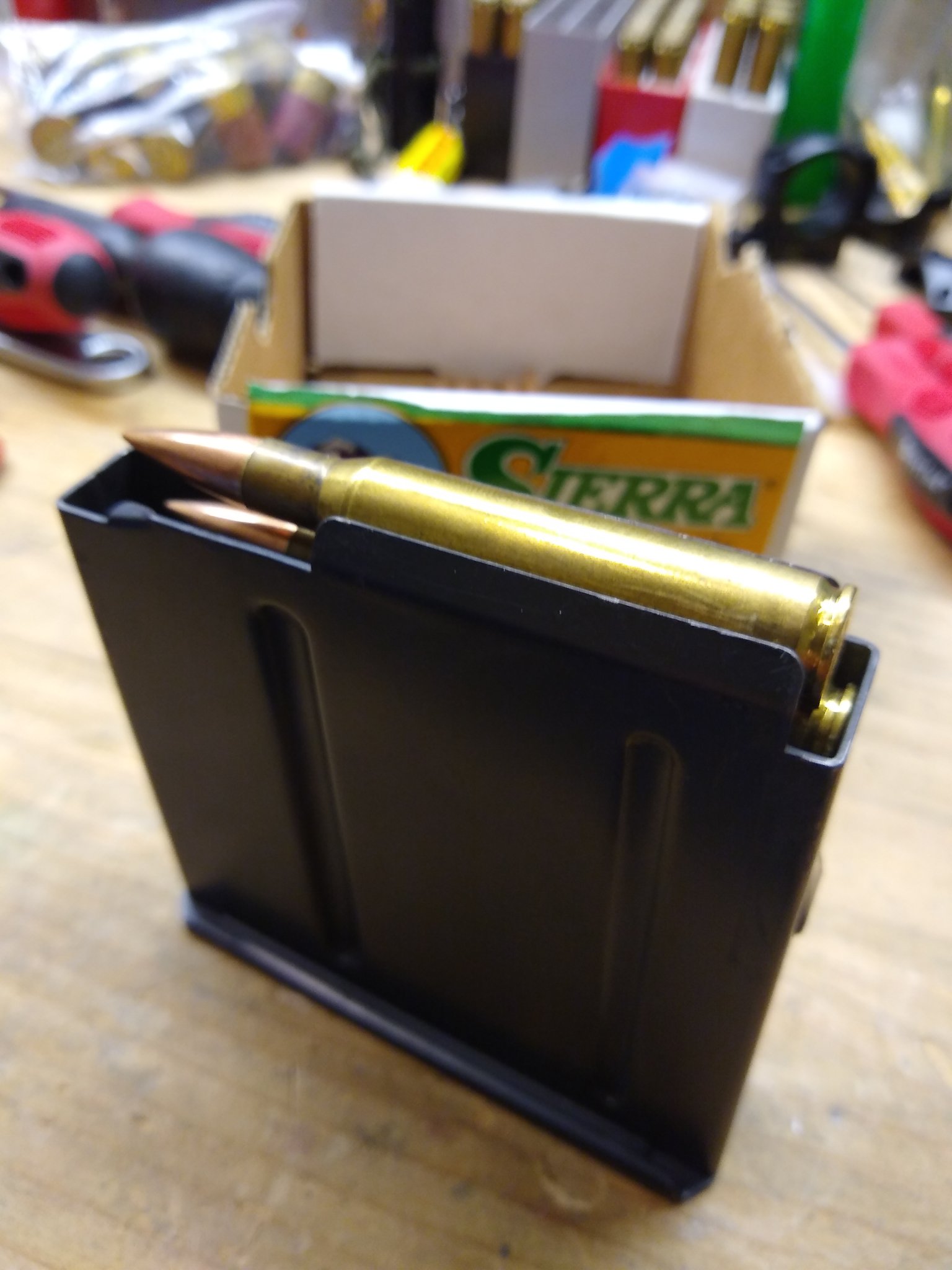

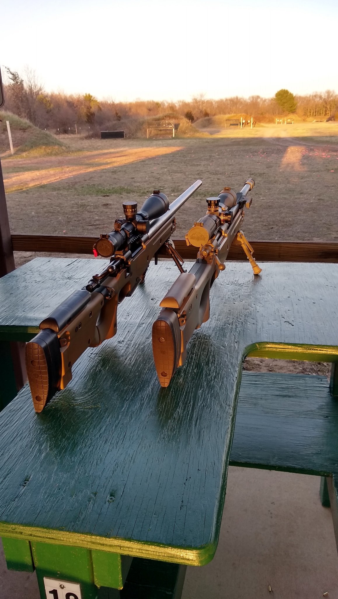

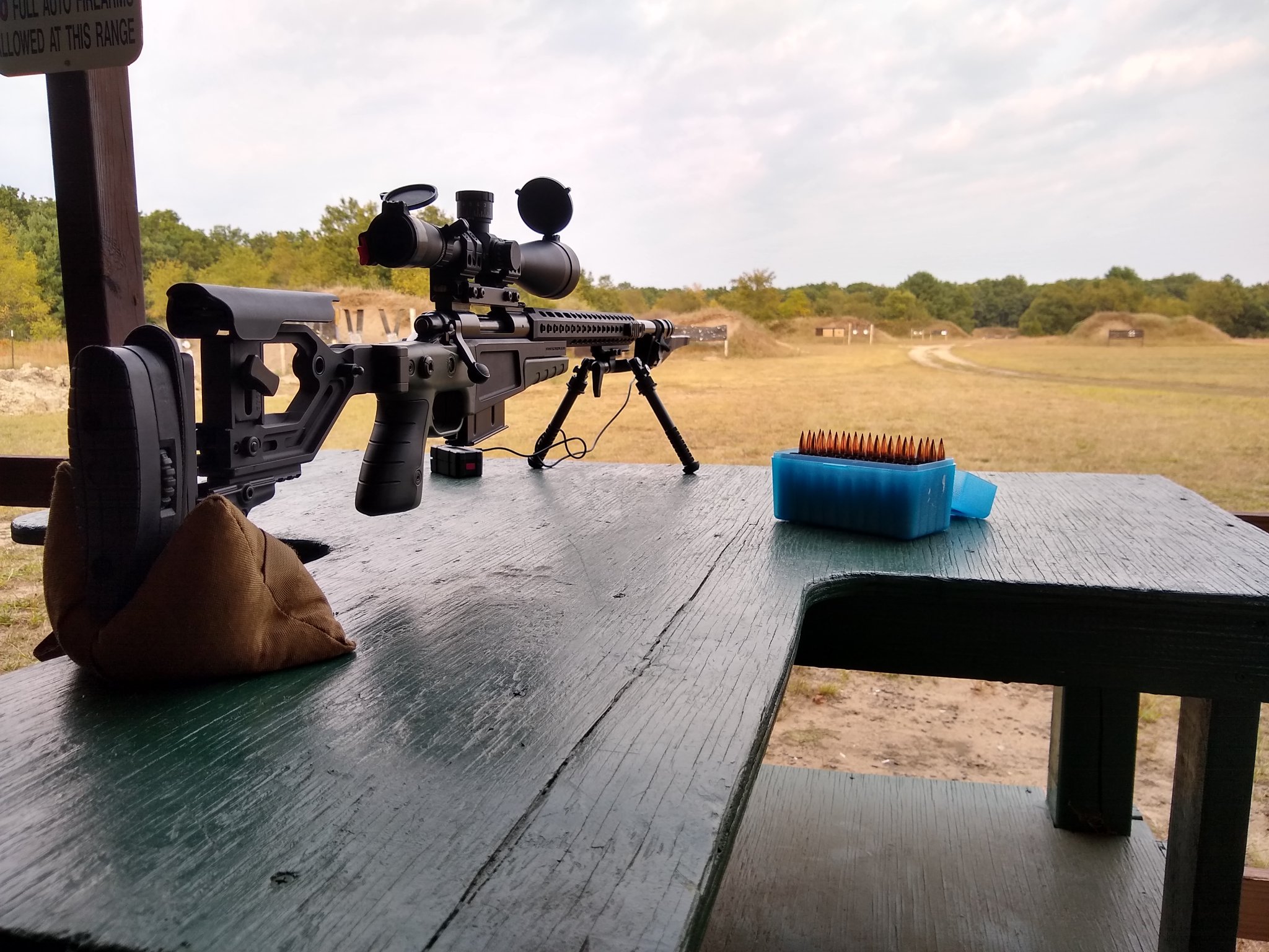

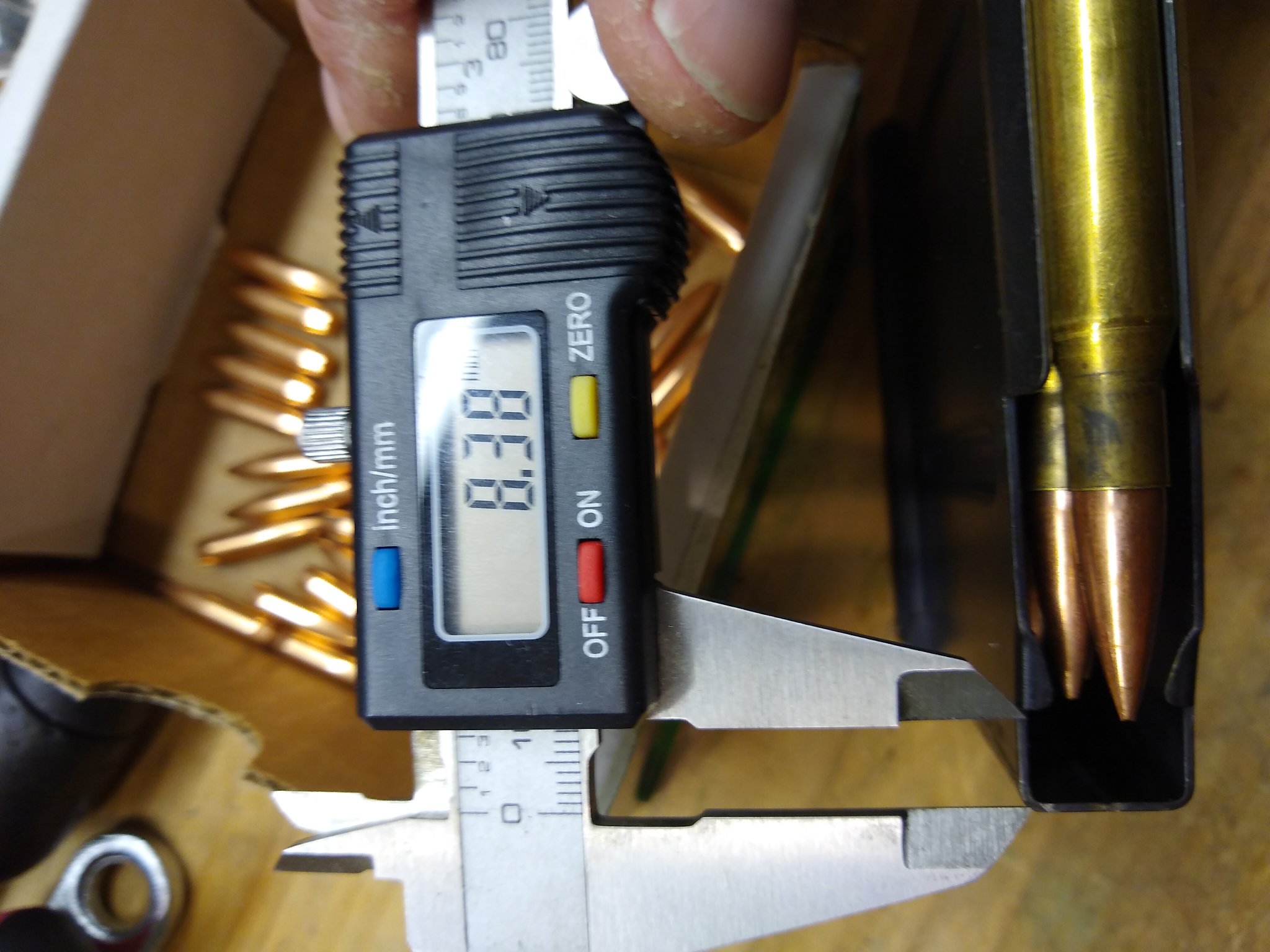

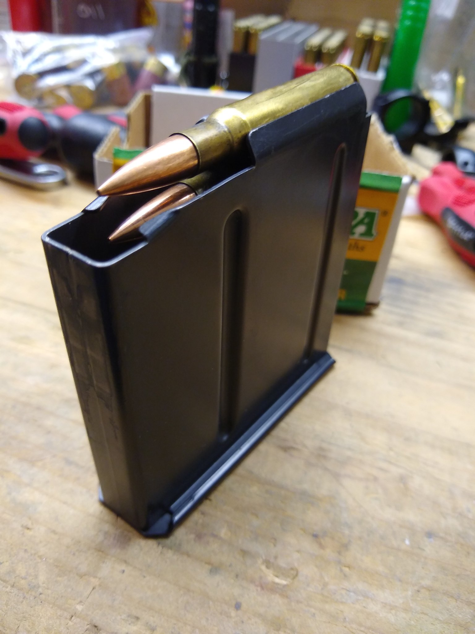

Those a beautiful looking builds my man. Question how many .30-06 rounds are you fitting into a 5 rd. .300 Win Mag AICS magazine? And that is a AXAICS chassis in the first picture correct? Do you know if the #4368 10 rd. magazine fits in that chassis?
Thank you for the kind words. I can fit six -06 rounds comfortably in a standard 300wm A.I. magazine which also fits the AX chassis and feeds them properly minus the front lip.
Following. This is similar to what I’d like to do as well. I love to see the ‘ol graybeard .30-06 still kicking ass and taking names
Reactions: HeavyAssault
The difference between the two A.I. magazines is the lip on the one for the ax chassis. The lip is there so you can tip it into the chassis. The regular magazine needs to be inserted straight into the ax chassis.
