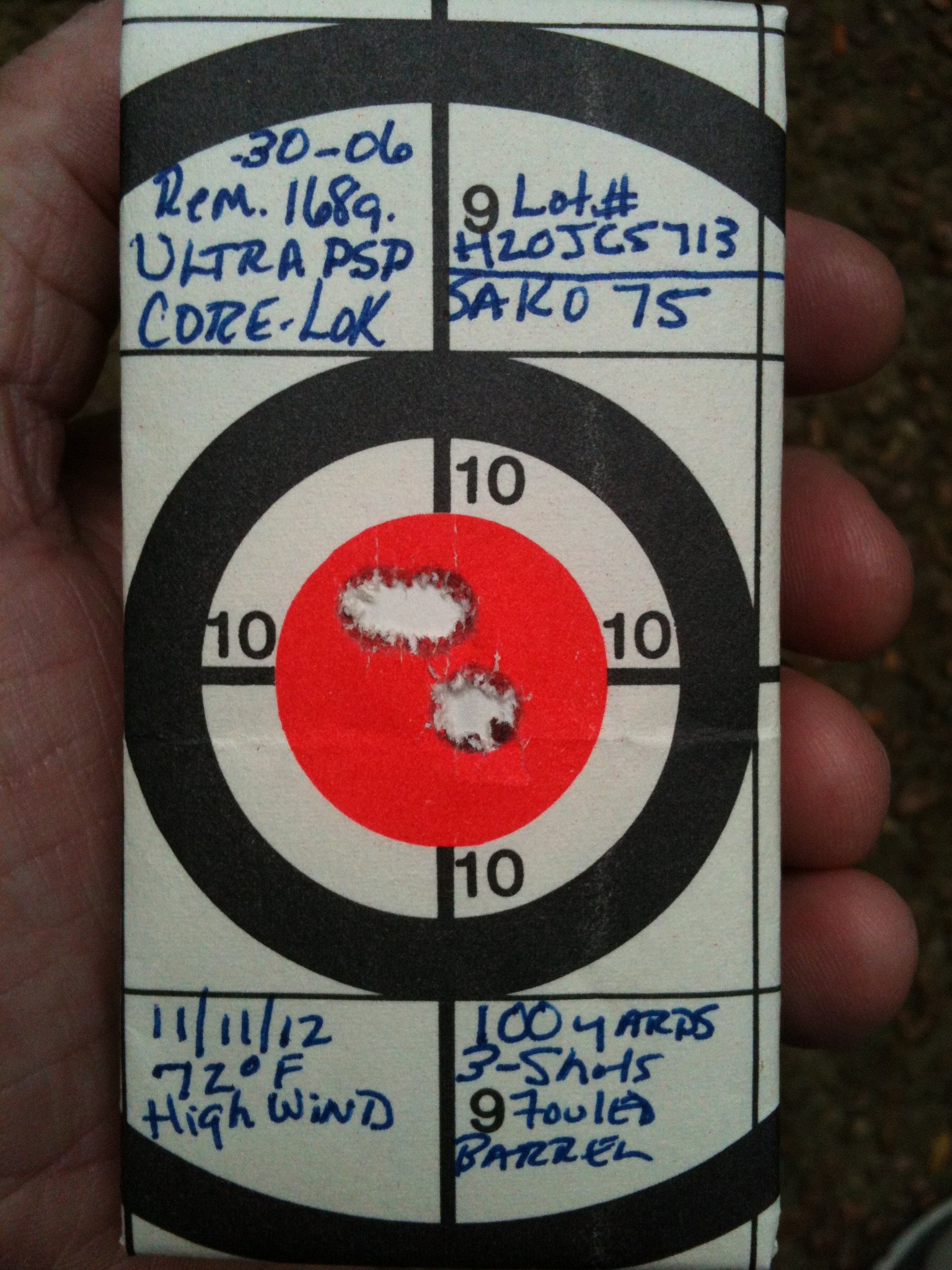

I have a Sako 75 SS/Syn .30-06 that is batting a 1000 with Zeiss Conquest (the original version) 3-9x40 #4 reticle that I really like. I can't speak for their current "85" platforms, but I really like my "75." Good shooter with factory ammo.
