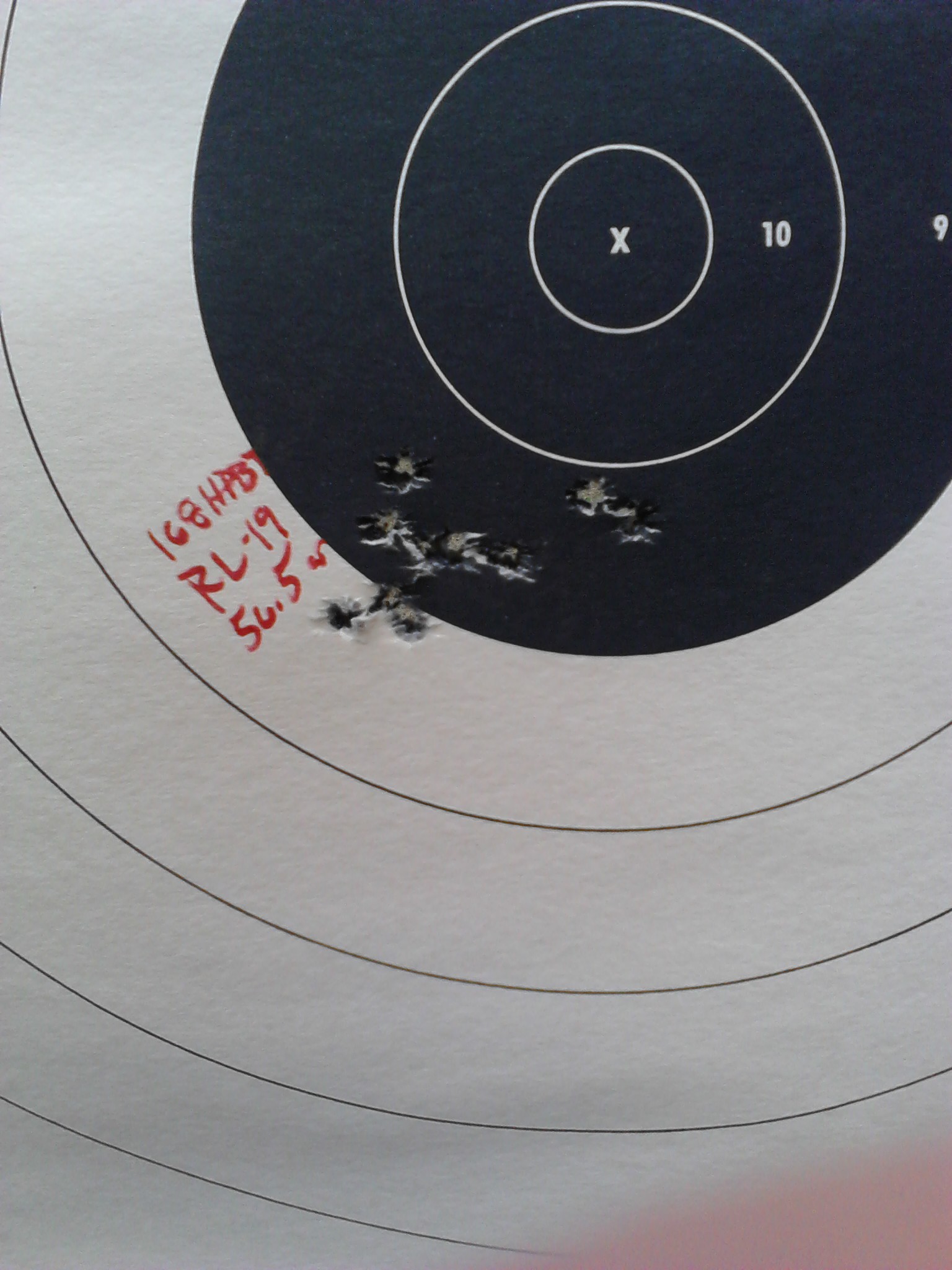

I noticed with 46.5 grains of Varget that it didn't give me very good load density.
Sir just thinking if you are looking to fill the case RL19 will do it and it shot well in my 03....
Id probably play with this powder more but Im looking for something I can use in the Garand also.

This is 155 AMAX with the lightest mfg recommended charge of IMR 4064, seated to magazine length:
