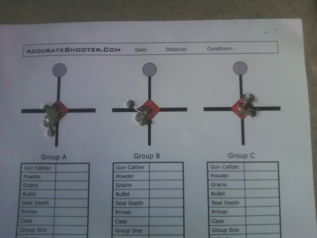

Today I revisited that magic load with some different brass and different components to put it to a torture test of sorts. I have some good Lake City brass attached to some remanufatured M2 ball pull downs so I loaded up some I had pulled. I did not size them, although I probably should have. I did pop the primers out of ten cases and replace with BR-2 primers. The primers that reside in the M2 ball are obviously CCI but I don't know if they are magnum or standard.
All rounds were loaded up with 59.5gr of H4831SC and 180SMK seated .010 off the lands. Each string was 10 shots except the Lapua brass group. Someone had left a shootnsee sight in target up with the diamonds in each corner with a 3/8" dot in each, I simply could not resist and yes I hit it dead nuts, so C is actually 9 shots. I know I should have taken a pic of that with the cell phone too.
Some wierd things happened. First the LC cases I switched to BR-2 primers had the highest SD of the three and the largest group was the second best SD using the primers of unknown origin. Actually I have seen all that before but it is mildly entertaining. There was a flier in group B that very nearly doubled the size of the group, probably me maybe not, it was in the middle of the string and it felt fine.
Group A:As pulled LC Group B: LC with BR-2 Group C:Lapua w/BR-2
A:.877" SD 9.12 B:.824" SD 16.8 C:.564" SD 8.9
