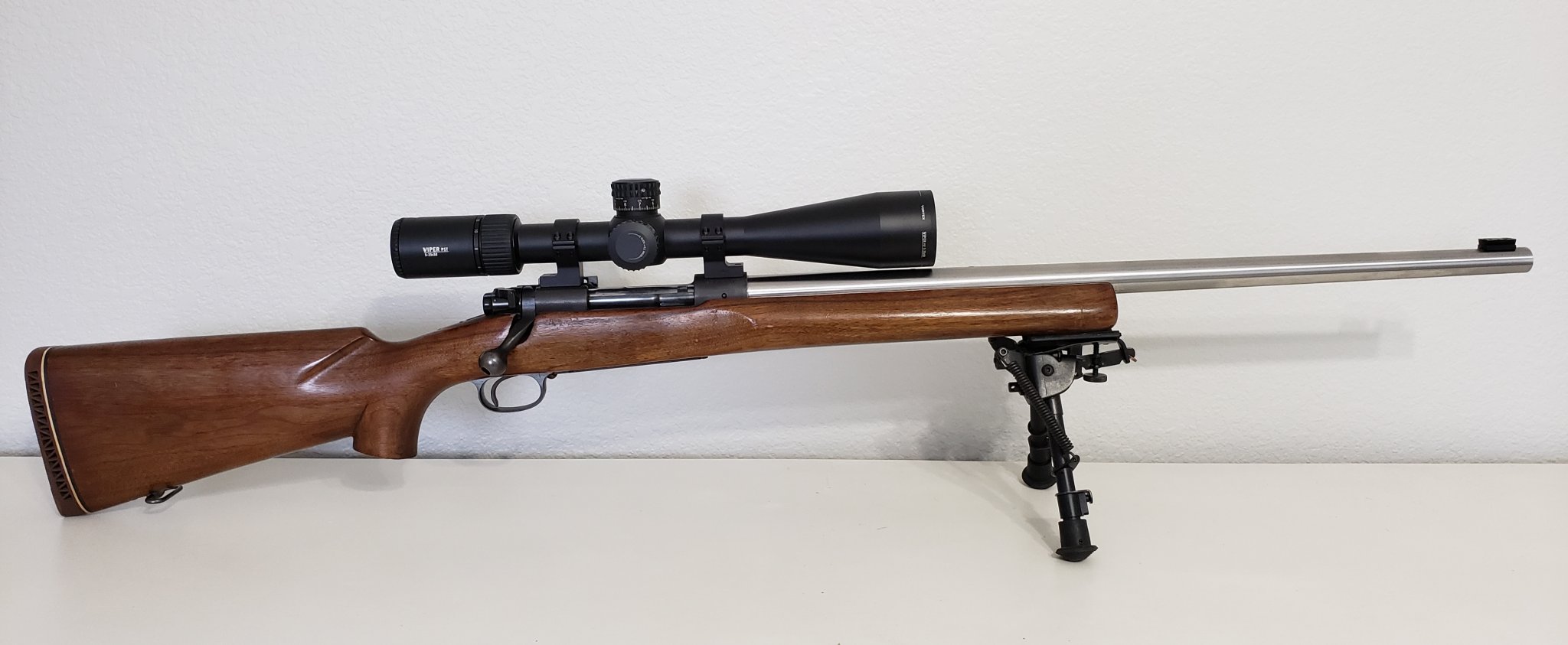

Lapua D46 185gr
Winchester brass
53.4 gr H4350
CCI200 primer
COAL 3.315"
Shoots extremely well in my '68 Winchester M70 Target

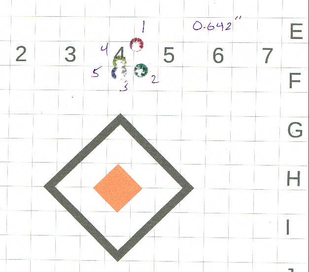

Here is a OCW target I worked up for the 30 06 208 AMAX and RE-17​
I shot over tandem chronographs in tandem and noted the velocities on the target​
All shots were fired "Round Robin".​

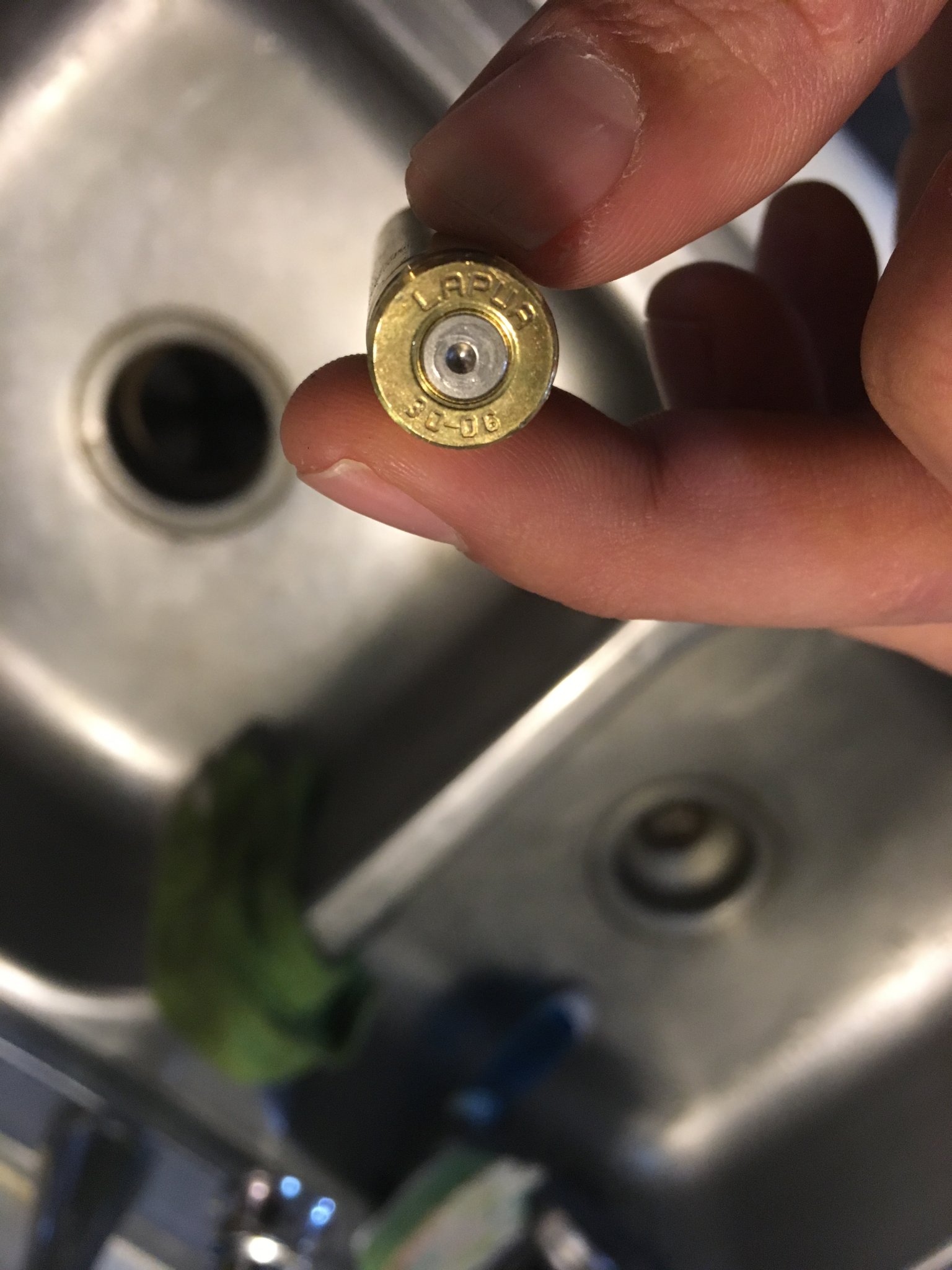

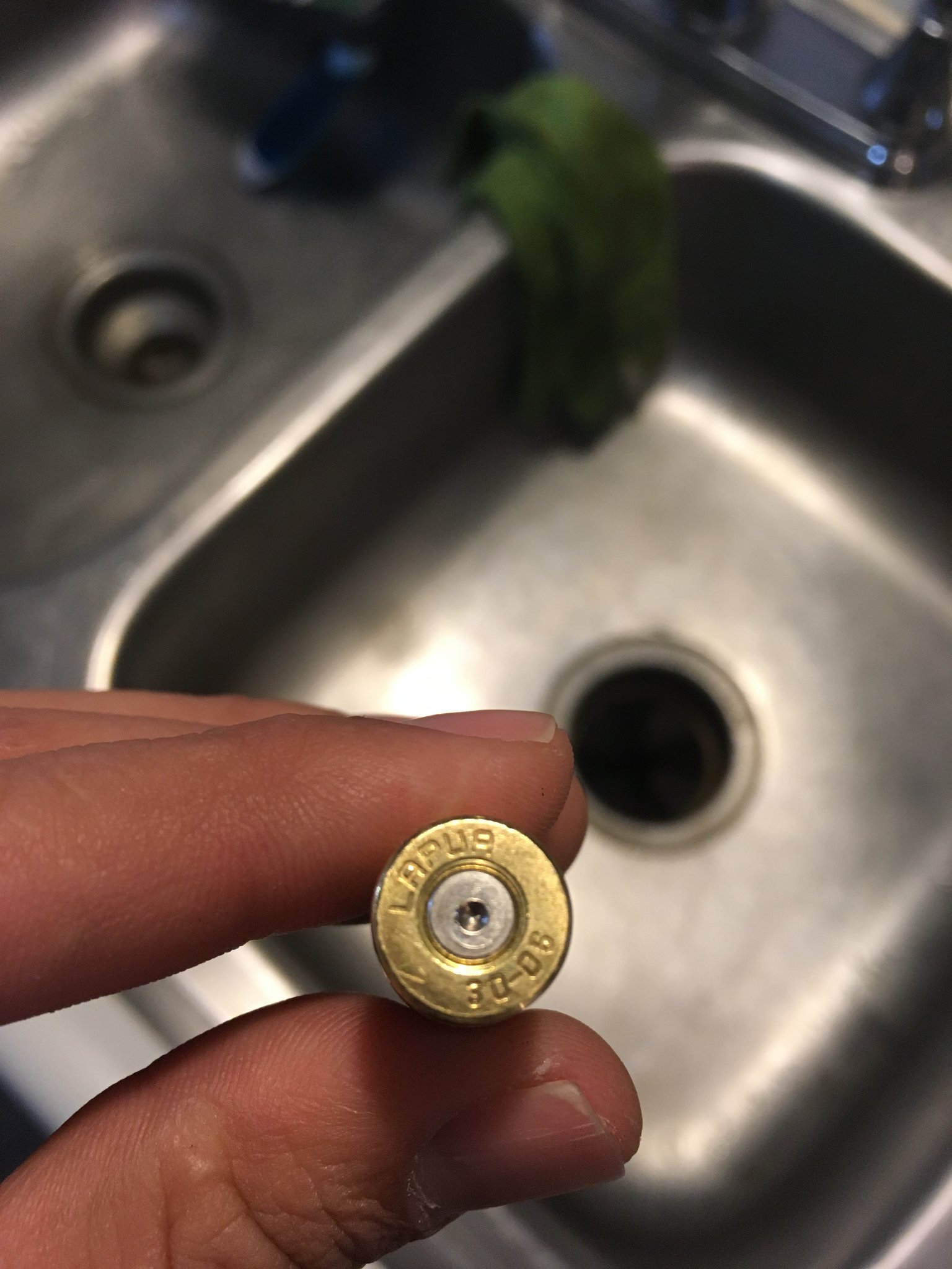

Please note these findings are for my rifle with a muzzle break.
Powder: Accurate 2700 @ 52 gr.
Bullet: Sierra Matchking. 200 Gr.
Brass: Lapua Brass
Primer: CCI 200
FPS: 2714 @ 4500
Barrel: Krieger Barrel 36 w/Vais break.
The 52 gr is right at the rifles limit for fps. A few more grains up I started seeing pressure signs on the primers.
Also found one just a bit slower for warmer days.
Powder: Accurate 2700 @ 51.1 gr.

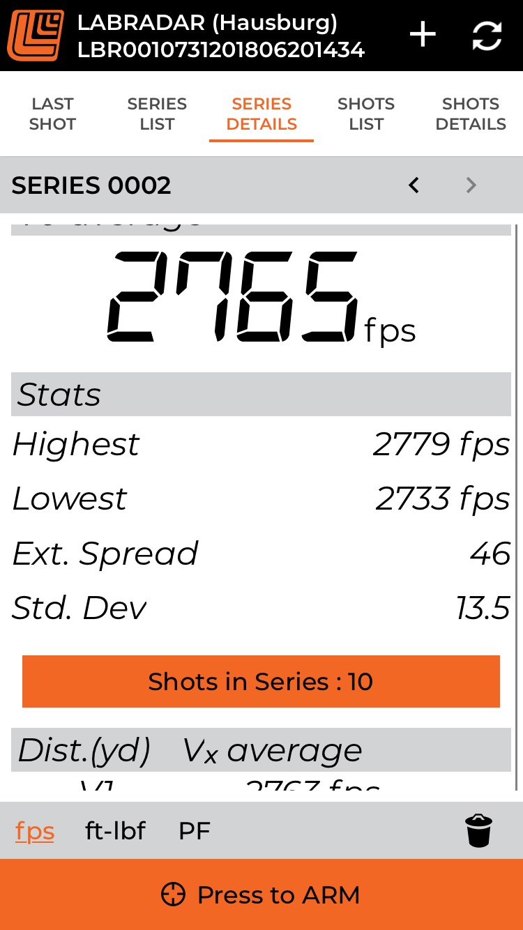

Here’s my latest Hornady 208ELD load from yesterday in my new Rock 10 twist 23” R700 30-06 also with German Salazar Serengeti chamber:
Fire formed Winchester brass, neck sized w/ .333 bushing
Fed 210M primer
54.8gr RL17
Hornaday 208 ELD
3.440 COAL (.005 off lands)
300’ ASL 66F 68% RH, an unusually cool and dry morning for this time of year in Northern Virginia.
10 shot group @ 100yds prone with a bipod on a concrete pad.
Chronograph data
I’ll run it out to 1K on Range 4 and report back....

Initial pressure testing with RL-26. No chrono data today unfortunately.
Chamber is PTG 30-06 National Match, .340 neck, .073 FB, 1’-30. Brand new barrel.
Lapua brass, virgin, CCI 200, went from 59.0gr to 62gr in 0.5gr increments.
208gr ELD @ 62.0gr, 0.020 off
215gr hybrid @ 62.0gr, 0.010 off
Tiny bit of primer flow on the 62gr hybrid load, no ejector marks on anything shot today. 50 degrees outside. There’s some funky circular marks on the primer from my bolt face but that’s just the rifle.
@Forward543 ’s Quickload max of 62.0gr of RL-26 under the 208gr ELD-M looks safe for my rifle.

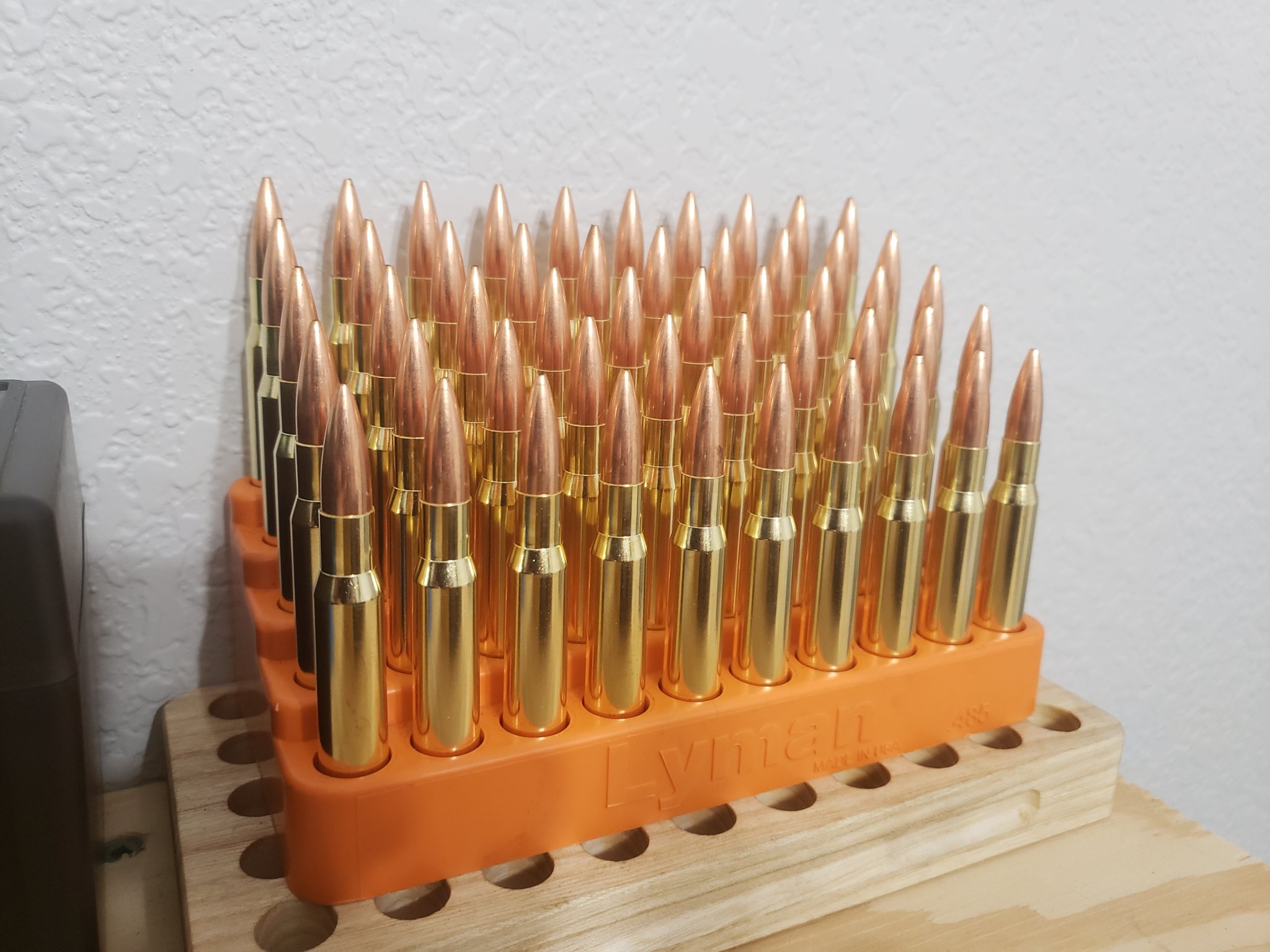

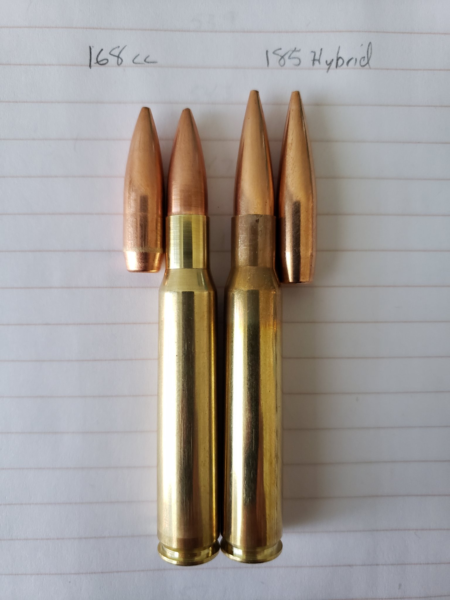

Pre '64 Winchester Model 70 Target
Bartlein 24" Barrel
Bullet: 168 Nosler CC BTHP
Brass: Lapua (Fired Case 70.3gr H2O)
Powder: H4350 @ 57.4gr
OAL: 3.290" ~20/1000 jump
Velocity: 2962 fps
SD: 7.0 fps
Bullet: 185 Berger Hybrid
Powder: H4350 @ 56.2gr
OAL: 3.430" ~20/1000 jump
Velocity: 2868 fps
SD: 6.7 fps

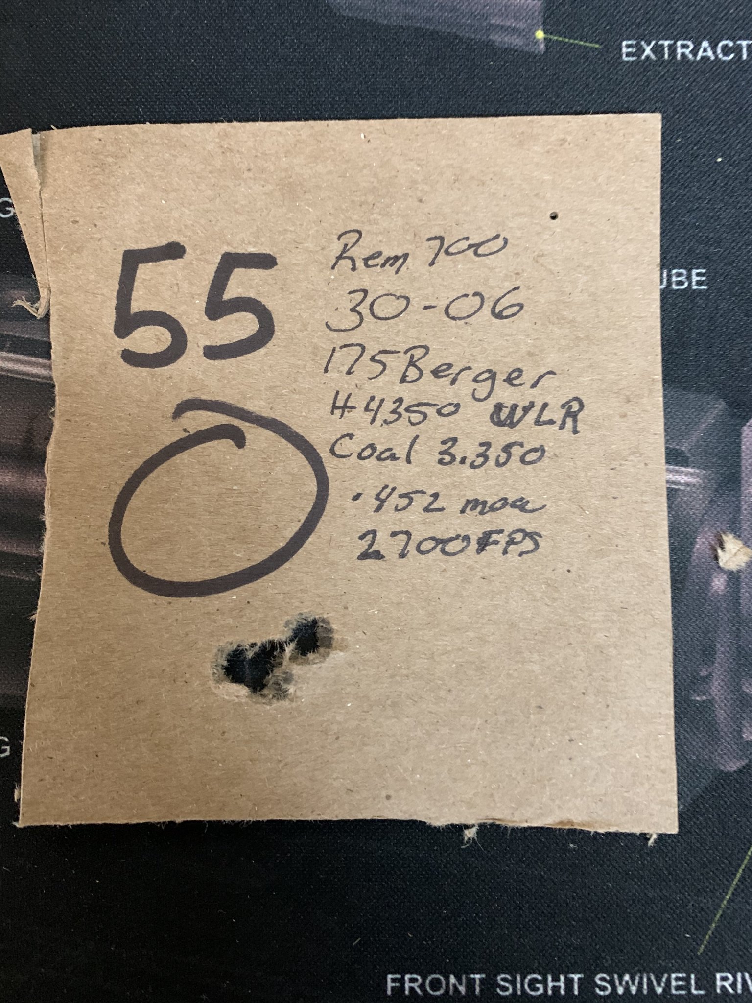

Found a good load for my 30-06 last weekend.
Remington 700 bdl factory barrel
Grayboe stock
Trigger tech
Load data.
Winchester brass, Winchester large mag primers
175 Berger hunter
55gr h4350
Coal 3.350

Accuracy: Not thoroughly tested yet, today was my first chance to work on this load so I main was doing a ladder test and chrono work at the higher end of the loads, but the last chrono string had 5 shots at just a cunt hair over 1 MOA at 200 yards and three of those at about .75 MOA. Going to play with seating depth next to see what this load can really do.
No pressure signs, good smooth bolt lift, primers look good and no brass flow into the ejector or extractor. (edit - it was fairly cool today so I will have to re check this load when summer rolls around again.)
