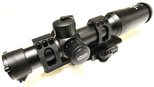

Meopta ZD
I shoot the Meopta ZD 1-4 on my BO. It has a uncluttered horizontal line w/ a dot and 3 chevrons below the line.
It works well for target shooting with supers and subs out to 300 yds.....I plan to hunt with it this year.
