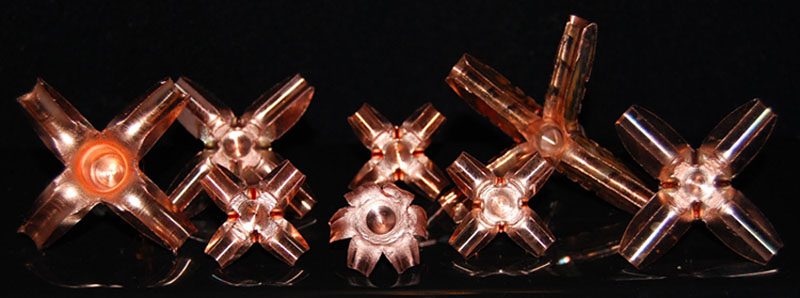

I like it. I was skeptical at first but after playing around with it, it really grew on me. I only shoot supersonic. For plinking I'm using 125 gr SMK's loaded with 18.2 gr W296, moving around 2100 fps at the muzzle out of an 11.4" barrel. For other than plinking, I'm using 110 gr Barnes Tac-Tx with 19.2 gr W296, moving around 2300 fps at the muzzle. If you decide to go subsonic, Lehigh Defense makes an awesome Controlled Fracturing bullet that has crazy expansion at subsonic velocities. One of the nice things about this cartridge is that its designed to completely burn its powder at 9" so its perfect for shorter barrels.
https://www.lehighdefense.com/index.php/shop/ammunition/maximum-expansion
