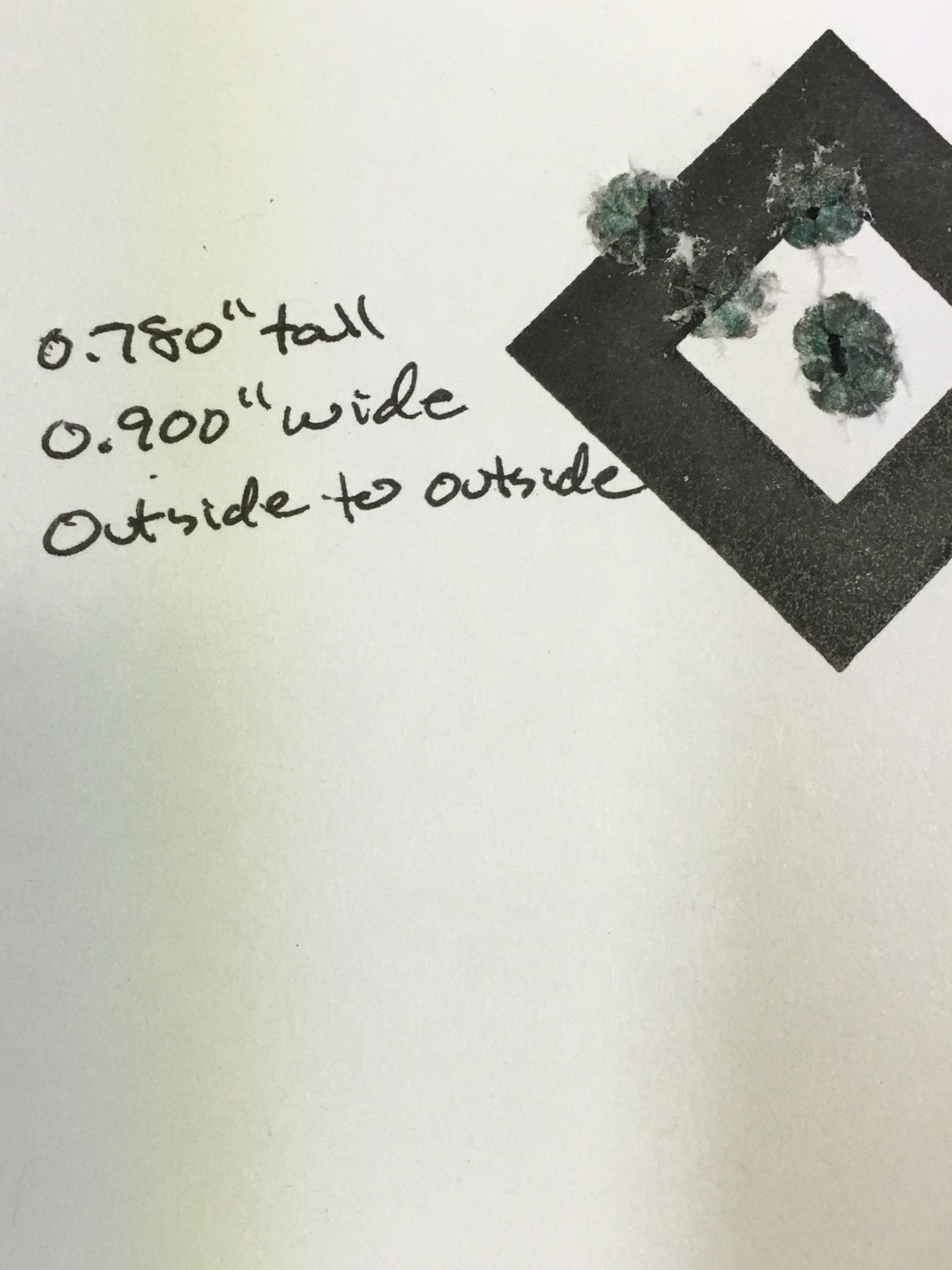

I went .308 route. Have a 16.5" barrel on my Mausingfield. Just getting around to testing it out, have about 70 rounds loaded up with 10.0gr. of Trailboss. For me it was a mix of both knowing I can gas up to full .308 power and not wanting to deal with .223 class cartridges in a normal short action (especially w/the mauser claw). I'm sure many can get it to work but I'm lazy like that.
Initial results showed about 43fps ES, but I had similar spreads in a .300 B/O bolt gun (Ruger American). Putting a crimp on the 300 B/O tightened spreads into the teens, and tomorrow I'll see if the same holds true for the .308 subs w/trailboss. I will agree, it's fun for a bit then you hit the walls of the limitations of the low MV very quickly. There's also the pain of rezeroing between subs & supers. The subs impact about 4.5 mils low @ 100yd compared to the supersonic stuff.
Not the end of the world, but the limitations are greater. FWIW, Hornady 4dof seems to excel with subs over other ballistic calculators. I shot some 178gr HPBT's a while back subsonic. Zeroed at 50yd and went straight to 300yd with a 1st round hit on a 6" plate. I was extremely impressed, 2-3 other calculators had me up to 2 mils off.

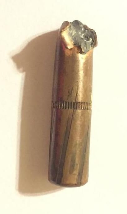

For headshots it doesnt matter, just dont miss that brain because its the only thing going.
For body shots- I wouldn't- but if you are you want something to expand so I would go with the higher priced lehigh and makers bullets that are all copper to machined to expand easy.
This is a 220 sierra pro hunter at 1040 fps, it went into the front base of the does neck and traveled all the way through the back strap and stopped right where the muscle pinches out on the hips. It basically just took the soft lead off the top, Im assuming where it skipped off the neck bone, and kept on trucking.
