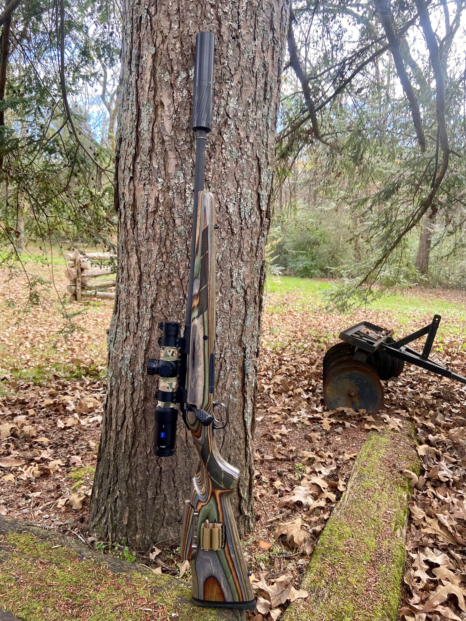

I have a couple other Ruger American rifles (223 and 308), and just recently added a 300 BLK. I have only shot supersonic factory loads through it so far. I like the rifle, but will add a MagPul stock when thay come available.
My 300BLK rifle,
This is the stock I'm going to add later, I think it will be a nice upgrade.

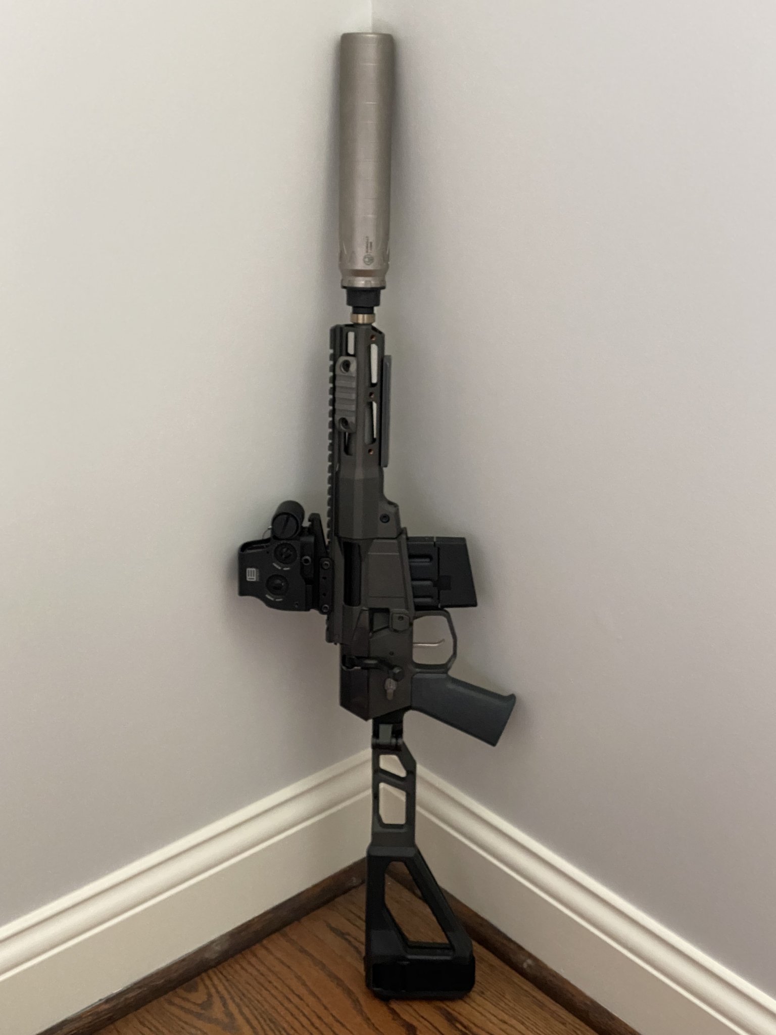

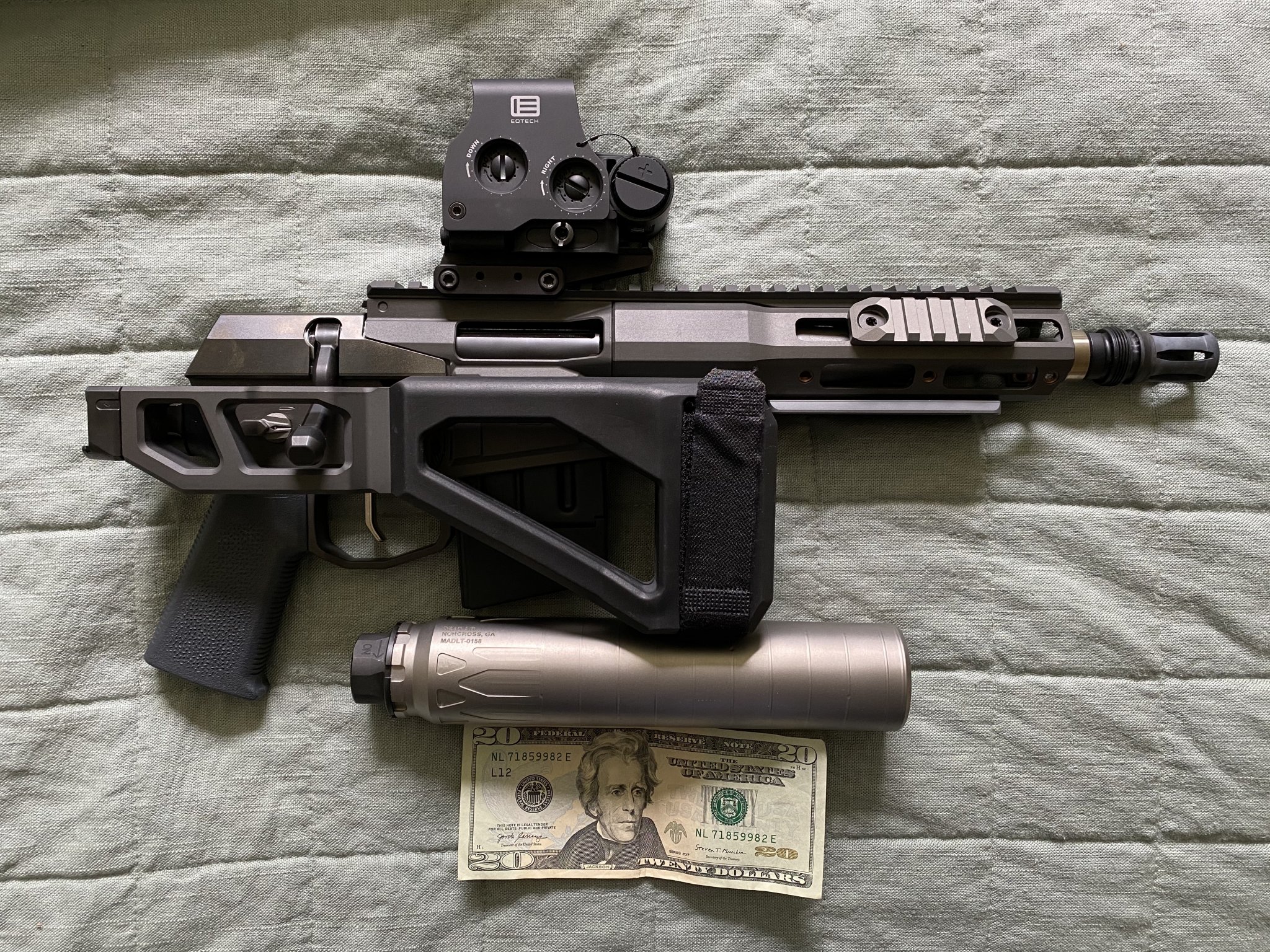

I had some frustrations getting my Q Mini Fix to ignite harder primers at first. After sending it back and bumping my shoulder a more reasonable distance it is now 100% with CCI 450s.
Now that it is sorted, I feel it is a well thought out gun for it’s application. The machining is impressive, the brace folding mechanism locks up tight, and the action is very slick. The Mini Fix with a Nomad LT suppressor has literally been mistaken for a pellet gun shooting 150 gr soft points loaded with Titegroup. Barnes 110 Tac TX bullets would make a great deer gun in a blind or to stick in a backpack for climbing into a tree stand.
It seems kind of expensive until you handle and shoot it. I think you would spend as much or more piecing something together and it would likely end up larger and heavier.
Not a Q fanboy but have to give props to Q for an interesting and well designed gun. It is a great gun to shoot with friends and family socially on the back porch, no ear pro required!

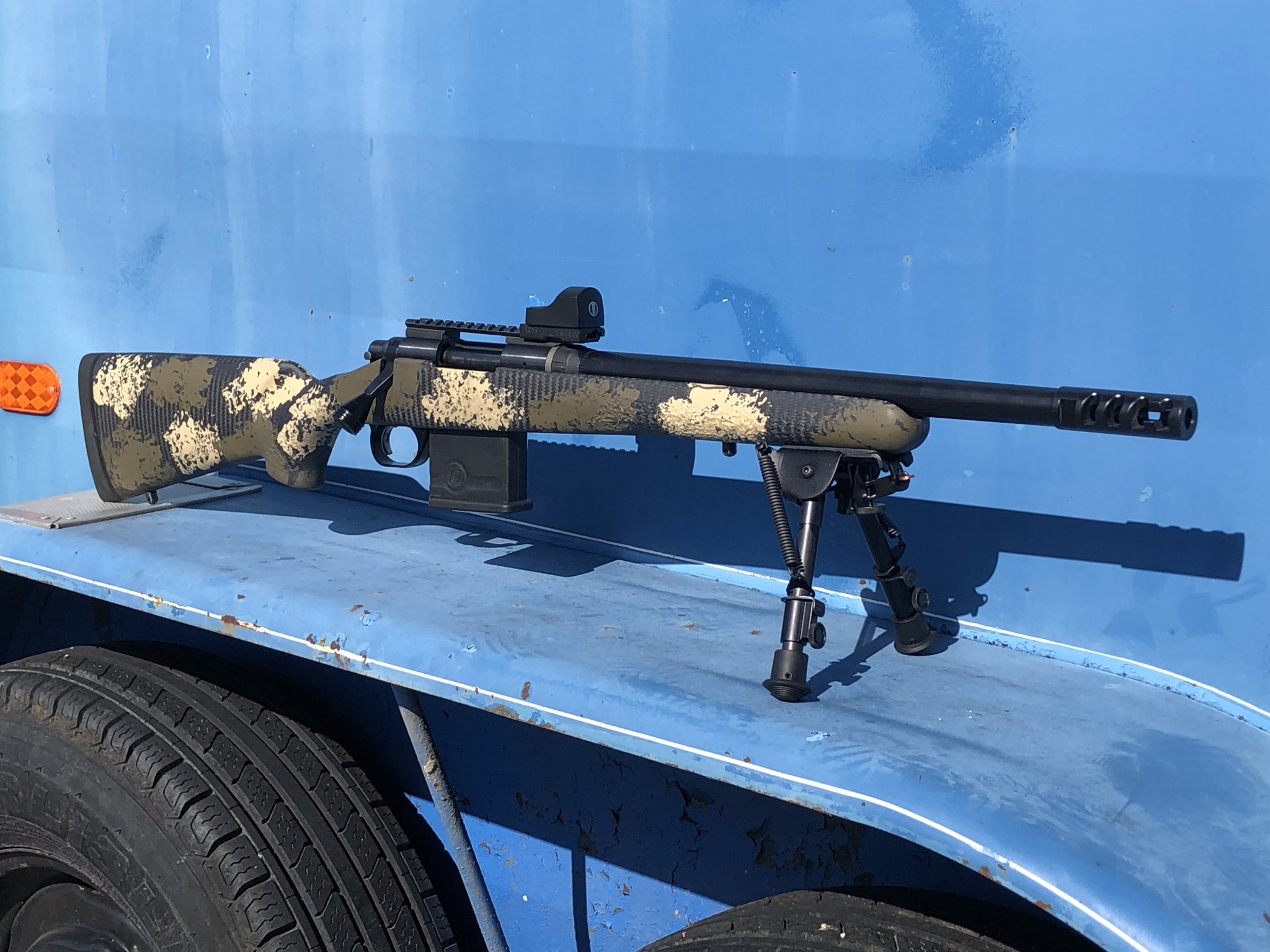

I really like my Ruger. My 300 BO Ranch shoot 220 gr subsonic hand loads decenlty, around 1 - 1.5 moa. It might do better but if have played with the heavy hand loads much. It loves the factory 110 Hornady V-Max loads.
Mine is one of the older models that uses the Ruger 5 shot mag. The stock is just so so, but it is better then the original Axis stock. I think the Ruger is a better rifle then the Axis, but the Axis probably has more after market support.

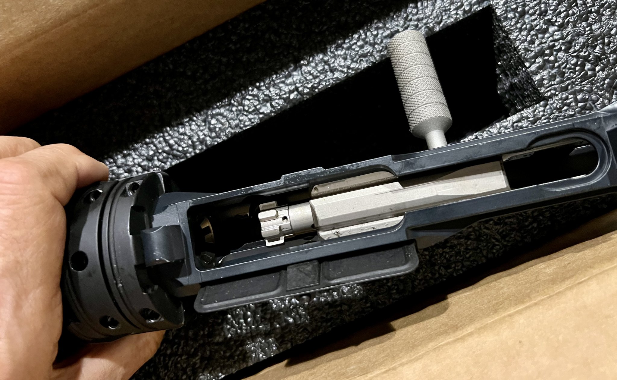

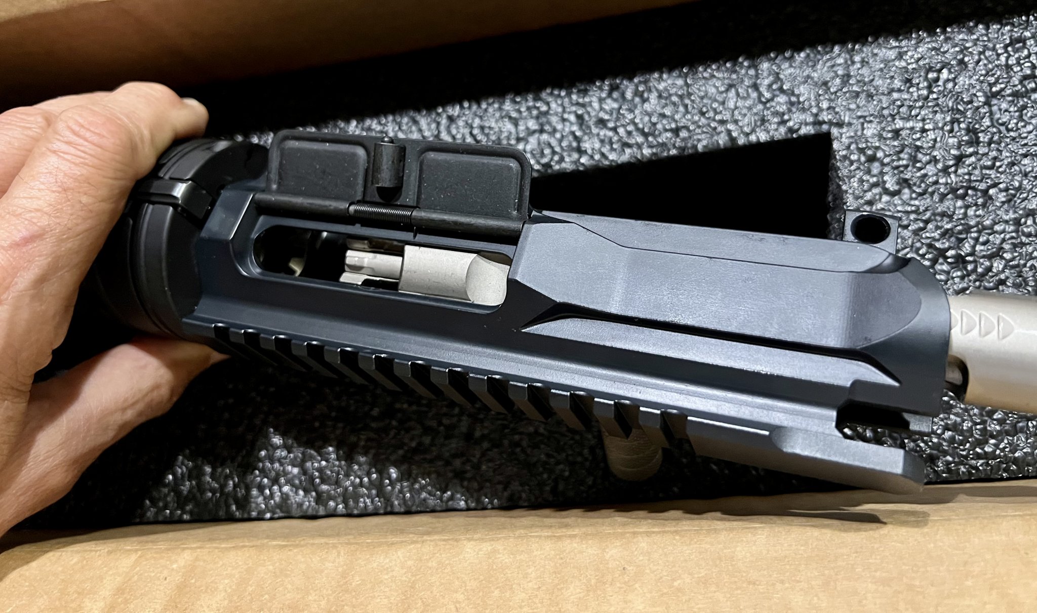

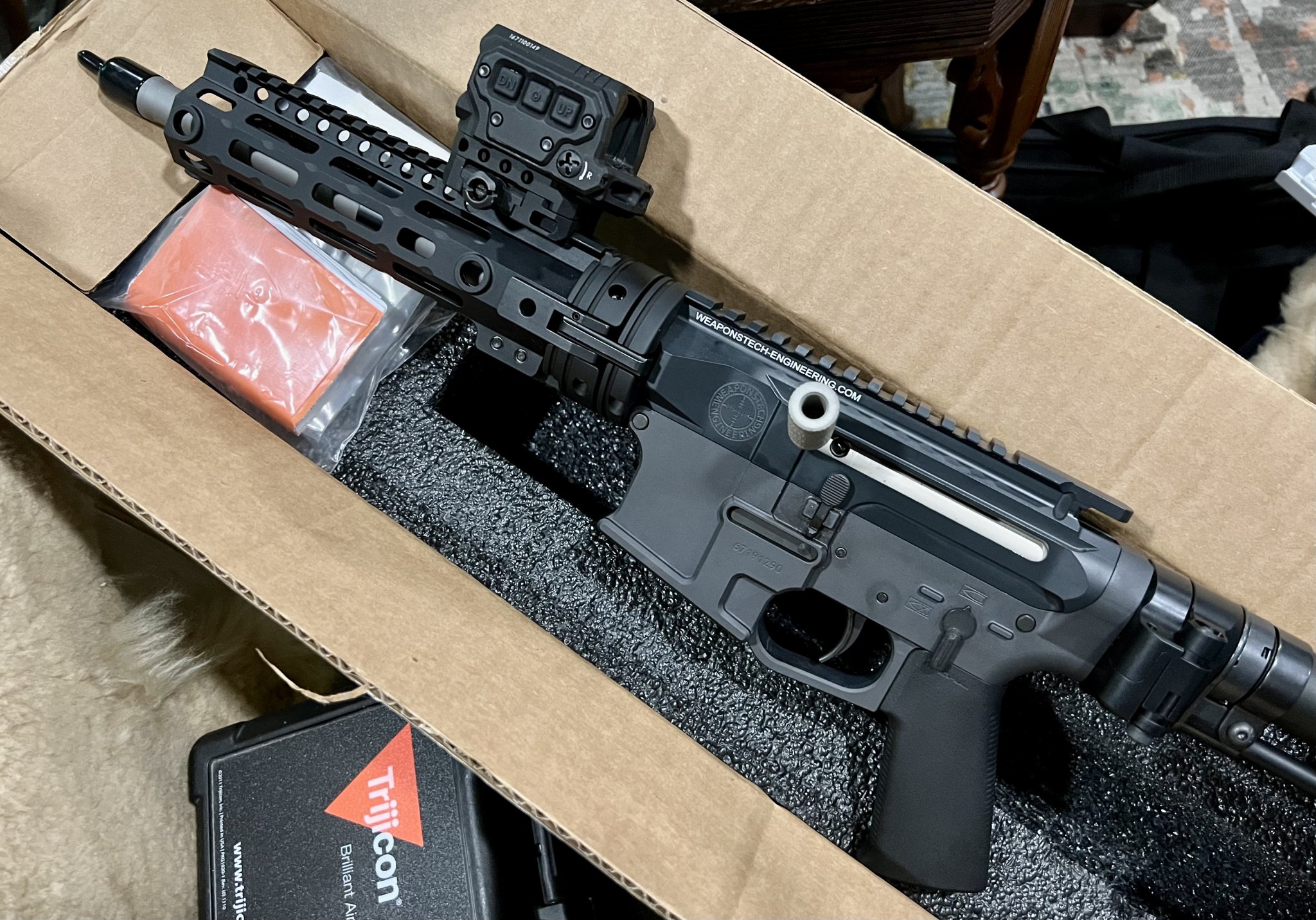

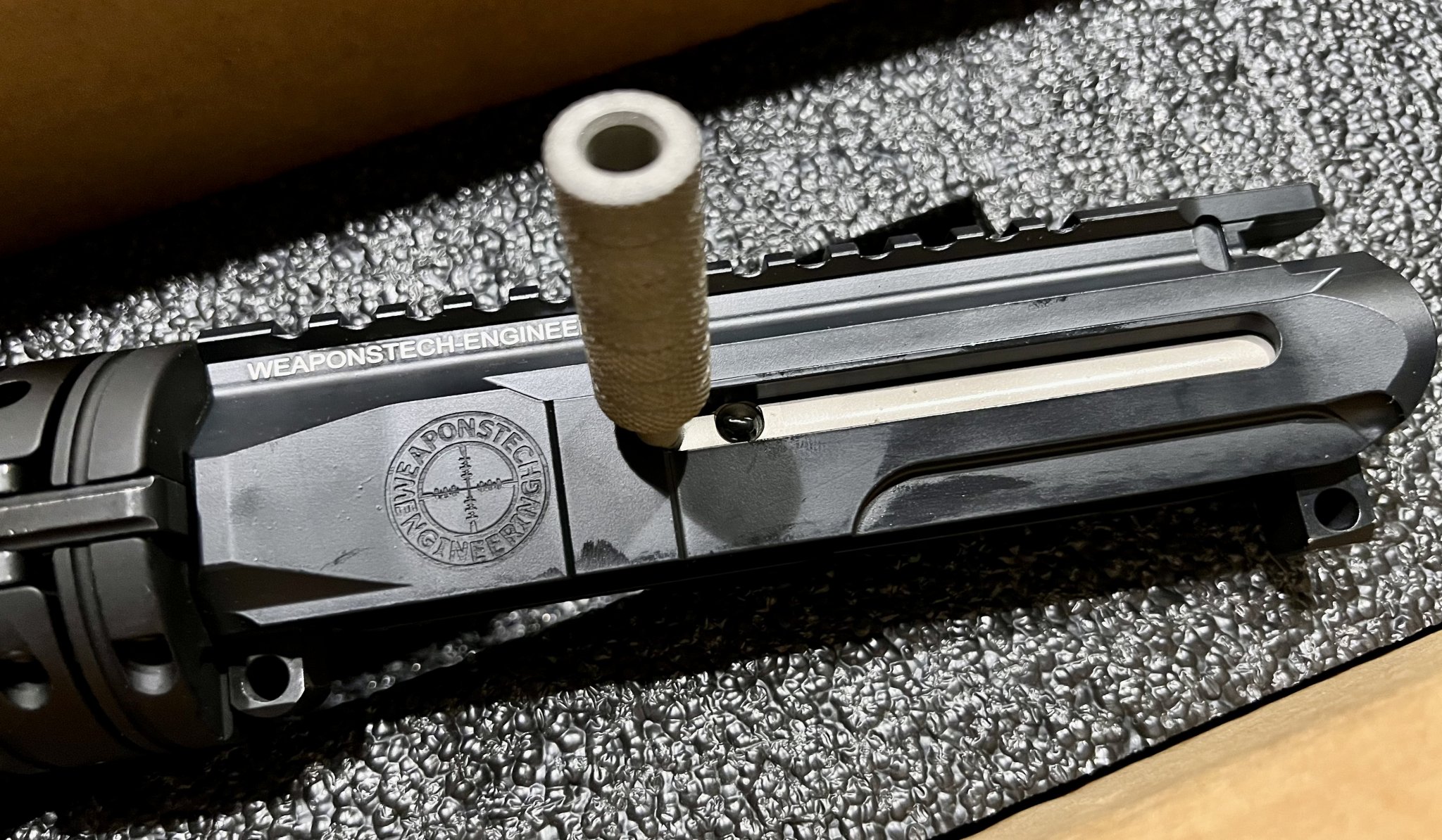

Hybrid bolt-gun in .300BO….extremely quite and accurate…straight-pull AR

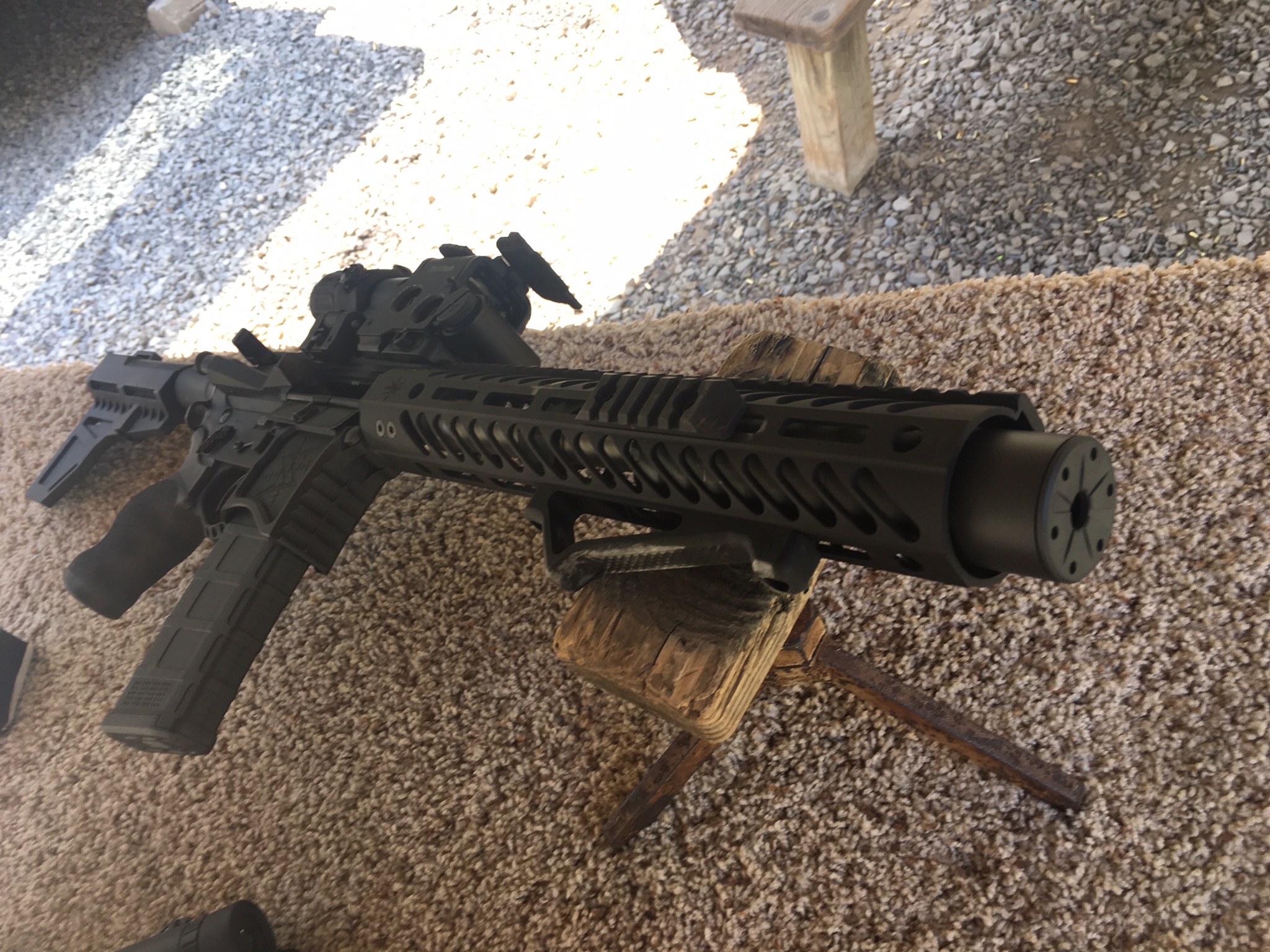

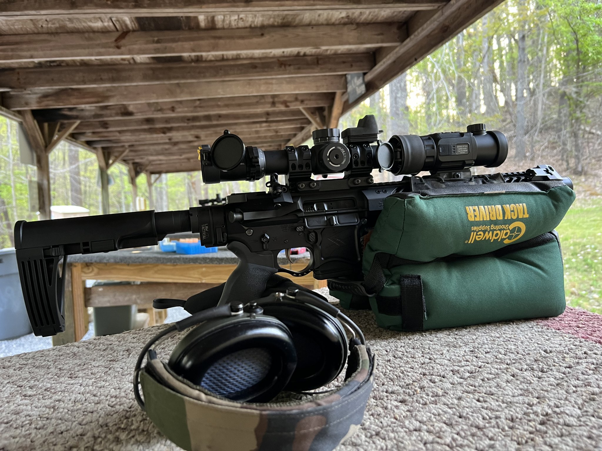

You gotta find the right combo....I had 3 buddies with 300blk that echo the same exact thing you posted a few years ago. Subs were Fun, quiet but not accurste
I took the challenge and set out to see if I could get submoa accuracy from 300blk....I gotta say, I ALMOST gave in and...went through 3 barrels till I decided to test 1 last barrel....Rainier ultramatch 10.5" (shilen blank)... man what a difference. Night and day.....I have now tested there gen1 and gen2 300blk barrels and they both hammer out tiny little groups
Here's 125TMK H110 supers that I shoot out to 500M with 100% consistency on steel...
125 SMK first rounds down barrel
125 TMK final load confirmation.. not a bad 7x5 for a 10.5" 300blk
And here's 220 SMK CFE Black subs that shoot LIGHTS OUT and stupid quiet...no shit, had this old lady at the range last week ask me if I was shooting a nail gun. Hahaha. Rugged surge 7.62 on the gun...

Even more of a reason to look at a Q Mini Fix! If you cannot have an AR pistol, the Mini Fix pistol might still be legal in your state. It is quieter than an AR pistol by a fair margin as well. It packs down nice and small, bill included for frame of reference... not the amount to purchase!
