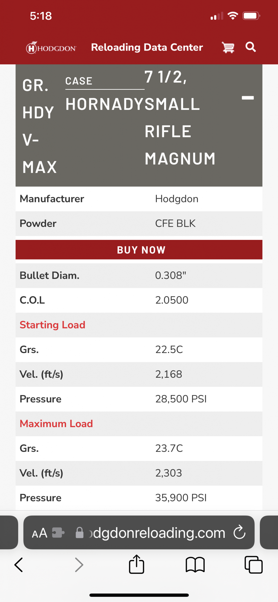

I am loading .300 Blackout for the first time using the Hodgdon recipe above. Brass is starline and measures correct. I chose 23.1gr of cfe blk. I am ising a Hornady die set. The bullet seating feels really tight. I measured the diameter of the neck spacer in the full length die as .307 so I’m guessing it’s a little tight. The load says the powder charge is compressed even at the starting load and I can see why. I am getting the bullet seated to a COL of 2.06. I’m afraid to push them in any harder because it’s already deforming the V-Max. I just checked them in the gun and they seem to feed fine.
Thought? What would you do?

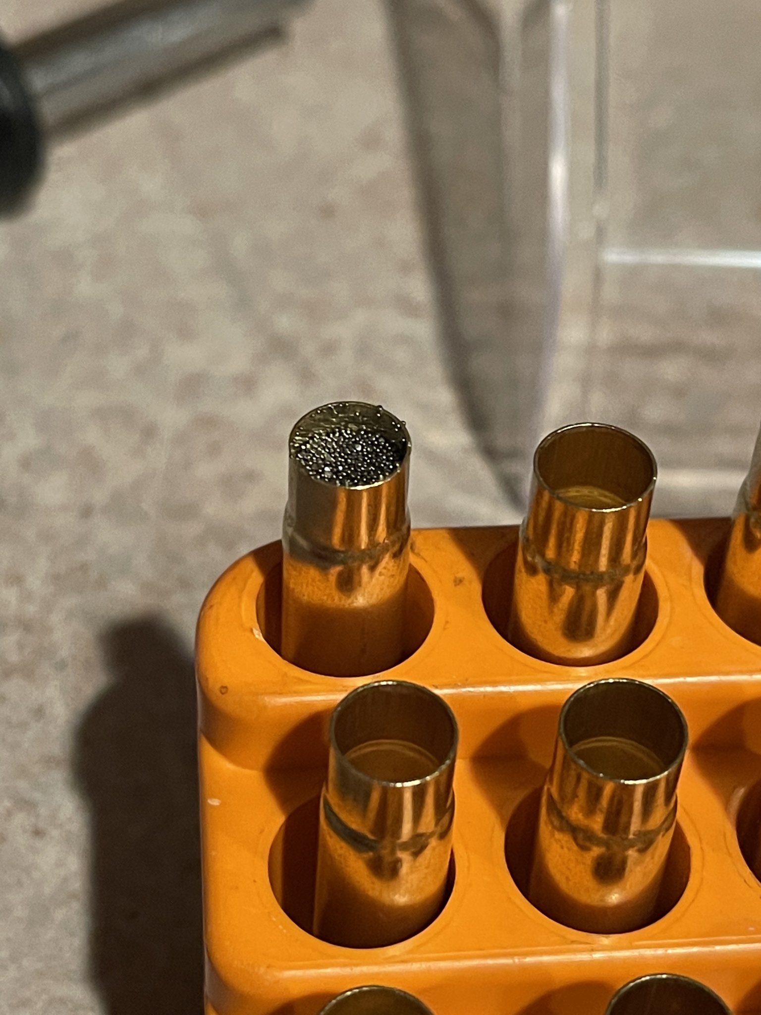

I’ve gotten the full 22.7gr of CFE BLK into a Hornady case using a drop tube. It will not be that easy seating the Vmax at that charge weight. Some seating diess are better than others at not deforming the bullet. Slight tangent; I do recommend using the Redding taper crimp dye. I’ve had excellent success with it.
One thing you may be running up against with the .300BLK starline brass is that their 223 Remington brass is notorious for being thick walled with less case capacity than Lapua and LC. brass. I’m willing to hazard a guess that the initial forming steps for both of the calibers is very similar.
Nonetheless if your ultimate goal is a higher velocity supersonic round I will concur that H110 or W269 is the preferred powder. My best CFE BLK load was 200 ft./s slower than my H110 load. CFE BLK did have exceptional accuracy though worth the 110 Vmax.

What made you choose to start at the higher end of the spectrum? If you are compressing and it’s leading to progressively longer seating depths then I’d either stop putting powder in and make sure it’s not too hot or I would seat longer so they are all at least the same depth.
I certainly wouldn’t continue to try and put that much powder in a case that short and expect the soft copper not deform as there isn’t space for it.

I’m right in the middle of the load data. Everything I read suggested that more compression is better with this powder from an accuracy standpoint. It woukd be hard to raise pressures to dangerous levels with this powder. I could drop .5gr powder to lower the load to the minimum but I doubt it would then not deform the bullets. I’m getting the 2.05 COL now. I just need to figure out if a different seating stem would fit the bullets better.

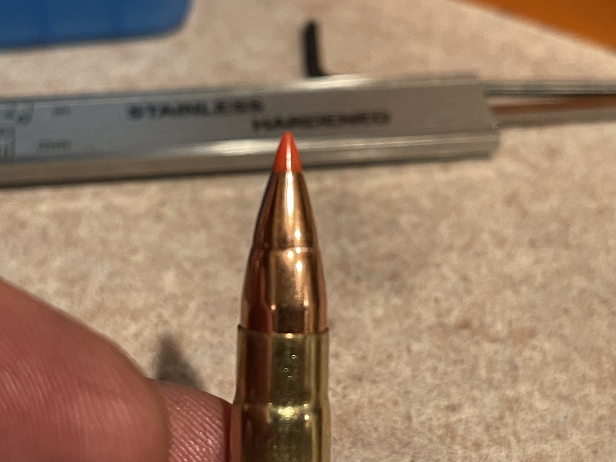

A slight ring around the tip of a Vmax bullet is not completely uncommon. What brands of dies are you using? I’m assuming Hornady.
Reactions: mdmountainman

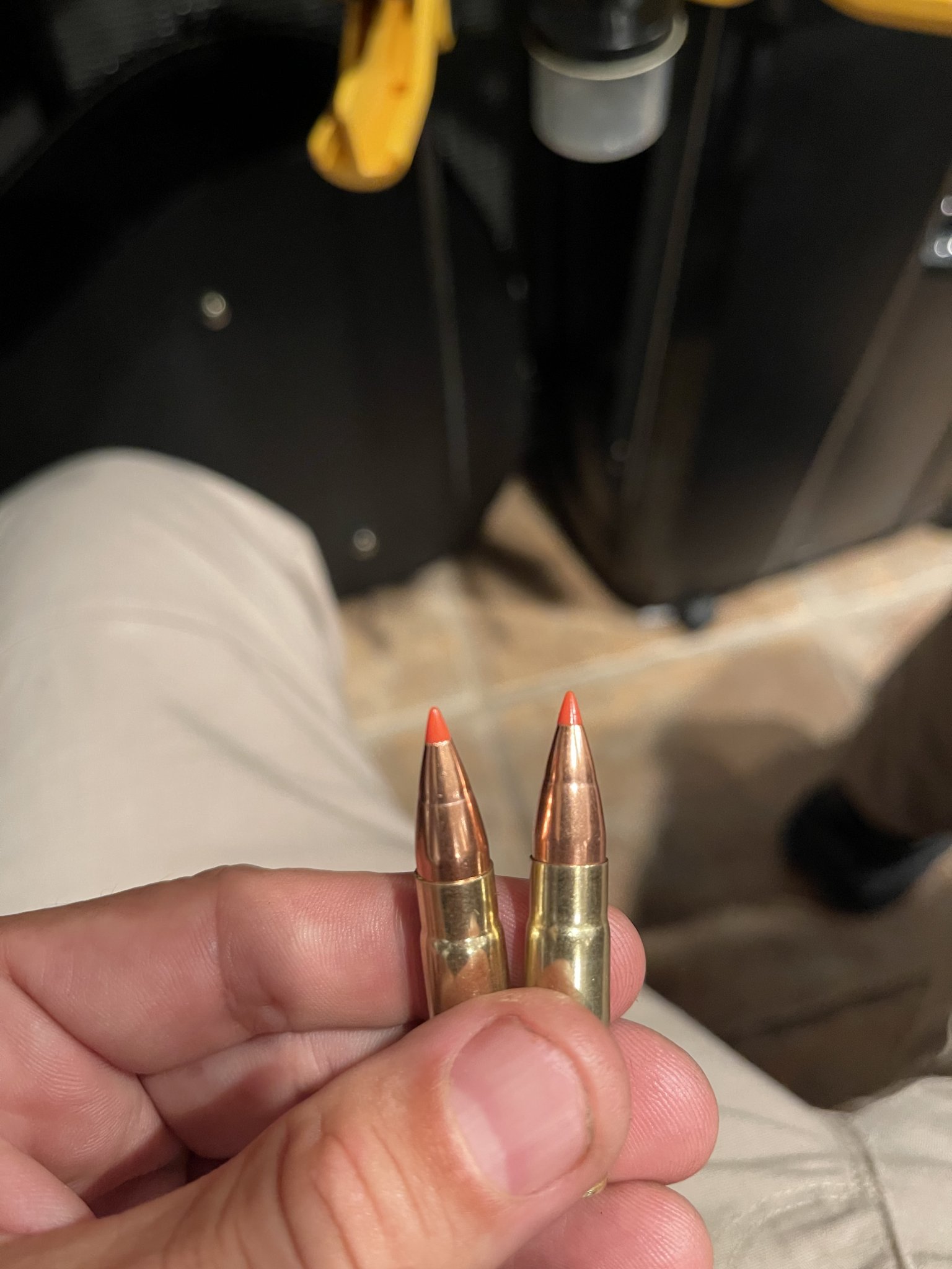

Yes. Hornady dies. I switched to the second included seating stem. 1 is maybe a little better but they’re ringed pretty bad. I might call Hornady Monday. Their dies doing that to their bullets?
Reactions: bunsen27
View attachment 7894213Yes. Hornady dies. I switched to the second included seating stem. 1 is maybe a little better but they’re ringed pretty bad. I might call Hornady Monday. Their dies doing that to their bullets?
Yeah that is pretty bad and definitely due to the compressed load. I would either back the charge weight off, or try to utilize in the drop tube to get a better powder stack height. Although CFE black is a really small fine grain powder to begin with, so it may not improve any.
I have a nice area 419 funnel I’m using and I tap them down when filling to get it to settle. I can try a couple with less powder but I can’t imagine .5 gr less would stop the bullet from marring. I’ll find out! As someone said above, maybe the case capacity of this brass is lower causing it to be more full???? I wish I could go out back and chrono each bullet as I load them instead of having to drive far to get to a range. ☹️

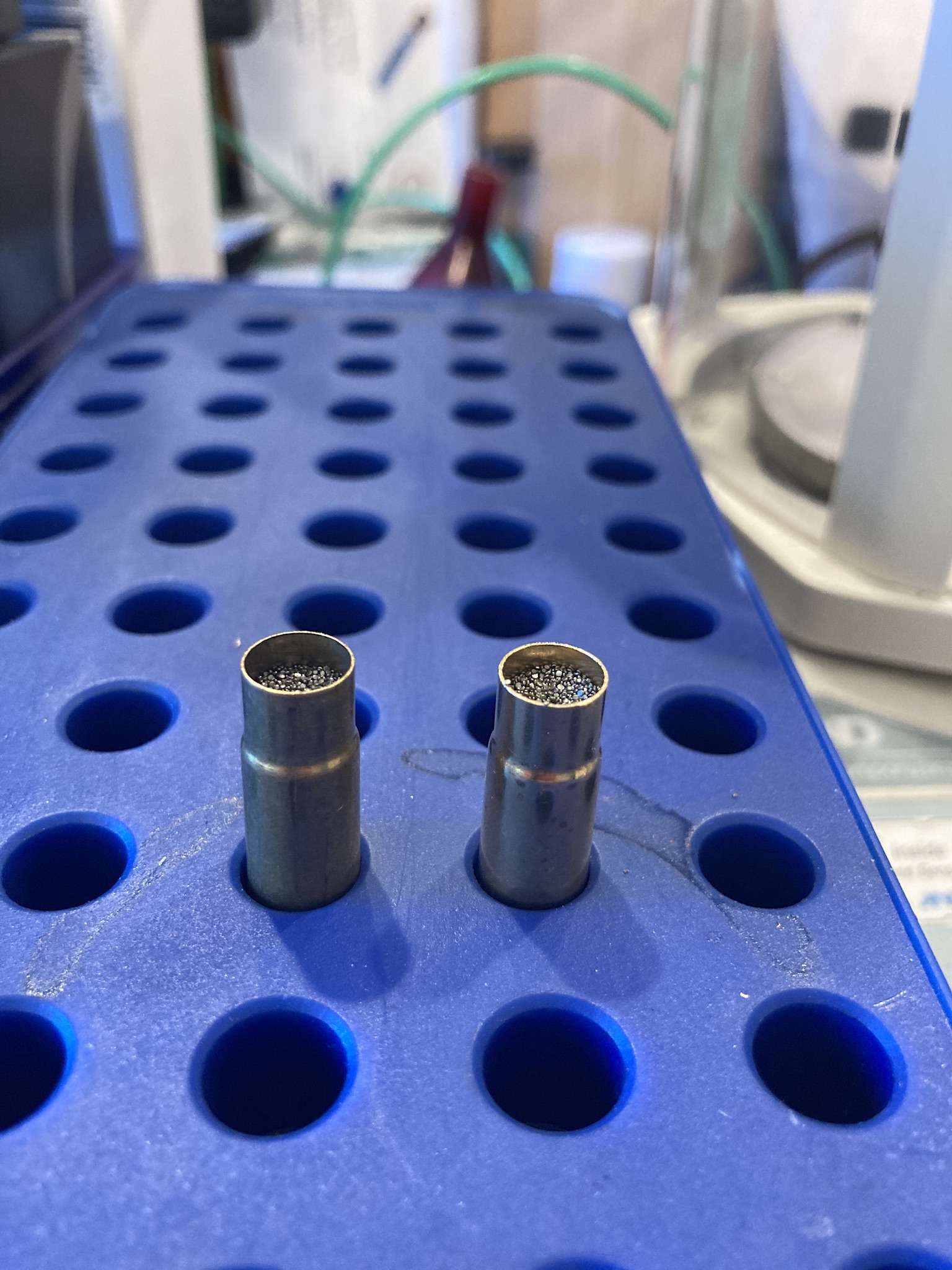

So the case volume being lower was my guess, and it may be correct based on the quick experiment I just tried.
23.3 grains in each case using the drop tube on the area 419 powder funnel. Hornady brass on the left virgin Starline on the right.

Clarification: I am not loading 22.3gr of H110; nor do I recommend anyone else do it.
H110 is a similar kernal size to CFE BLK and it's what I has easily accessible to investigate/demonstrate powder stack height in Hornady vs Starline brass. I've edited the previous post to avoid some potential dumb-dumb having a ka-boom. :cool:

I might try this. Maybe my stems have some sharp machining edges.
Reactions: bunsen27
I knew going in that I might be giving up 2-250fps with the cfe black vs. h110 but I already have 8# of the cfe blk. When I talked to Hodgdon the guy thought the velocity spread would be on the smaller side because of the 7” barrel. If I had more length he said the difference between the two powders would be more noticeable. I will probably wnd up grabbing some H110 if Insee it locally. I just don’t want to pay the hazmat and more powder if I can make these work. I’m not going to hunt deer with it.
That said, I chucked one of the V-Max bullets in a hand drill and coated it with 220grit lapping compound and polished the seating stem. The line on the bullet when seated is still there but is MUCH less aggressive. These V-Max are going to be my plinking load on a pistol length weapon so I’m not terribly concerned with absolutely perfect flight as long as they feed and fire.
