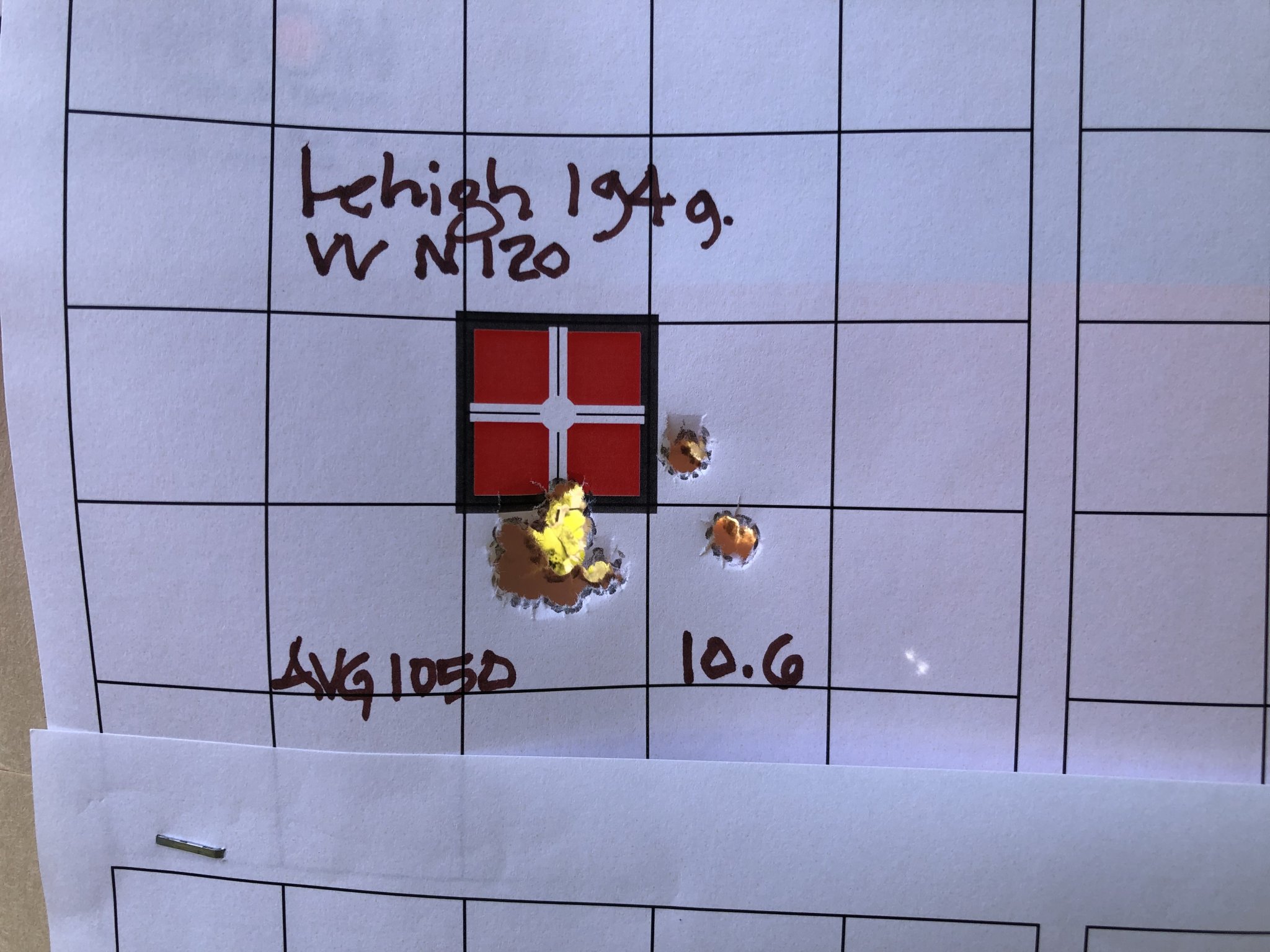

I’ve been running some trials with the Lehigh 194gr ME. Rainier 16” ultramatch barrel, 1:7.5 twist. Best results from Vihtavuori N120. This is a 10 shot group @ 50yds. 2.20” COAL, CCI 41 primer, 10.6gr VV N120. As a side note 300blktalk.com is a good forum for more granular 300blk info.

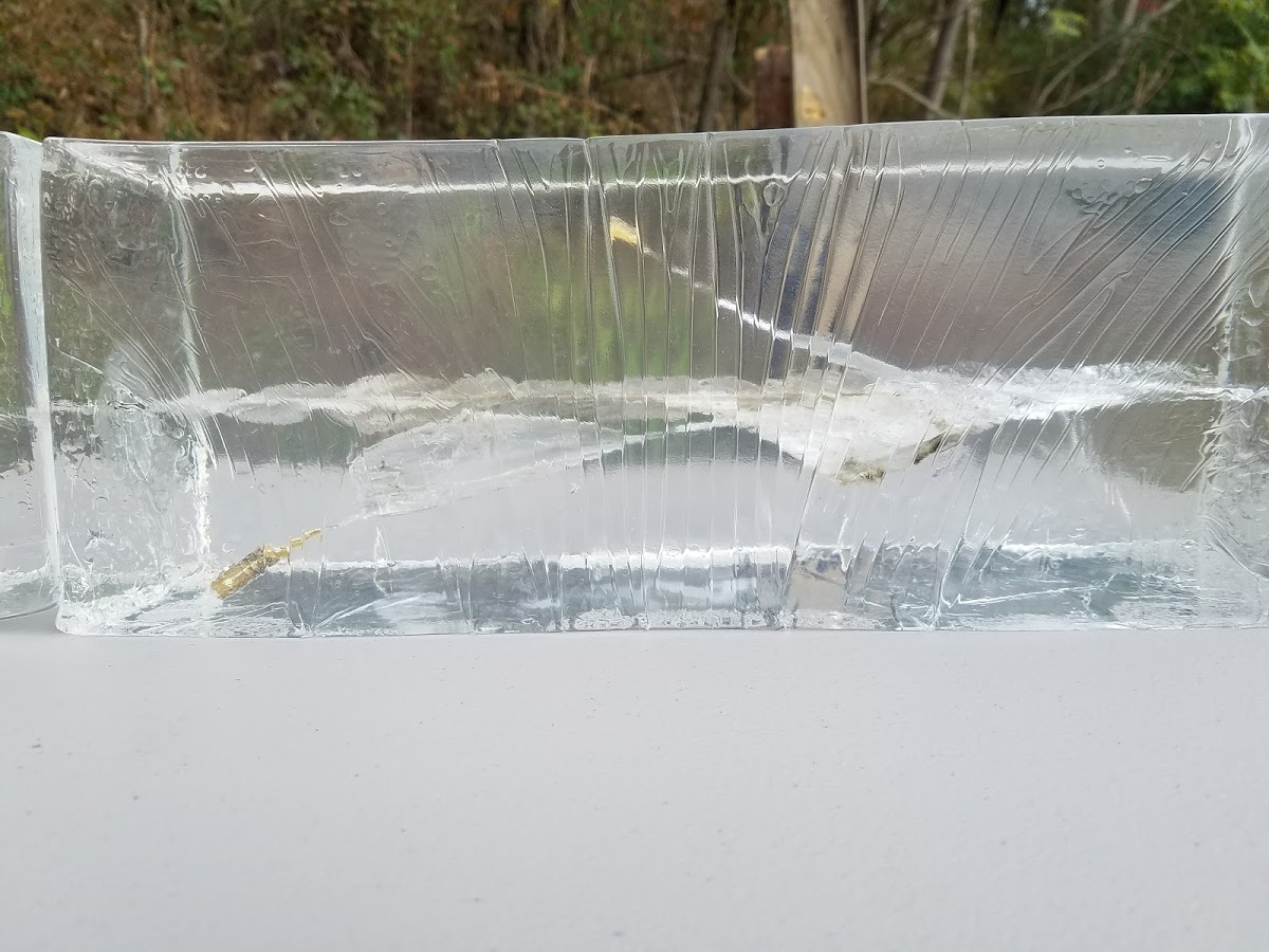

This is a 174CF Lehigh in 10% Clear gel. Pay no attention to the pass through behind the bullet.
What was the velocity and how much penetration?
I think that was around 900 fps. It's a 16" long block, so I'm just guessing at around 14" total penetration. It was completely fractured at
about 4-5".
It's been a bit since I did that test. I'll see if I can find the actual data.
