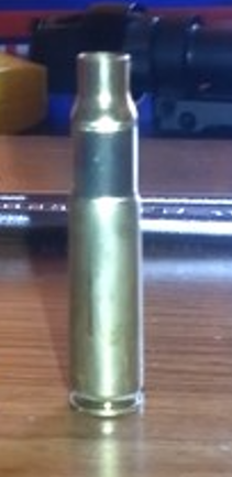

Hello everyone! This is the first time I am am attempting to make 300 BLK brass. When I have gotten to the step of sizing it I am getting this weird outboard horn looking shape on the top brim. I can not put it into the comparator to see if the sizing worked. My theory is something in the Hornady custom die set is hitting the top of the brass. Nothing is unusual when I pull the lever, it is a smooth in and out. Remember the brass is perfect up u till I resizing it. I’ve never seen this on any of my match ammo I’ve realized in the past 12 years. Any thoughts here? Thanks in advance!

Have you checked the OAL of the brass to confirm it's in spec? Looks like the brass is bottoming out inside the die possibly and causing it to swell out.....or maybe the die is set to low. That's where I'd start looking....

You’re forming the BO brass with a sizing die. The flare you see at the case mouth is a byproduct of case forming. Get a dedicated forming die and use the sizing die to size.
....I would agree with this analysis, check to make sure your trim length is between 1.348 -1.368". If you look at the attached image of the Hornady Custom die cut-away, the red line points to the section where your case mouth may be contacting and belling outward. You can do a quick test by backing your die off a turn or two and try sizing a casing to see if the case mouth get belled or not.
