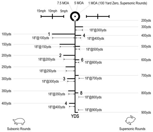

Problem with those reticles is since they use two different loads they depend on you using the load they were designed for, plus they are calibrated for a certain length barrel, usually 16". You can zero one side fairly well, but it'll throw off the other. The wind scale is useless too, because a lighter super will be affected differently than a heavier sub. I guess it depends on how accurate you wanna be too.
Is that a Leupold reticle? The ACOG reticle, and I have the book right here, only goes to 100m for subs. The stadia goes farther for supers, but the subs won't line up. Even then it's calibrated for a 16"bbl., 115gr. supers and 220gr. subs.
I use 125's and 135's for supers and 220's for subs in 8.5" bbl's. If I zero good for the supers, my subs will be off. So it got stuck on a 16" and I have some 115's for it.
I swear based on experience that a mildot just works a lot better. Now if you could have a reticle custom made for your rifle, your rounds, that'd be nice. I was really into these reticles too until I realized all this, and the longer the shot the more noticeable the difference, of course.
FWIW, the ACOG works "okay" because the super scale is what it's based on, only goes to 600 which is about the max. useful range of this round anyway, and likely why the sub scale is only 100m (though it's good for much farther). This limitation reduces tolerances between supers and subs though and helps make the reticle a little more accurate for a dual setup like this. YMMV.
This is the Leupold reticle. I have one a 16" and one on a 9". Haven't shot the 9 yet but on the 16 with 220s and 125s, it is good enough for me. Not accurate enough for groundhogs but good enough for hits on steel out to 300 with subs and 600 plus with supers.

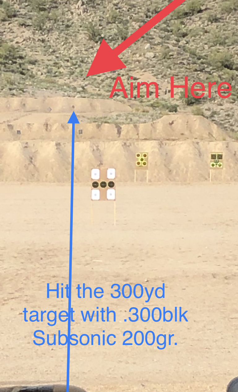

Shooting S&B 200gr out of a 9" Springfield Saint Pistol running Aimpoint PRO with Vortex 3x magnifier. I keep it zero'd at 50yds and just happen to be in a lane that let me send out to 300yd steel. For fun I walked about 5 shots into the target and found a good hold spot for the red dot. It was a lot of fun dropping them in for a ping. Once I found the hold spot, I was hitting steel at about 40% rate. Actual hold spot was just left of the red arrow tip. I snapped the photo to try and remember the drop at 300yd.
I wish people would show pics like this more! That is crazy! I love it!
