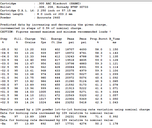

8.1gr of N110 is getting close to the danger zone with a 70% case fill. That's even slightly lower than VV's starting load.
For reference, I'm shooting 200gr bullets with 14gr of TAC - similar load as yours but closer to 97% case fill.
EDIT: here's AA2460
