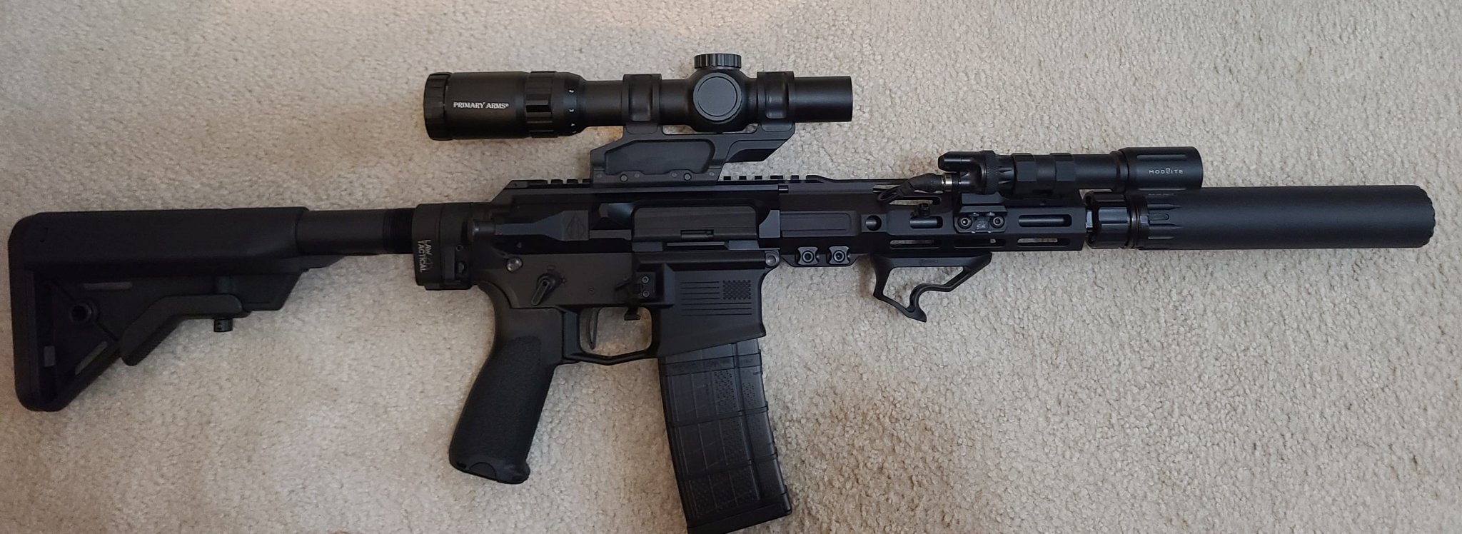

Just finished building my .300blk SBR not too long ago. Built it so that it could serve where needed i.e. HD, truck gun, range toy, etc.
I went with an 8.3" BA Hanson barrel 1:7 twist. Unfortunately when I started my build I wasn't aware of anyone offering a 1:5 twist barrel or else I might've gone that route, some of the videos showing the ballistic performance with the faster twist rate seem promising, MAC on youtube has a video comparing a 1:5 to a 1:7 or 1:8 shooting at watermelons and the difference in energy transfer between the two is huge.
I keep a YHM Resonator R2 mounted on the end via Dead Air Keymo and haven't had any issues with that setup. Decided to try out the Bootleg Inc. adjustable BCG as opposed to an adjustable gas block. Haven't got enough rounds through it to definitively say whether or not it's an advantage but I do like how easy it is to use.
Also went with a side-charging upper to completely eliminate the possibility of gas to the face, am a fan of that choice.

A couple of things stand out to me. I watched the MAC video this morning and didn't catch the different twist rate. There was a substantial difference in the 5 twist. Never thought about a side charging upper to eliminate blowback, interesting. Maybe an 8" barrel with 1:5 twist would be a solid combination. Nice set up. Very close to what I have in mind. Looks like it folds up to a very concealable package. Thanks for the input.

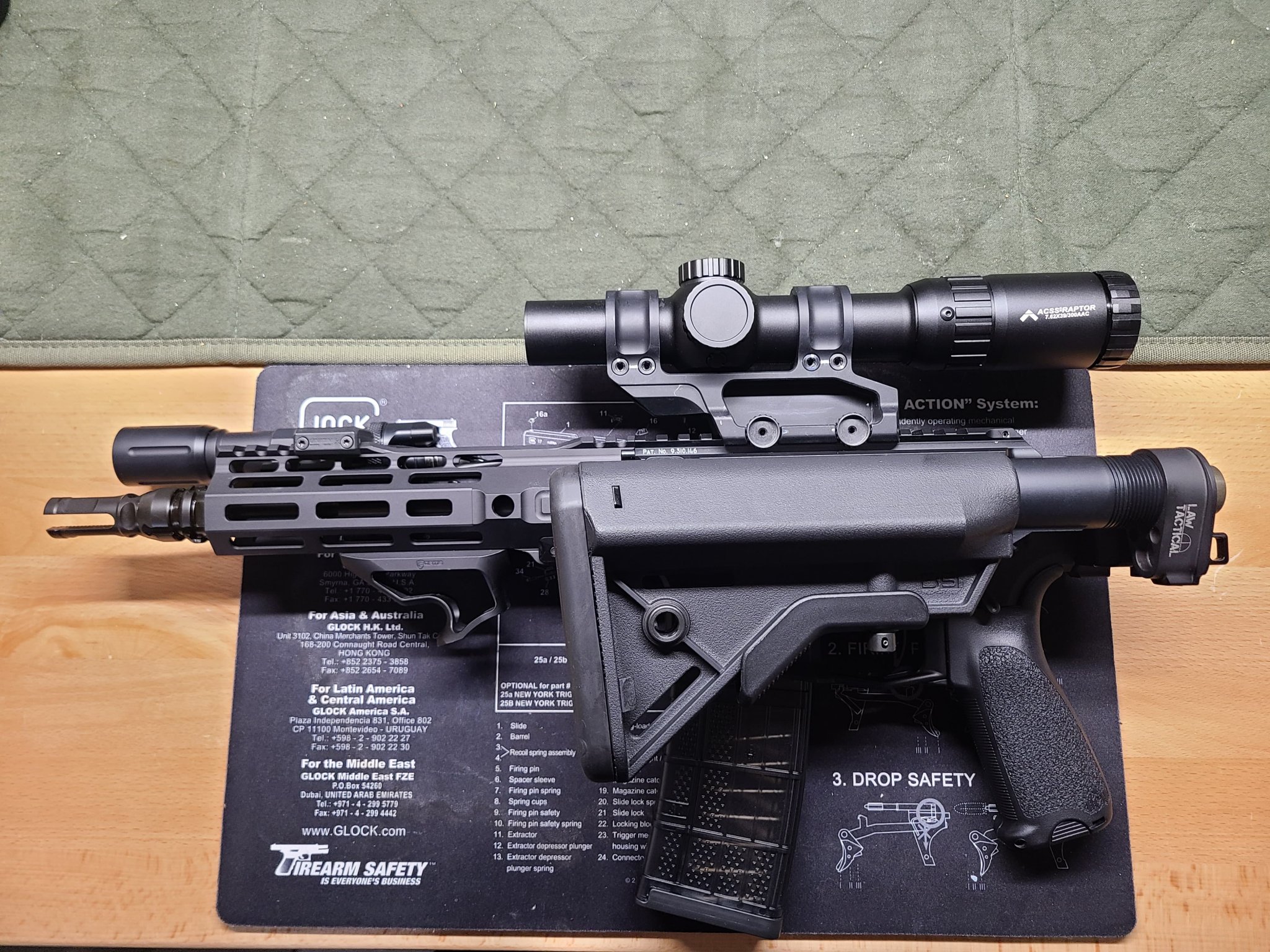

Folds up small enough to fit into my Vertx Gamut or Eberlestock Switchblade. The LAW folder mixed with the side-charging upper made it a little tricky. The stock just barely contacts the charging handle when folded but not so much where I'm concerned about any extra stress or wear being put on either part.

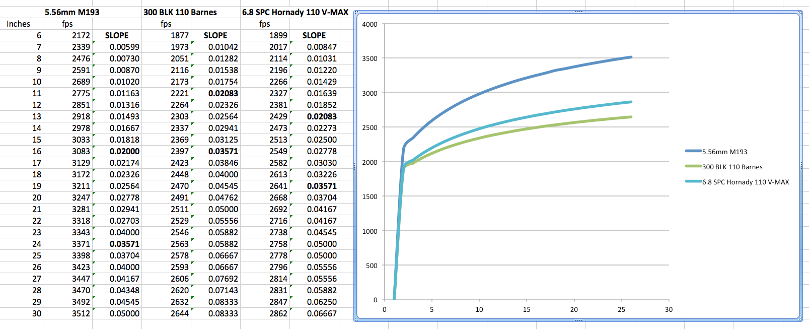

I’ve done 300blk in 6”, 8” and 16”. All are 1:7 twist
The Barnes 110 gr blacktips will give reliable expansion velocity out to a couple hundred yards if I recall out of the 6” 1:7. The minimum expansion velocity for the 110gr Barnes blacktip is down around 1300-1350.
If you want a reliable supersonic trunk/truck gun for 0-200 yards it will work well. Add a folding stock like a previous poster here did and it is uber short.
Mine was 100% reliable with supers with and without a suppressor. Subs were 100% with a can and about 75% without a can. I didn’t try messing with it and sold it to a demanding co-worker who had to have it.
I’ll try to attach a graph of velocities with the Barnes 100gr and different barrel lengths…
