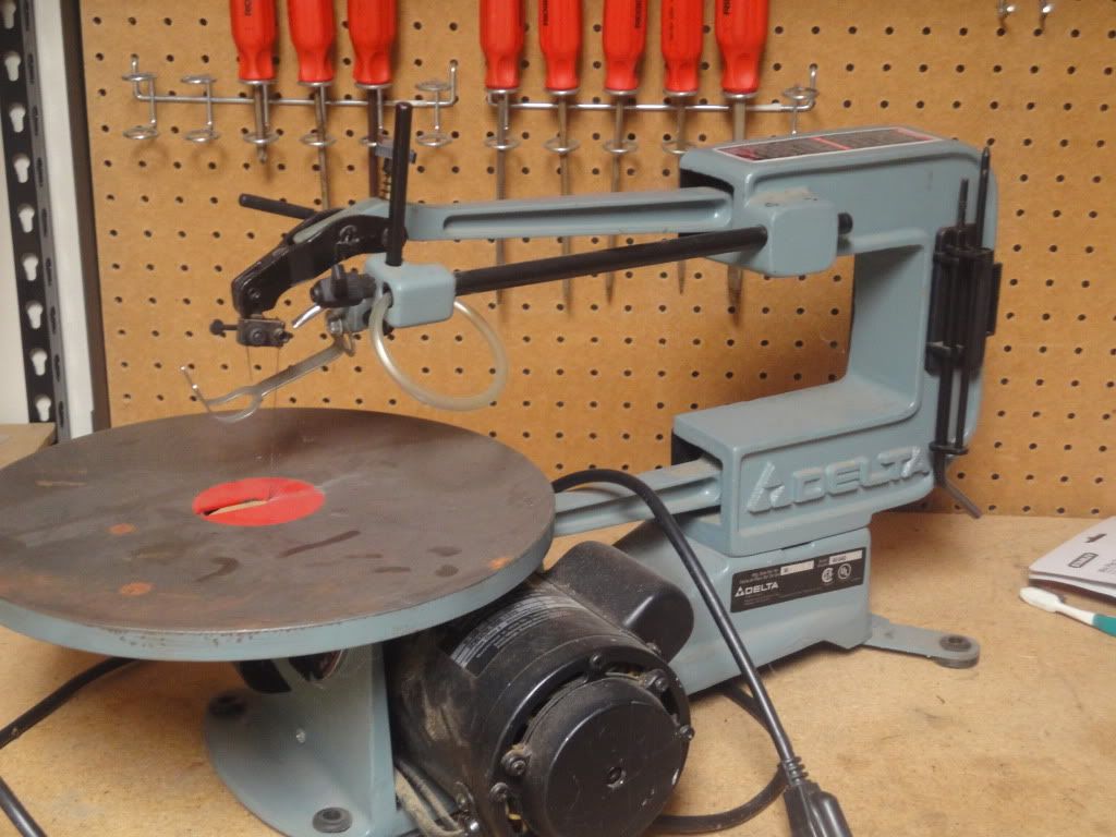

I have been looking on hear and els where for info for the last few days with not much luck.
This is what I have been using to cut my 5.56 bras before any neck sizing is dune. It works some but I keep snapping blades. what are you all using?
Re: 300 fire ball
I use a Dillon 650 withj a universal decapper in the first station. a 300/221 full length die in the 3rd station then the dillon electric case trimmer in the last station. With the case feeder I am starting with once fired 223 brass and end up withsized and trimmed 300/221 brass coming out. as easy as it gets!
