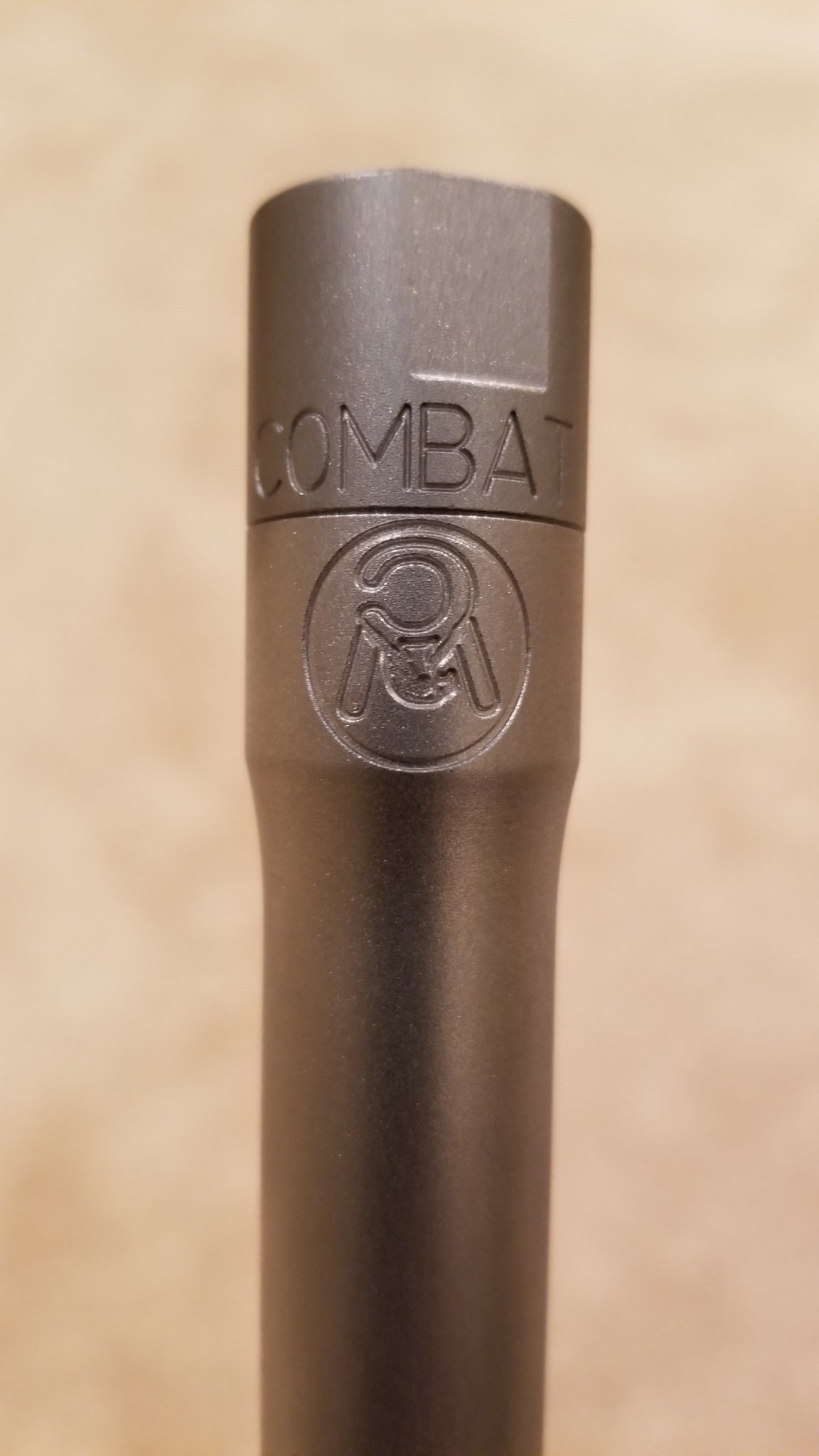

    I just grabbed a set of RCBS dies and a 14.7" 1:13 barrel from WC that just went on sale this week $100 off to run the exact same bullets I run in my 300blk (Sierra 125 TMK and Sierra 125 SMK). The results and data Ive seen from WC have been very interesting but havent seen much from the public on it.. Stay tuned for a full review and testing

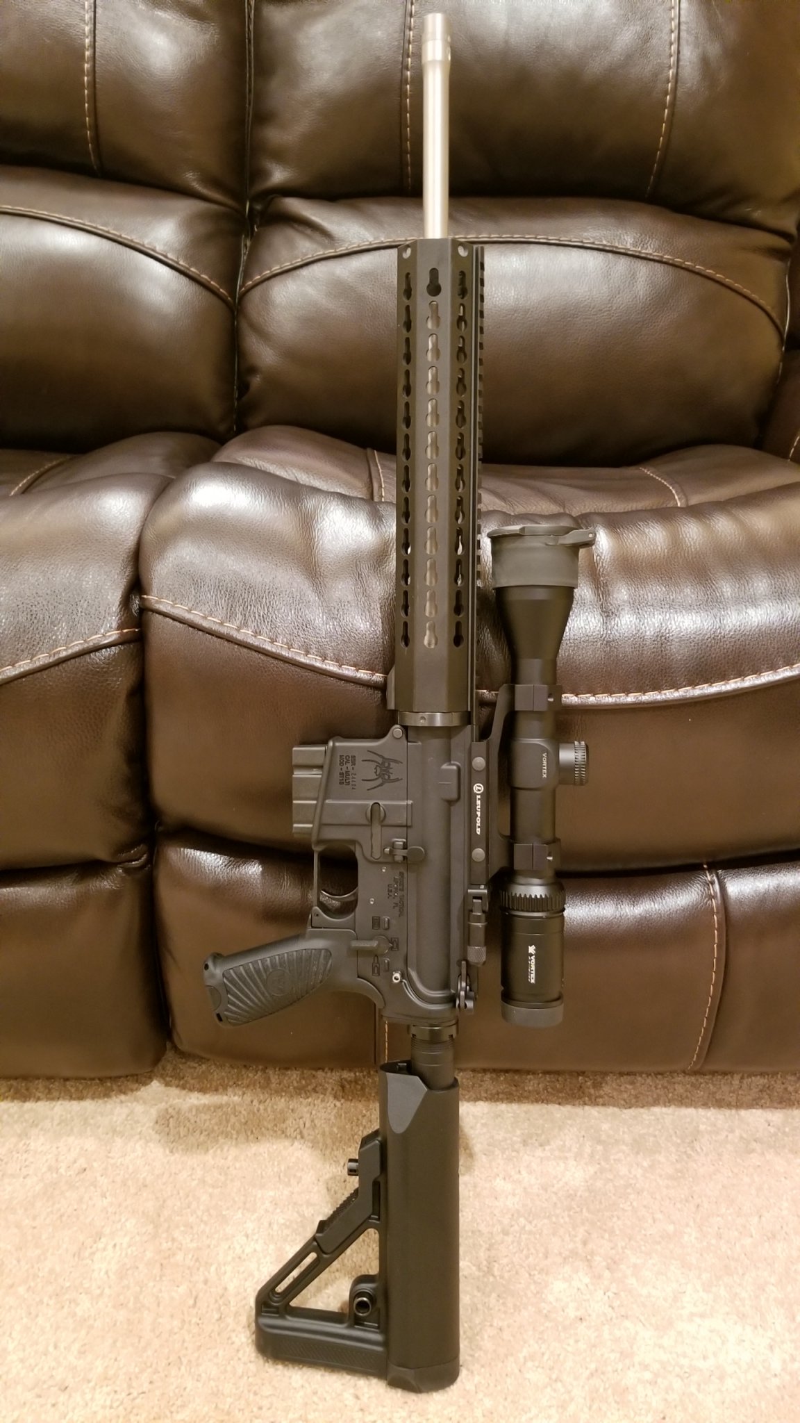

    Wilson shipped my barrel and dies fast. I just finished putting my 300 Ham'R SBR upper together and making some brass.
    14.7" 300 Ham'R Wilson Combat 1:13 SS Barrel
    Mid Length Gas
    Geissele Low-Profile Super Gas Block .750"
    MEGA Billet SBU Upper Receiver
    12" Slim MLOK Handguard
    Rugged Suppressor 3-Port QD Brake
    Toolcraft NiB BCG / Carpenter 158 Bolt
    Rubber City Armory Adjustable Gas Key
    BCM Large Latch Charging Handle

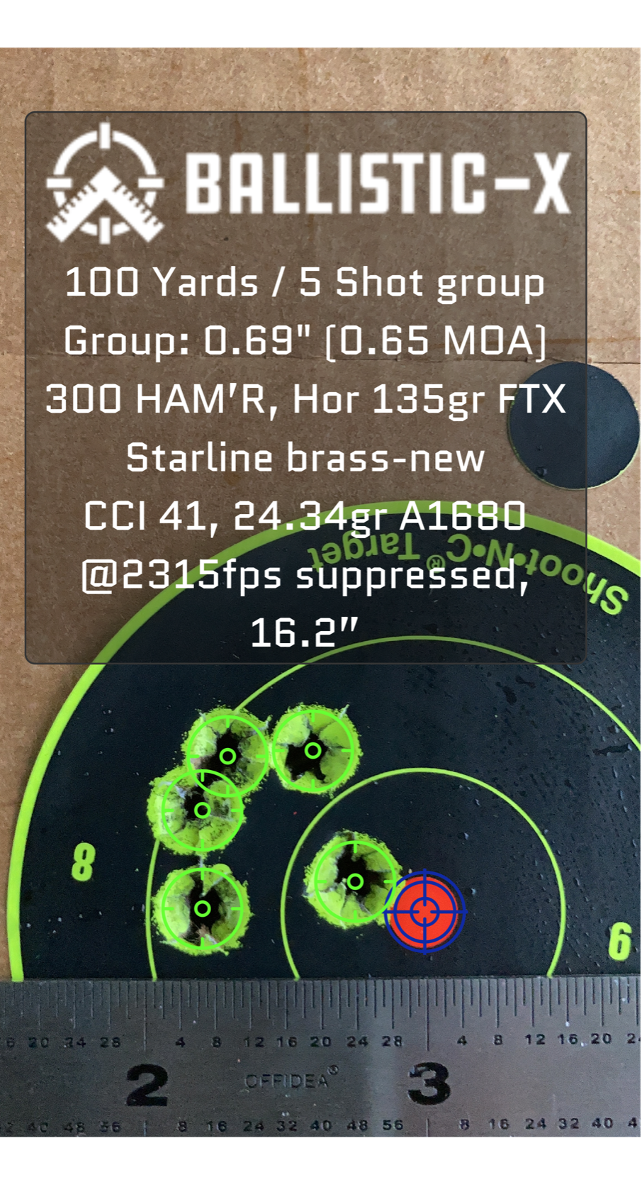

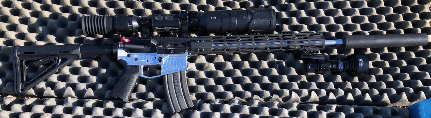

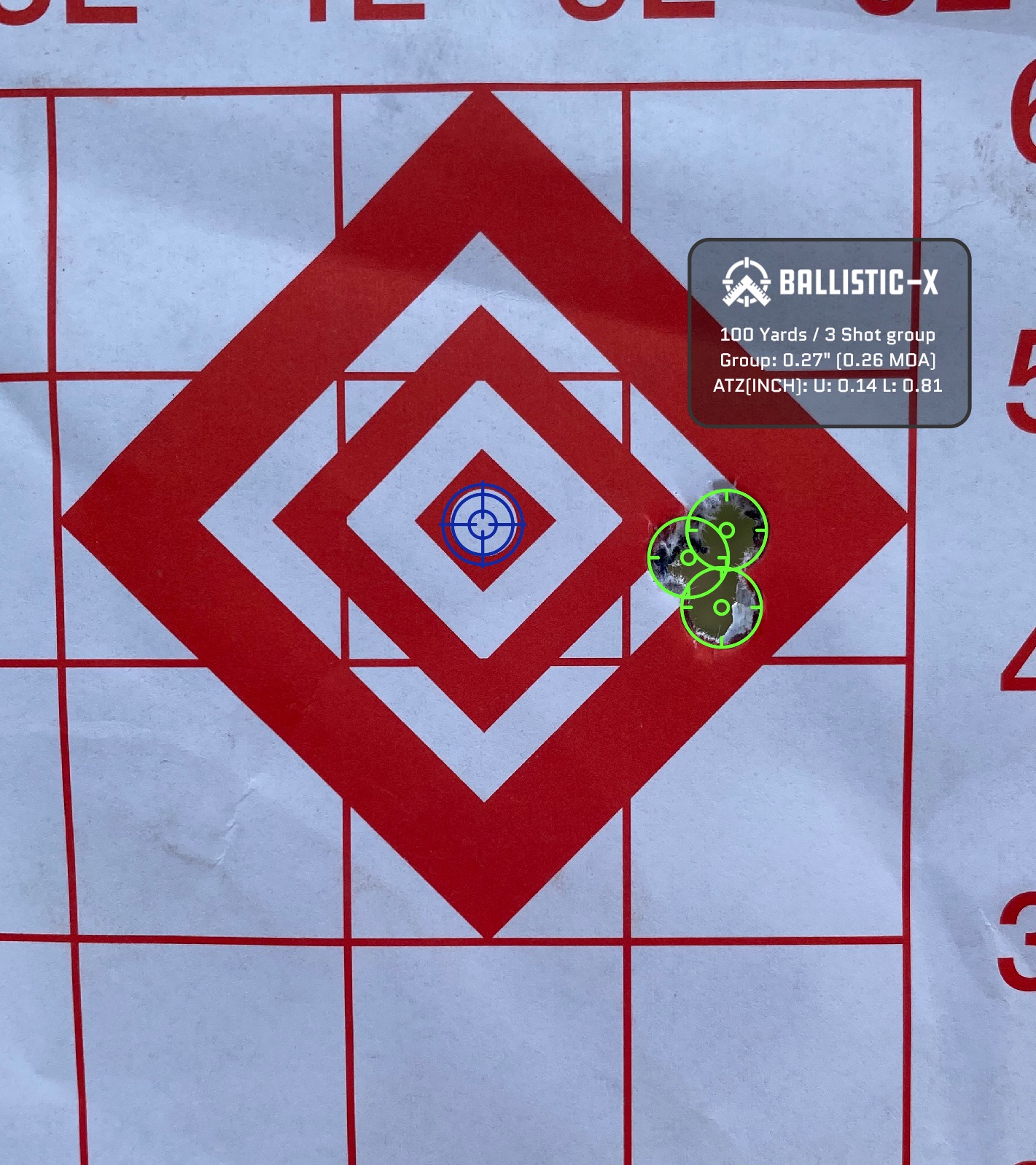

    Assembled the upper yesterday, then function checked, chronoed, and accuracy tested it in a steady 36F rain on my old DPMS 3-gun lower today. The Ranger profiled barrel is VERY lite at 1lbs 8-5/8oz. All I did to prep the brass was to graphite lube and run a mandrel through it, then prime & charge it. Bullet seating was interesting as I had to use my Hornady 300 BLK seating die and "feel" when I contacted the case shoulder without crushing the case. I'm still waiting on the RCBS HAM'R dies from Wilson. I was able to snag 18lbs of CFE Blk last week from Powder Valley, and that should be enough for ~5k rounds. Now I need to find some places locally to pig hunt. :cool:
    COL= 2.255"

    My CFE BLK powder came in from PV this week. I'm still trying to figure out which lot# I have. Any help would be appreciated reading the Hodgon code:
    The MAX charge weight for CFE BLK is a little more than A1680 (26.0gr vs 24.5gr) and it does yield ~30fps more velocity.
    Accuracy is just as good, if not a little better than A1680:

    Very happy so far with the caliber. Now I just need to find some candidates of the porcine variety to test terminal ballistics on.
    I built one when WC first started selling barrels to replace the kids 300bk hunting gun. I love the round. I built it for killing hogs and deer. I shoot it suppressed and it's a pleasure to shoot. I had a 300bk and I didn't like the terminal ballistics past 75 yards with the same pill. We have killed deer out to 150 yards without any problems. Most take a dirt nap right after the trigger is squeezed. I load the Ham'R with 125 NoslerBT. It shoots really well and I get sub moa if I do my part.
    Ballistic-X-Export-2021-01-17 16:31:49.357416.jpeg
    Reactions: bunsen27
    Nice! 300 HamR is very accurate.
