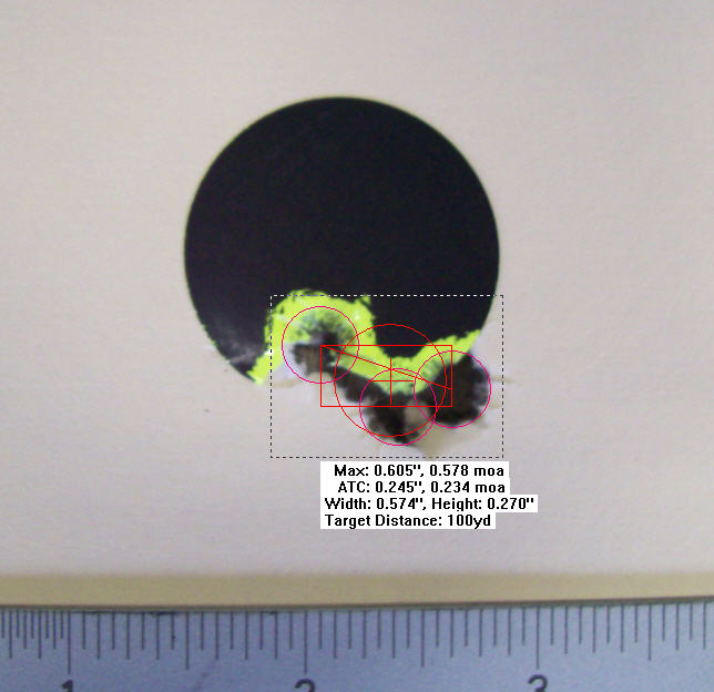

I have a .338 RUM with a vias muzzle brake - which works quite well to dampen the recoil if not the muzzle blast. It'll reach out to 1750+ before dropping sub-sonic with a 300gr Matchking, and while it's PACKED with Retumbo, I think I could pack a little more in there if needed. It still has over 1000lb's of energy at 1500yrds which isn't bad,... not bad at all
I think an Elk hit at 1000yrds (1240fps, and 1700+ lbs of energy) would be feelin' it,... but maybe you want something even bigger,... I don't know.
Oh, and it's pretty accurate to,... (see pic)
Nothin' amazing, but pretty accurate for a light rifle with a stock sporter barrel/action/trigger off a bipod with a rear bag,... not to mention ME behind the trigger
I haven't done all that much load development with it, but I'm sure it'll tighten up when I put my mind to it

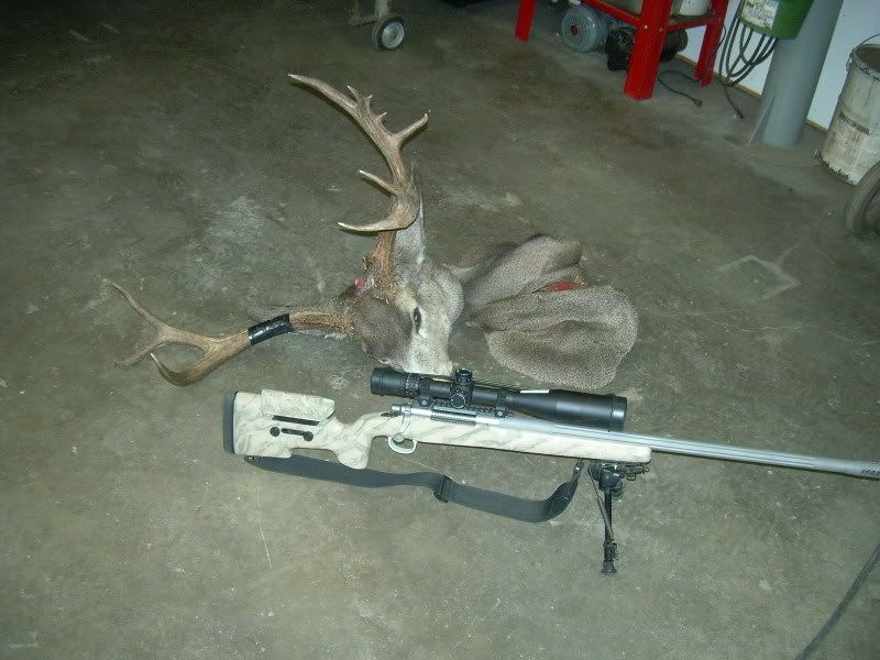

These guys are right, the 300 Win Mag has plenty of reach for even extreme shots that push the boundaries of being humane, and it is a much more popular option i.e. more components to play with in regard to brass, bullets, etc. The 338 RUM & 338 Lapua are great, but you're limited to a meager amount of options for brass and even bullets for that matter,... Plus, the components are usually quite a bit more money and you'll use more of 'em - I was amazed at how fast I could blow through a 1-lb can of Retumbo with my .338 RUM! All of them are capable of great accuracy, which is a function of the usual variables: barrel, bedding, practice, load development...etc... not necessarily in that order.

Thats a dandy buck. Great shot too. I really think I would be better off with the 300wm. My dad has one and thats the only rifle he carries. Its taken deer here in arkansas, kansas, and elk in wyoming. And he hardly ever has trouble getting brass or bullets. Did you try different loads with your rifle or did the H1000 just work really good as your first load? And I don't reckon I've heard of VLDs. Have you had good luck as far as hunting wise with those bullets? I usually either go with hornady or nosler ballistic tips or accubonds. Thanks for the help.

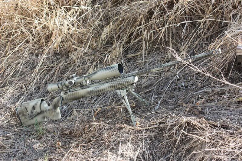

I run a #8 Lijia with a 1:10 twist Fluted which doesnt hurt accuracy, this gun is the one I compete with and I shot that deer at 974yards. My spotter also has a 300win and he started with a 28" barrel and he cut it down to 27" then 26" and really there was no gain in fps (very little) with the 210gr Berger VLDs. So when I built my 300win 26" is what I went with and this gun has placed 1st in matches and shoots big deer too....LOL Hope this helps any more info just let me know!

Thanks again for the info. Sweet looking rifle btw. They can put any contour barrell on that i want and i'd like to have the fat sucker they have on a couple 308's and the 338lapua in their building. The main reason i wanted to go with the little longer barrell is because i was worried with that thick of a barrell it might look kinda stubby with a 26" barrell on it but i don't think it would. Did your spotter gain or lose speed when he went to cuttin down the barrell?

The top picture is my 300win it weighs 15.7lbs, 2100yard target WAS my 338Edge and it was around 17lbs if I remember correctly, last picture is my 7-300saum and its around 13lbs.....All with 5.5-22x50 NP-R1 NightForces. Win has a 40MOA base, Edge has 43MOA custom base, 7-300 has a 40MOA base,,,,,No need for zero stops when your at the bottom of your scope. These guns are not all that fun to pack around, Ill be the first to admit that and My next project is to build a 18" 260 or 6.5x47 LightWeight Deer rifle....around 10-12LBS LOL
