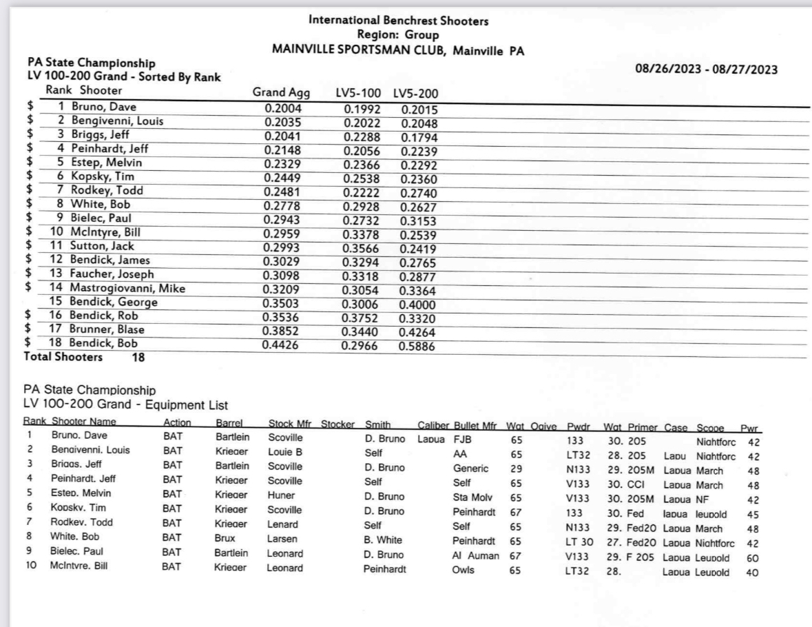

Geographically, you’ll find different barrel makers occupying the top spots in BR competition. No other barrel makers even comes close to dominating benchrest like Bartlein and Krieger do.
Here are the grand aggregate winners from the Pennsylvania state BR championships this past August. Funny, this is the second time this has come up in a week.
