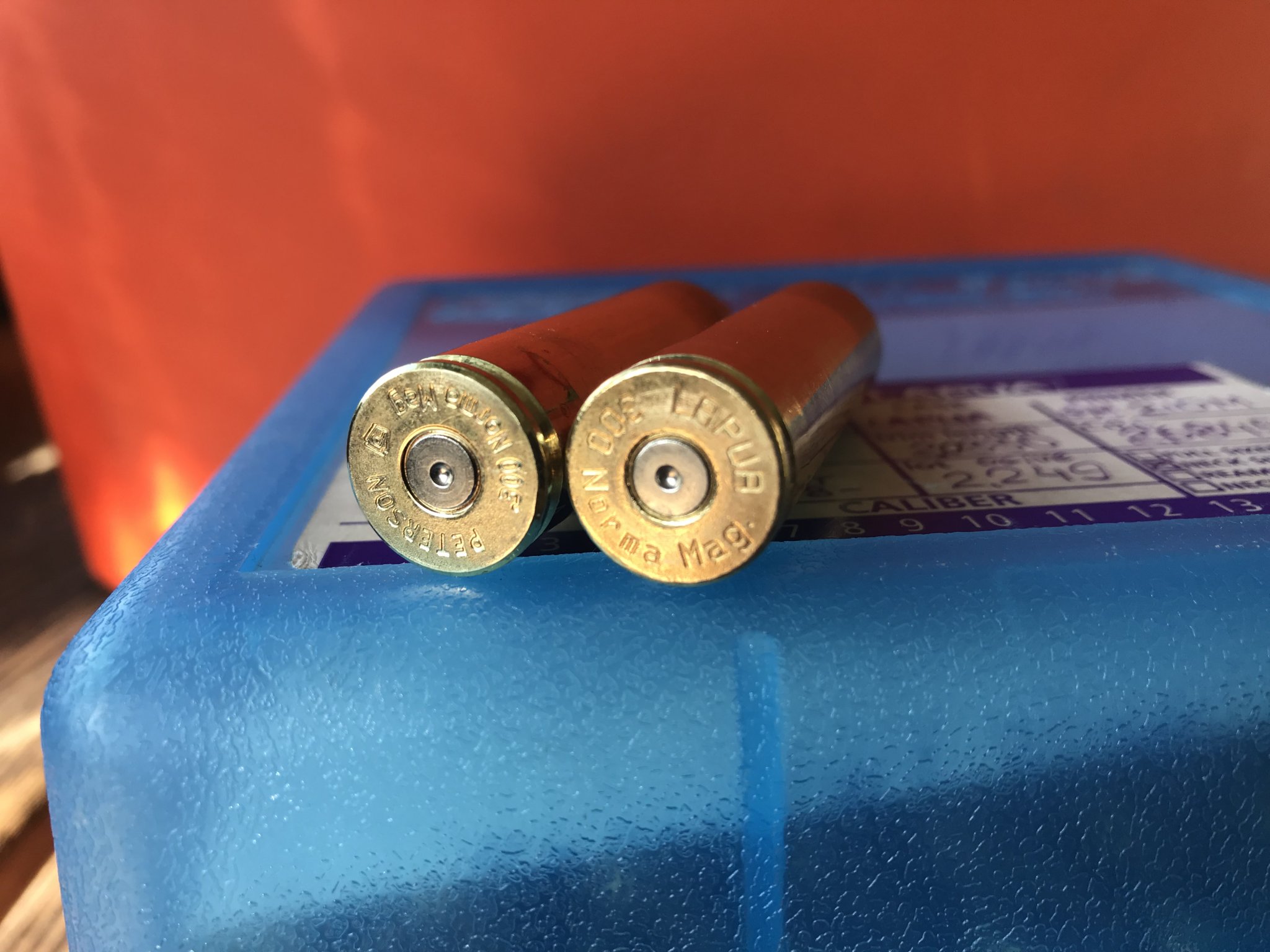

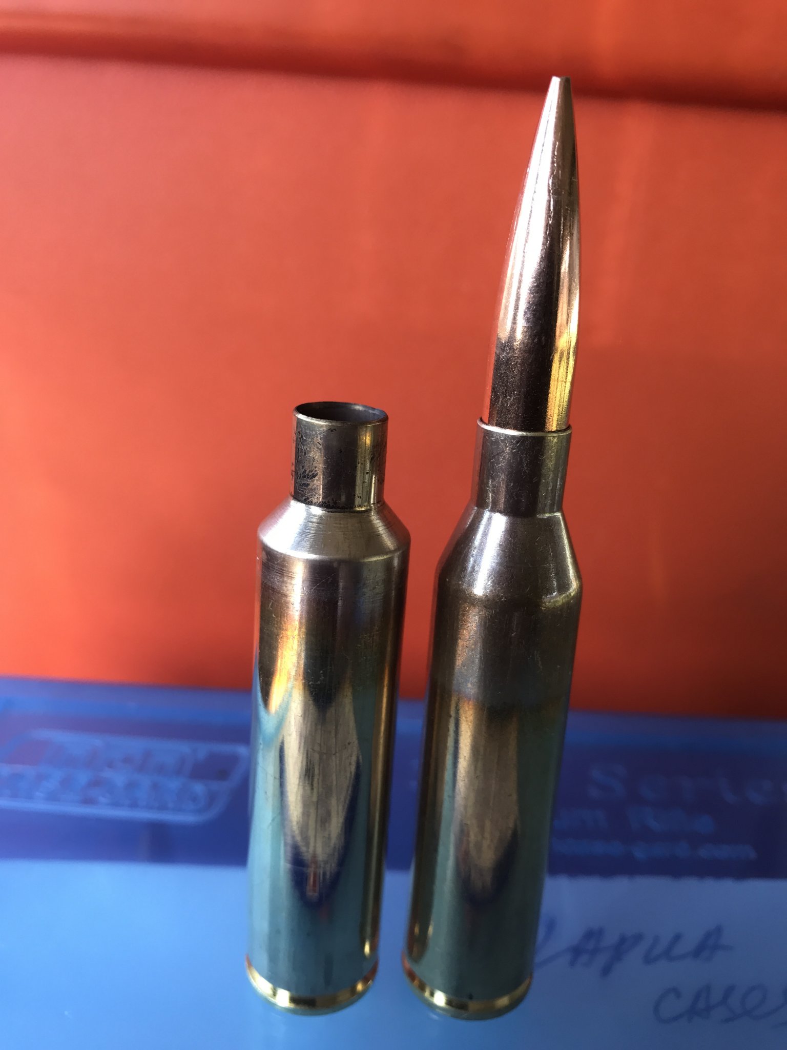

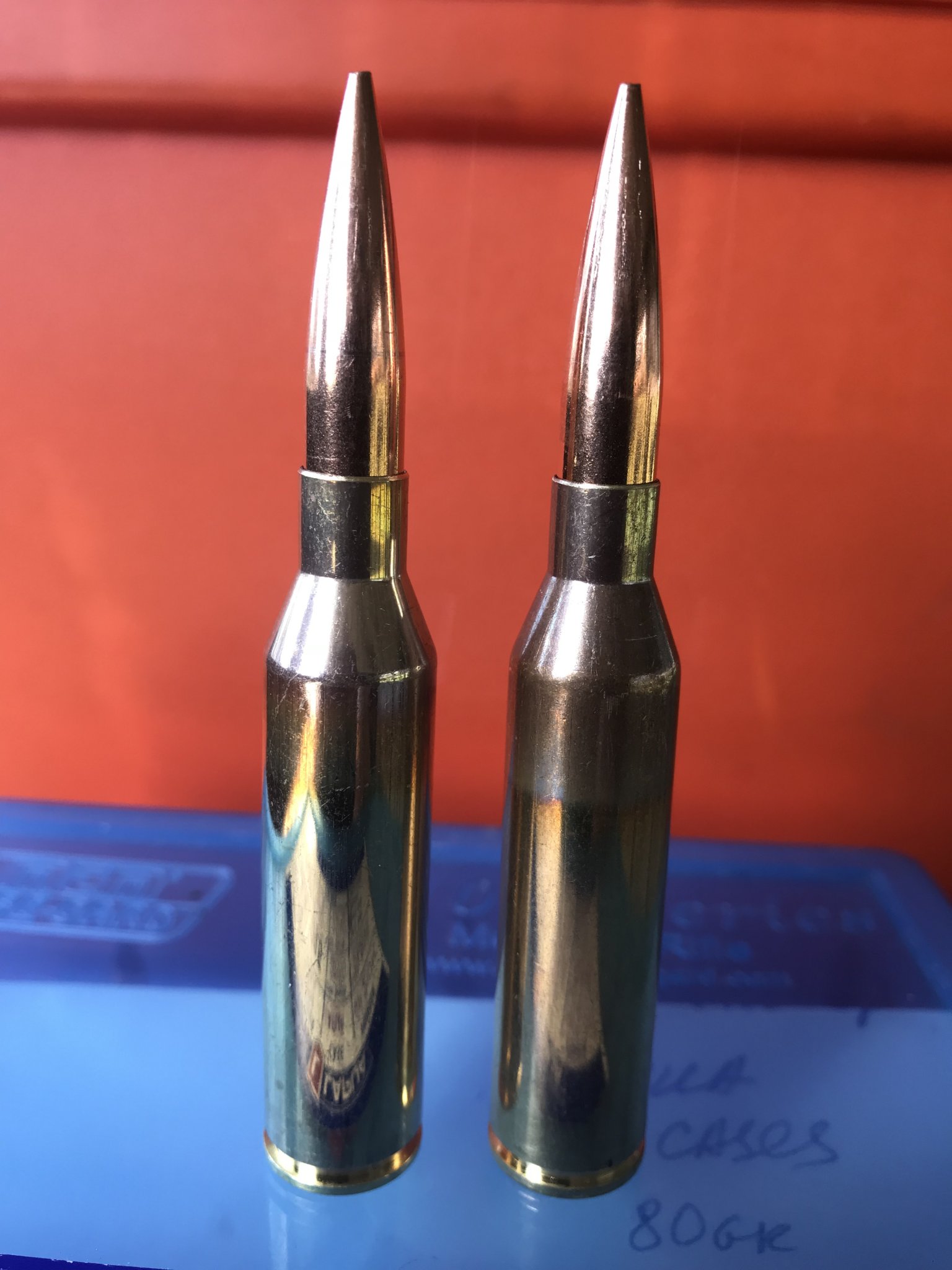

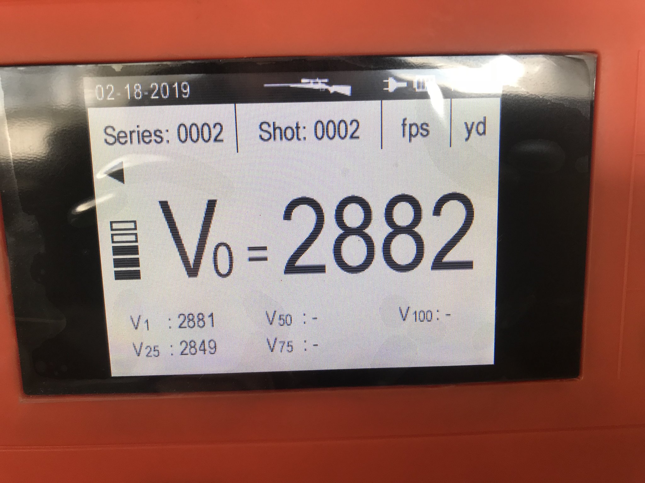

Just starting my process with 300 NM 40 Imp. Giving a try with Peterson and Lapua brass . Planning to shoot 215 Hyb or 230 Hyb . 86 gr of Ret for fire forming gave me 2882 ft/s and idea where I should start .
