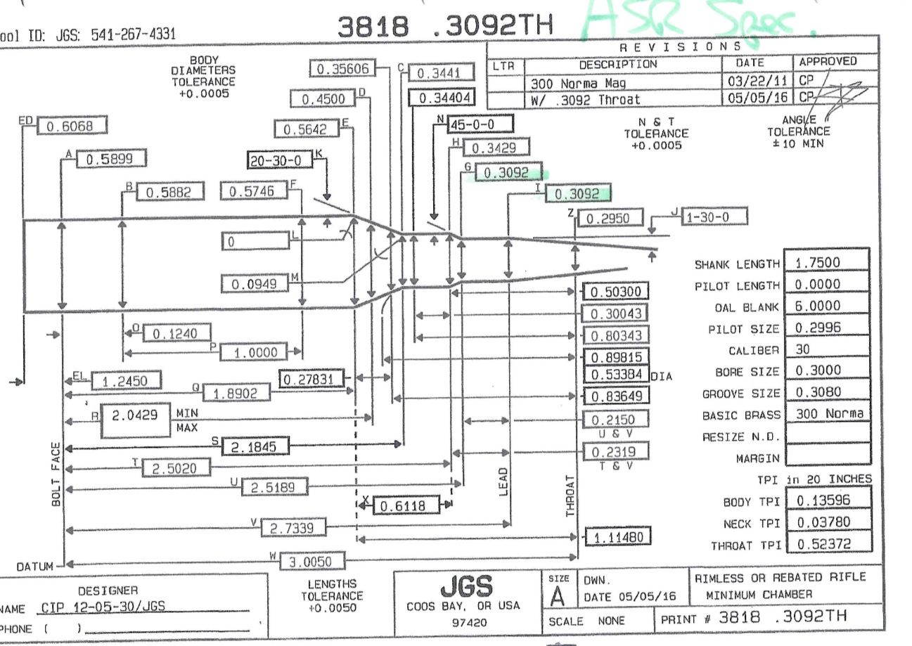

This is Alex Wheeler drawing

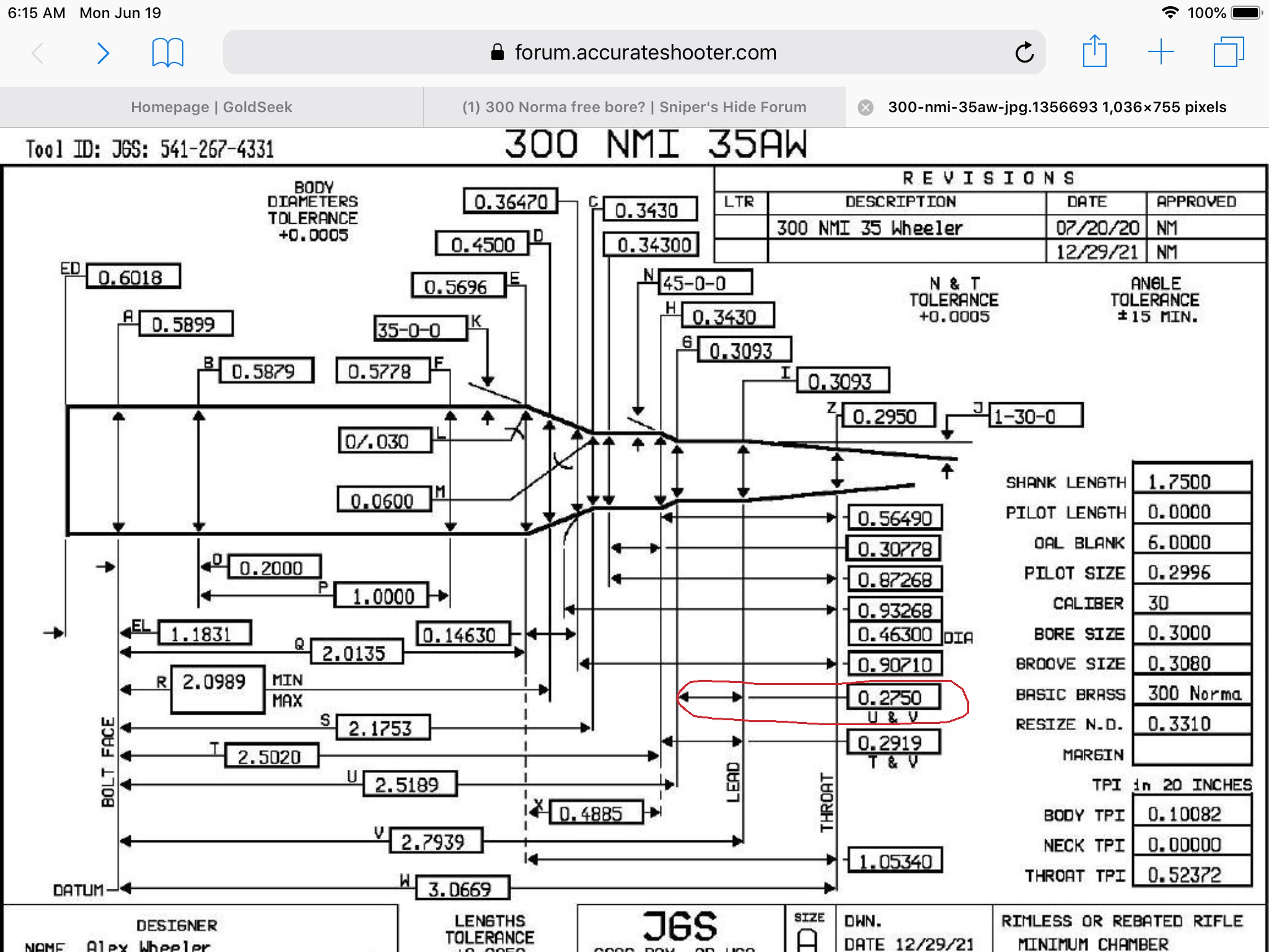

.215 is Sammi and CIP spec if I remember right, my last one was like .235 or so, and my current one is .220. Allot of people seem to recommend .250 or so it seems for the longer bullets like the Atips and 245 Hybrid.
I beat this topic to death on my last one and have not seen a huge issue with my .220, and to be honest it was not worth the time I spent on it.
If you look at the various reamer prints there in 0.060 difference in the freebore and the CIP print has neck taper that is not present in the more benchrest type reamer. The neck diameters are only 0.001 variation but the smaller neck diameter is 0.343
If your running a 0.308 bullet and your necks are 0.015 thick that gives you 0.343 + 0.015 + 0.015 = 0.338 loaded rounds in a 0.343 chamber or 0.005 clearance. That is a safe amount for those not wanting to turn necks.
If you have the tools to turn necks I would not go with more than 0.340 on the neck and stick with the no taper neck.
Mr Wheeler also specified the resize neck diameter at 0.331 which is 0.012 under the chamber dimension. This would give 0.007 neck tension if the loaded rounds were 0.338 diameter.
I don't own or shoot a 300 Norma but given the numbers I suspect 0.336 is what Alex was basing his reamer on?
