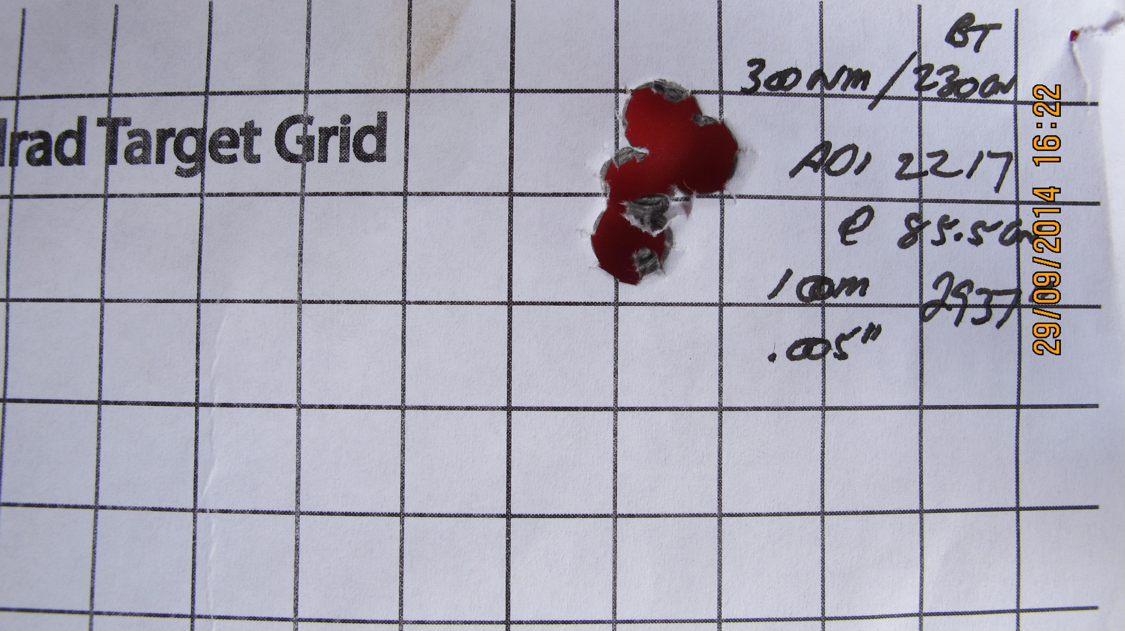

    Here is my two cents worth from todays range tests 300 Norma mag custom rifle , rifle spec barrel 26" twist 1:9 IMG_0335.jpgIMG_0334.JPG
