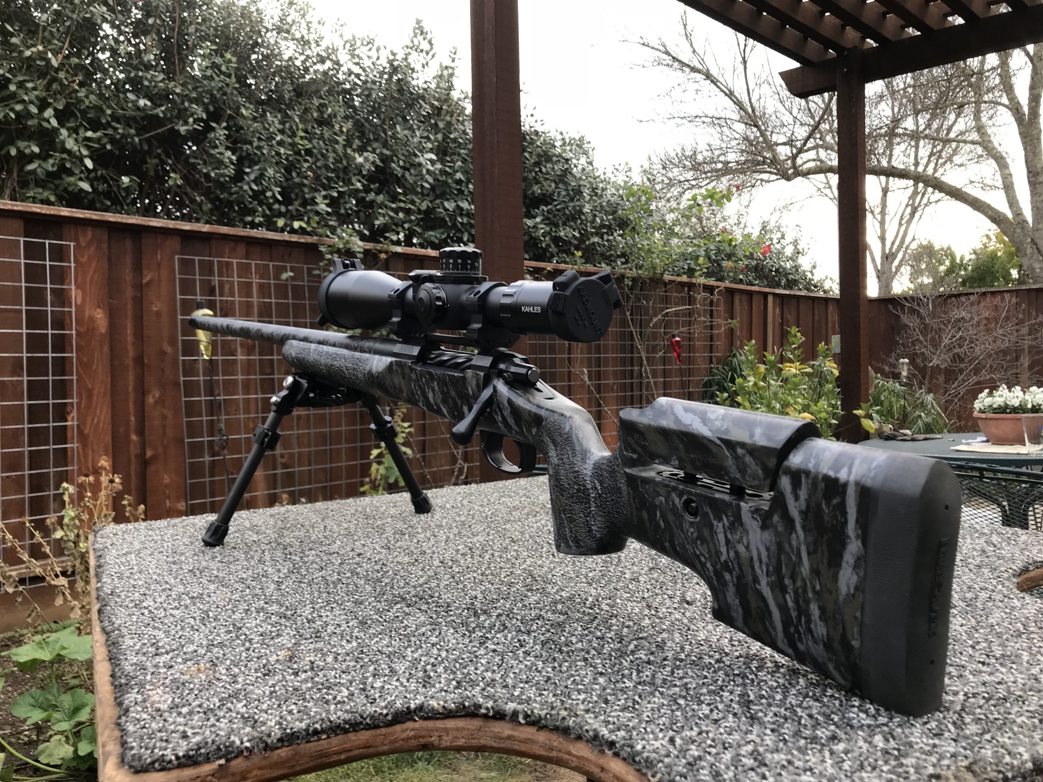

Sorry I can't offer any help with your issue but... I wanted to point out that the CF barrel looks amazing with the molded camo in that McM stock!
Reactions: davidb187
I agree that the CF and the McMillan colors do look amazing. Steve built a solid gun and my only disappointment is that it won’t shoot the 230s despite me paying for the reamer and specing the 230 gr Berger. I didn’t know better and him order it but I paid for it. It is the prettiest rifle that I own. Best part, the rifle only weighs 13.1 lbs including Kahles 624 with sling. I was worried about recoil but I had Steve use one of his Titanium muzzle breaks, and a limbsaver recoil pad, and I kicks like my 308. I could literally shoot it all day and no soreness. I am a real pussy when it comes to hard recoiling Rifles but this is a pleasure to shoot.
