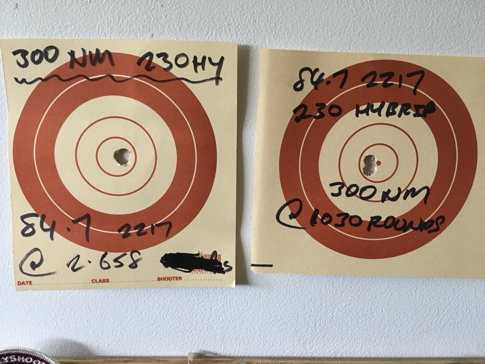

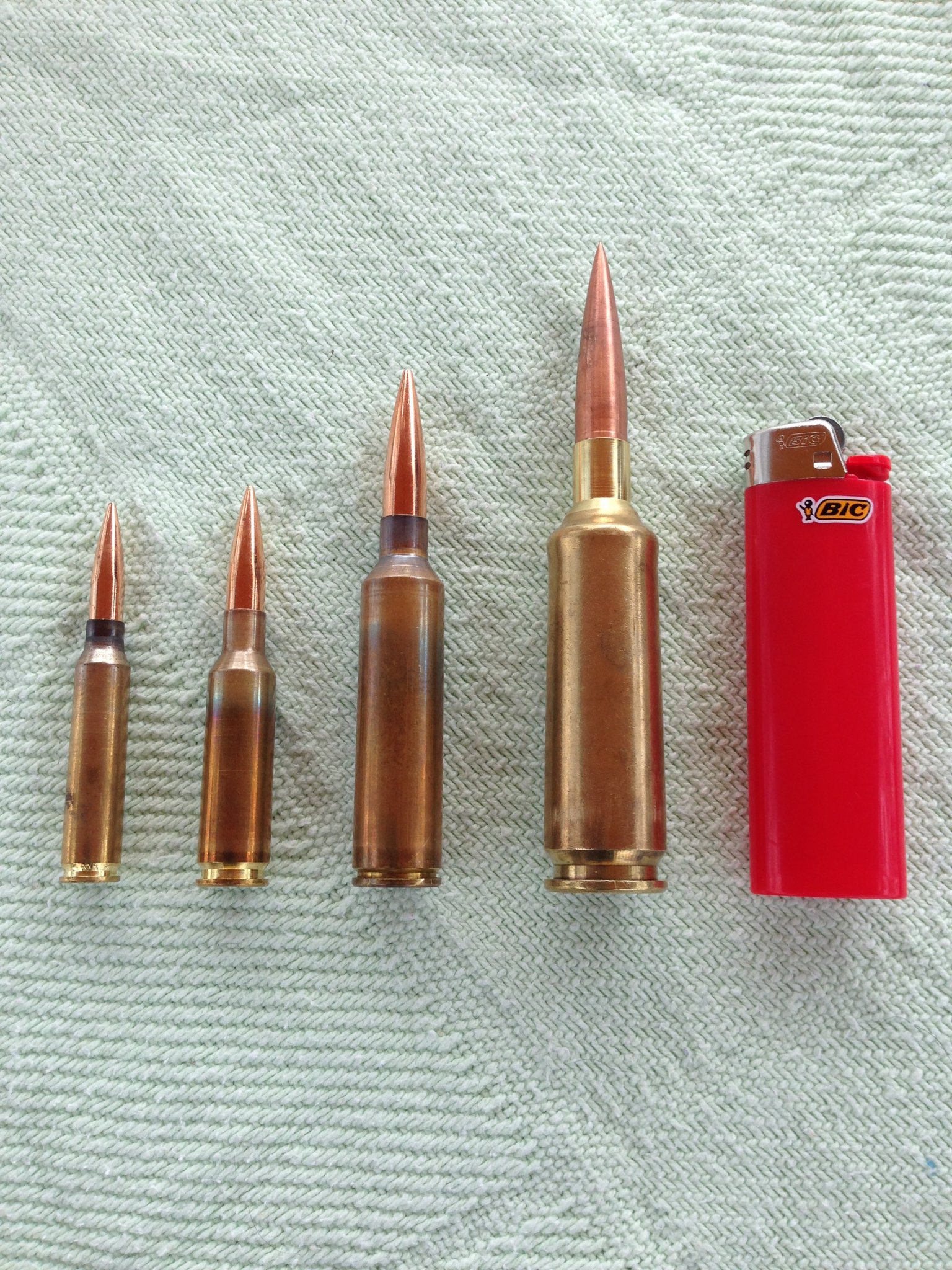

I’m running a 35 degree improved version , and barrel life seems excellent for a 300 NM variant .
Form L to R : 223 with 80vld , 6.5 x47 with 130 AR Hybrid , 300 NM Imp with 230 Hybrid , 375 prototype
based on 50 BMG .
Left target is 3 shots @ around 200 rounds thru , right is 3 shots after 1030 rounds , shot in a 15 mph 3 o’clock
wind . Velocity has dropped from 3k to 2930 fps , last week I had it out to 1500 , and it was holding less than
MOA vertical at that distance . I shoot in extremely hot conditions sometimes , so I elected to run a milder tune
than a lot of guys here run : only 84.7 of H1000 . I prefer to sacrifice velocity in favour of reliability .
Barrel life seems to greatly benefit from the 35 shoulder , and milder tune .
based on 50 BMG .
