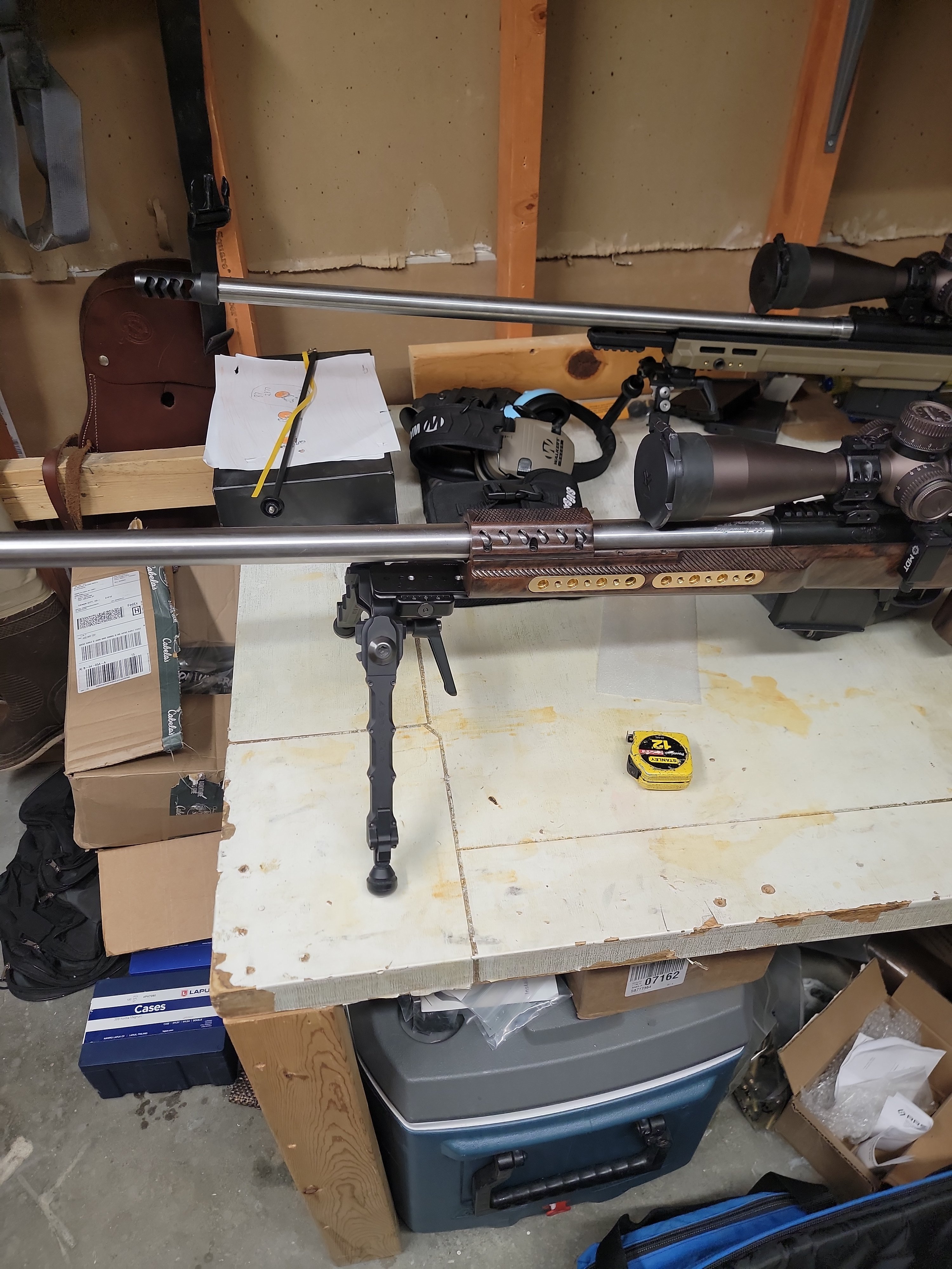

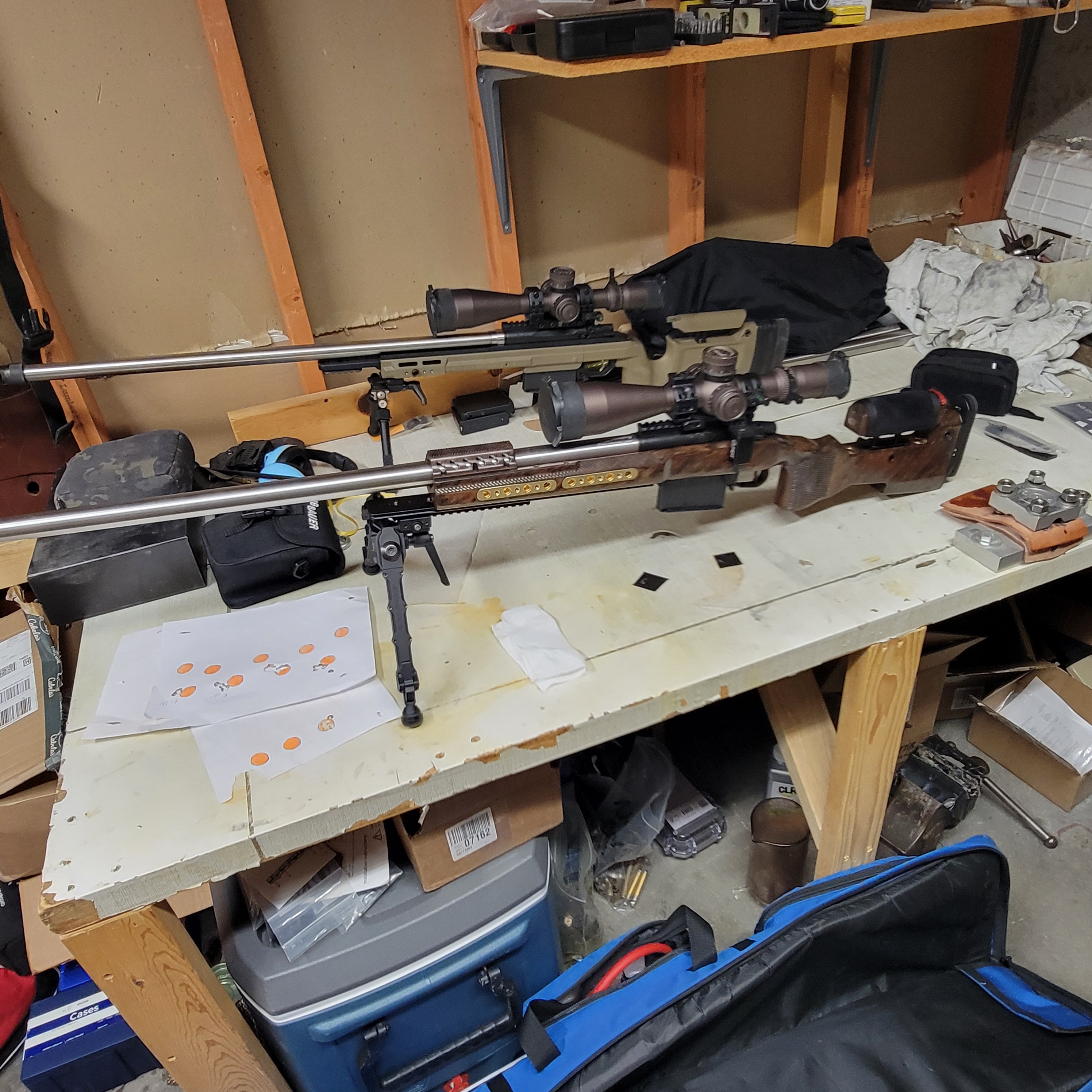

I run a 300 norma improved 32 inch barrels i believe the vcc contour with a samson foundation long action Bat action with brass weights but the arca was non brass. With one set of back weights out im 25.9 or so...... I run a razor gen 3 area 419 mounts sent it level. I think bats are go to for the lapua cases and I'm a huge fan of stocks now since I went foundation
Sounds like a beautiful build , do you have any photos
Reactions: ShowMeMile2024
First time the pics didn't work
