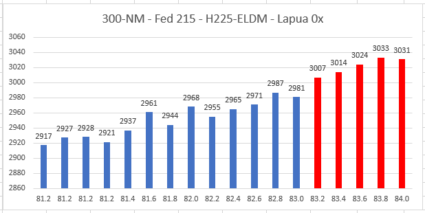

    Testing continues ... got a nice ladder with H1000 and Hornady 225 ELDM's ... with a surprise. I had intended to shoot 3 "warm-up" shots and then start the ladder at 81.2gr, but just for the heck of it, turned on my Labradar to include the warm-up shots ... something I don't usually do. Those four shots at the start of the ladder that were the same charge, and gave me a SD of 5.12 and a ES of 11. Definitely a nice node to investigate. I'll do that before I look for other possibilities. Pressure signs (heavy bolt) started at 83.2 (last 5 shots) so I'll definitely stay under that. Any opinions on velocity here? If 81.2gr of H1000 provides itty-bitty SD's and tight groups, is 2925-ish velocity OK for 300-Norma, or should I be looking for higher? Here's the ladder results ... BTW ... I'm (finally) done fire-forming my new 300-NM Lapua brass so everything else will be tested with 1x or greater fired brass.
    you should STOP right there. You will sacrifice too much trying to eke out another 50 fps and the down-range result may suffer
