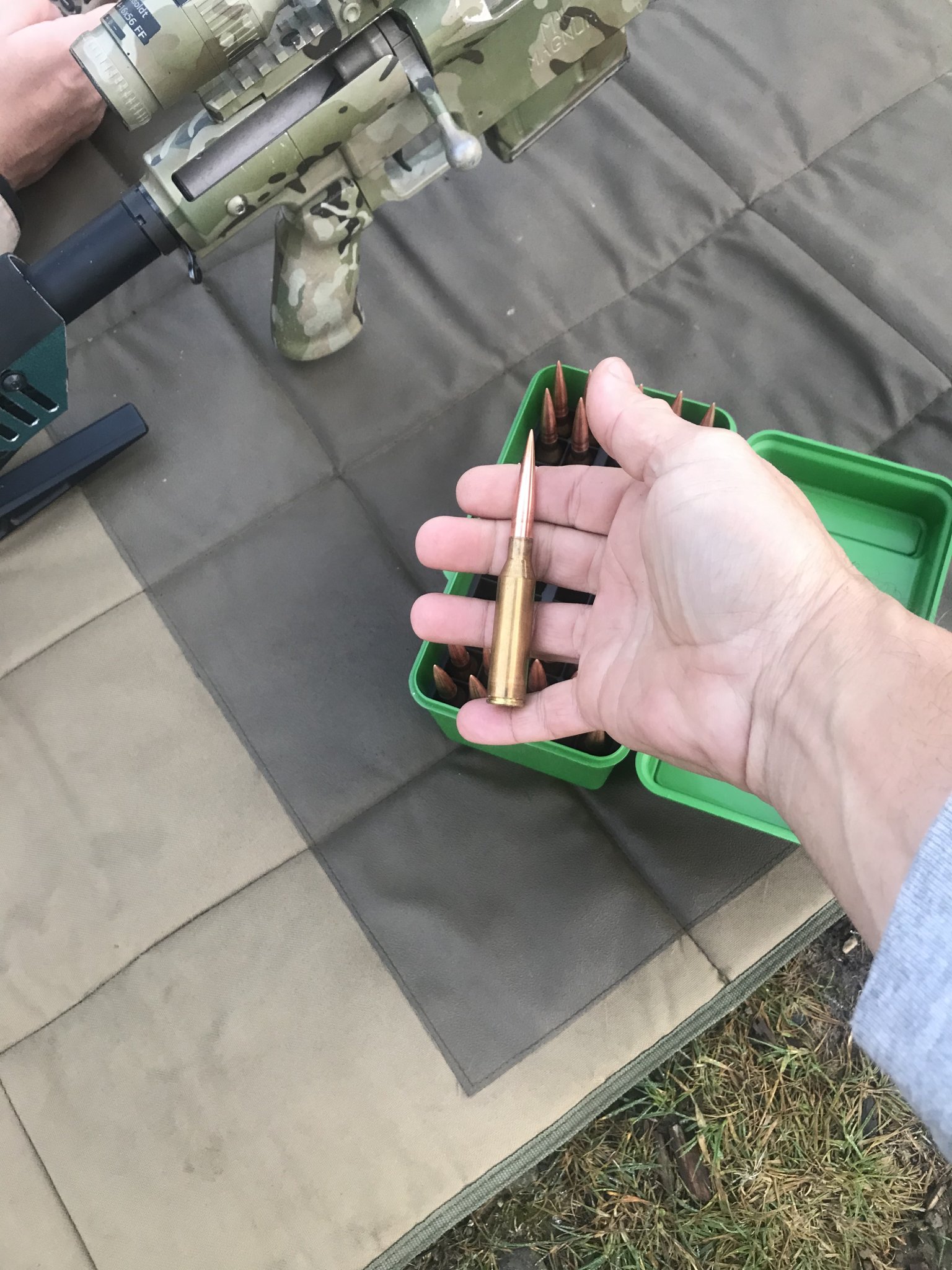

Steel head Feral kitten Full Member Minuteman Aug 3, 2014 18,073 58,870 Washington Jan 20, 2022 #3 Jan 20, 2022 #3 Loaded this on a Forster press Reactions: MarshallDodge
Mr. Z Belligerent Full Member Minuteman Supporter Feb 20, 2017 1,514 3,291 Wisconsin Jan 20, 2022 #4 Jan 20, 2022 #4 Steel head said: Loaded this on a Forster press View attachment 7788846 Click to expand... You want to get out of that old beat up outdated 4-16 you let me know. I’ll give you a dollafiddy. Reactions: MarinePMI and Steel head
