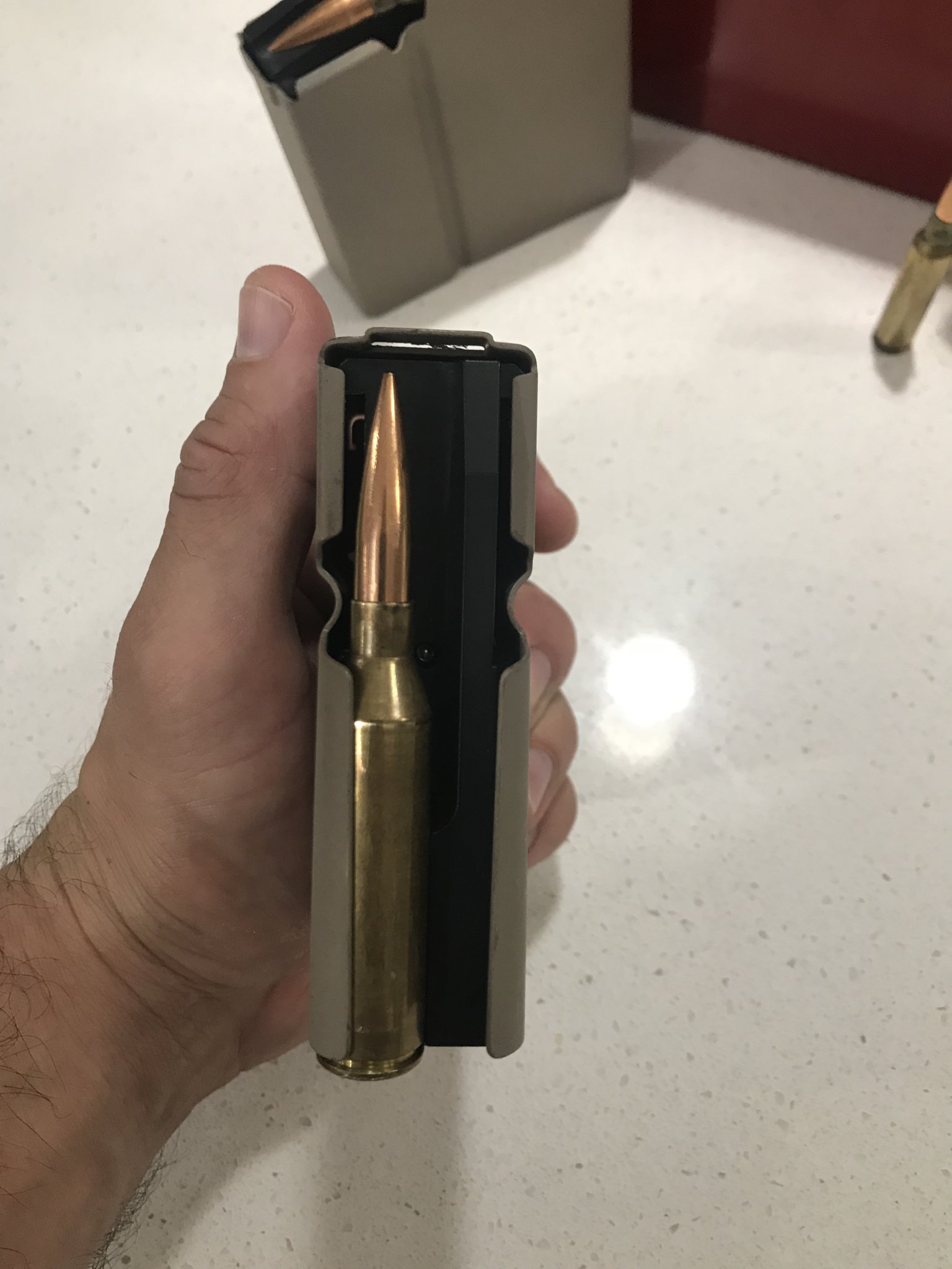

That’s good to go and decent velocity. I have a 30” barrel coming for an AXMC. This is a dummy round at 3.650” in an AX338 mag, heaps of space. I’m going to run 245s when I can actually find them in stock over here.
