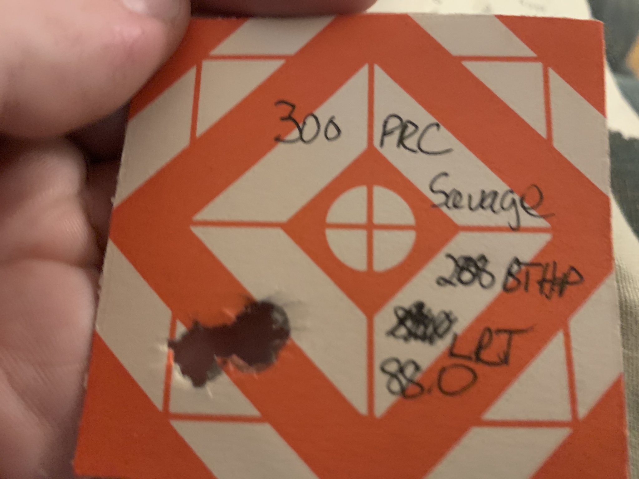

Three shot group from sighters yesterday.
LRT heats the barrel very hot, very quickly. It’s a heavy Palma that’s slow to cool.

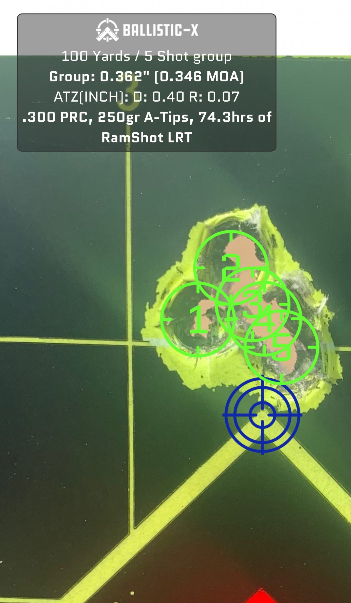

My barrel only likes the heavier bullets 225,230, and 250’s. Ran out of RL25 and RL26. Been using LRT with my latest load work up. Need to get my Lab Radar to check these out. I know these 250’s are slow but my 24” 1:9 barrel likes them so far. I’m jumping up to 82grs on the next loadings
