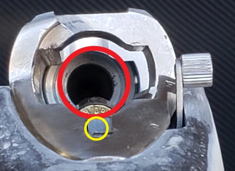

If this were me, step one is reviewing the amount of case overlap you have with the bolt face. The term I use is "figure 8".
Imagine the receiver bore as a complete circle. The primer pocket needs to be tangent to that arc. On a push feed action, this has shown me to be a pretty reliable means of setting up the case presentation. My guess is that if your using a 338LM magazine there should be plenty of overlap just because the feed lips are a bit wider allowing the PRC to sit "higher". Never hurts to check though.

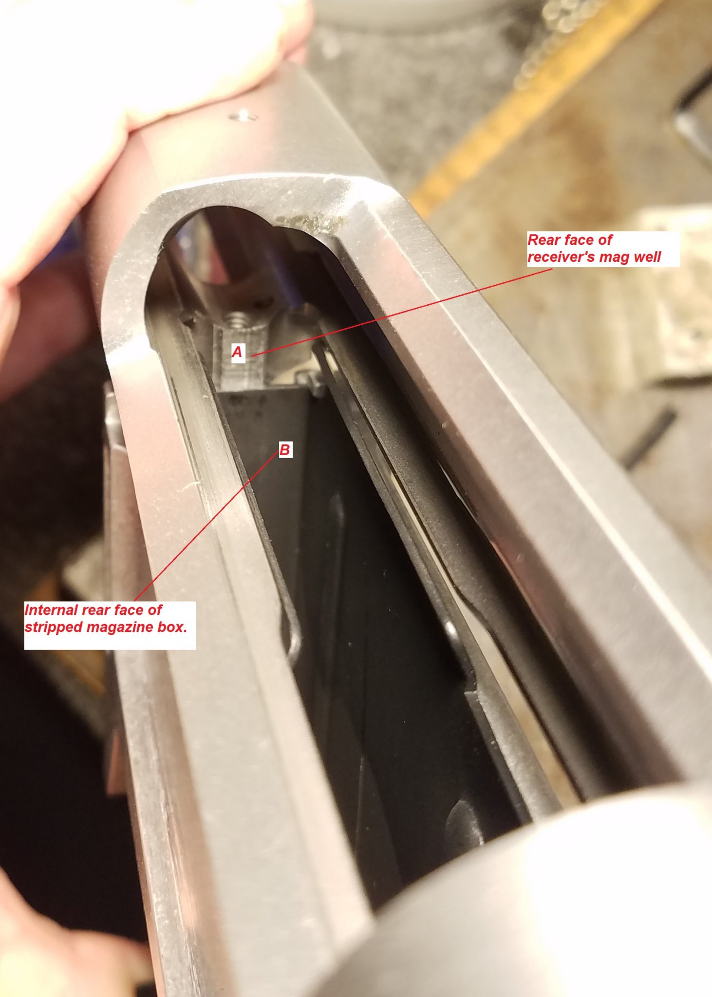

Here is better way to examine the mag position.
Strip the floorplate and follower/spring out of your magazine.
Insert and snap into position.
The rear wall of your magazine box ("A" in the image below) should be just far enough to get in front of the protrusion in the rear of your receiver's mag well ("B" in the image below.

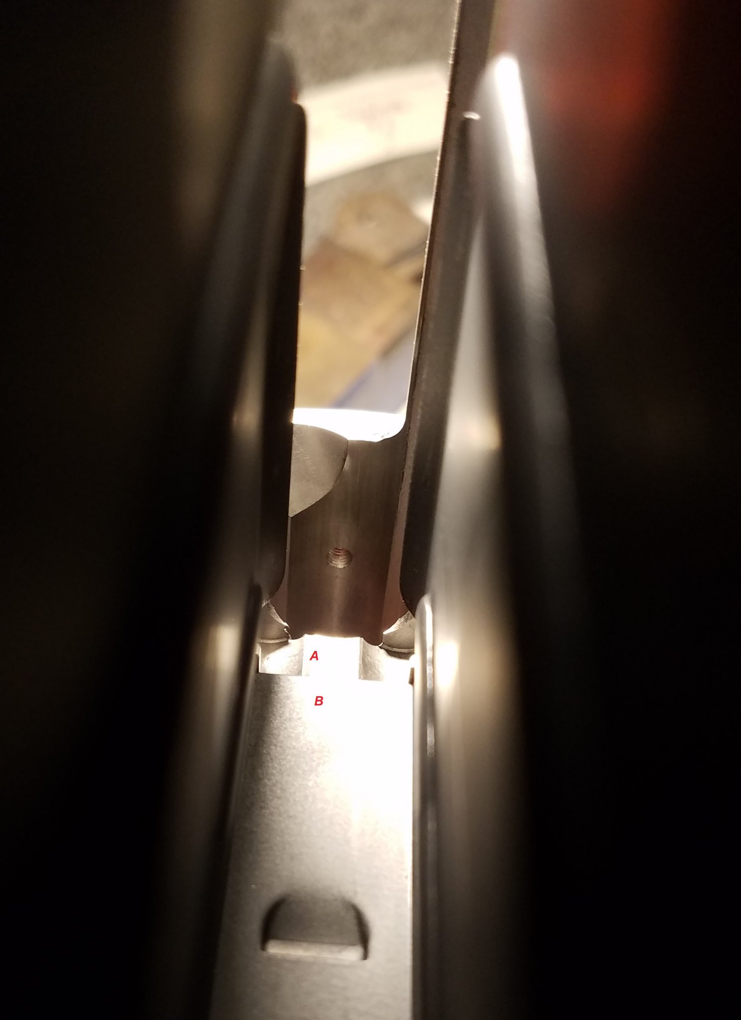

Here is another angle looking through the bottom of the stripped magazine body up toward the receiver's feed ramp.

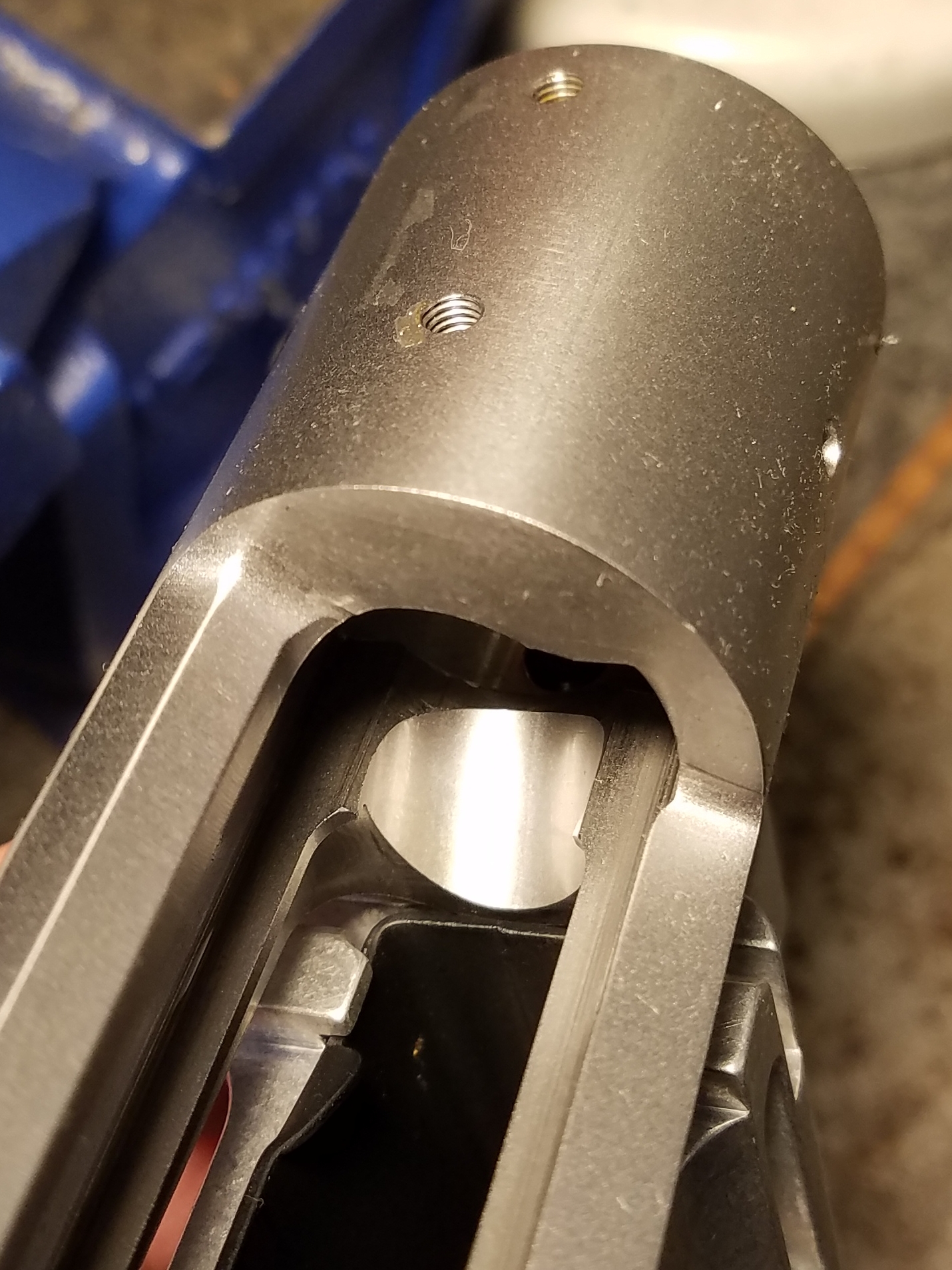

If the rear of the box is in the proper point in space under your receiver, the front edge of the magazine body should be even with or slightly toward the rear of the feed ramp. Ref image below.
The Rem 700 long action receiver has just enough room to correctly position a CIP magazine.
If positioned properly, your magazine is incapable of getting the tip of a round under the ramp.
You should never have to notch a feed ramp.
If the front of your magazine body is forward of the feed ramp, your stock or bottom metal is positioning the magazine at the incorrect point in space.
Remington M700 LA mag receiver and Accuracy International 338LM CIP mag shown in these pics.
