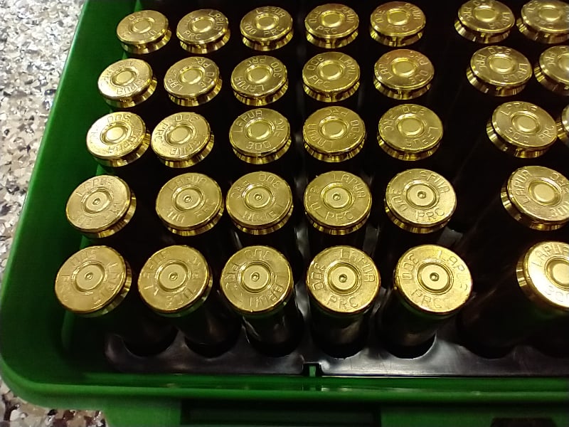

    I am running a 24" K&P prefit in 300 PRC... Just to give you an idea on velocity.
    208 Berger LRHT
    Lapua Brass
    RL26 77gr to 81.5gr in 0.5gr steps gave me 2902fps to 3075fps on the MSv3.
    YMMV... My top charge is .2 over Berger's given data but no concerning signs when looking at the bottom right primer / case head. No bolt lift difference between them either.
