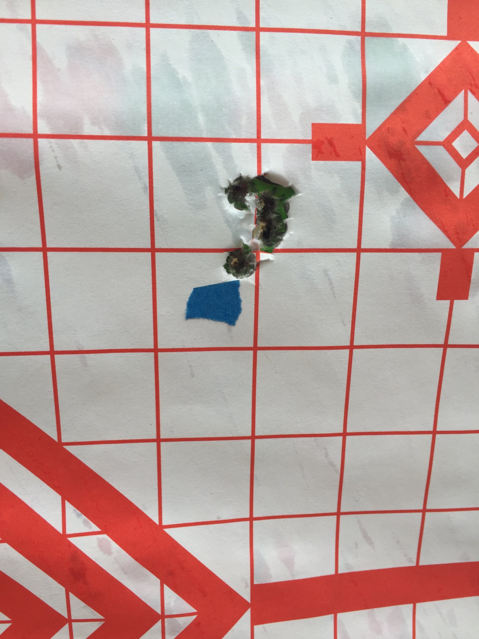

These 11 rounds shot into a group at 100 yds right 1"
Given my ladder test results I felt like the node was in the 78.8 range so I loaded up 10 more rounds and returned to the range for 2 5 shot groups over the magneto speed
Group 1
2870- average
17- sd
Group 2- fired almost immediately after the first
2887 average
15 sd
The results on my 2 follow up 5 round groups were very disappointing based on what I saw in my initial ladder test. My questions:
1. Is 78.8 the node I should be targeting?
2. Where should I be looking to improve my ES & SD?
3. Given the temp stability of the H1000 why am I seeing the velocity variation from my ladder testing with 78.8 grs to my first 5 rd group, and again when I fired my second 5 rd group?
Any help is greatly appreciated as I'm at a bit of a loss at the moment.

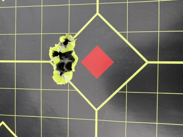

Deviant action, 26” proof carbon sendero 1:10, piercision 5 port brake, ADG brass, H1000, 225 ELDM, CCI 250, 20 thou off the lands. Used 21ST century 0.307 expander. Redding dies
less than 30 rounds through the rifle. Loaded up quick ladder test.
had a node around 2815 with ES of about 19fps spreading over 0.8gr (.2 increments). Had a second node around 2865 about 25fps ES spreading over another 0.8gr (.2 increments
next time out, I’m gonna load some 5 shot groups somewhere in both those nodes to find the best.
btw, factory Hornady 212 shot a 0.29MOA GROUP but the ES and SD were terrible with factory rounds

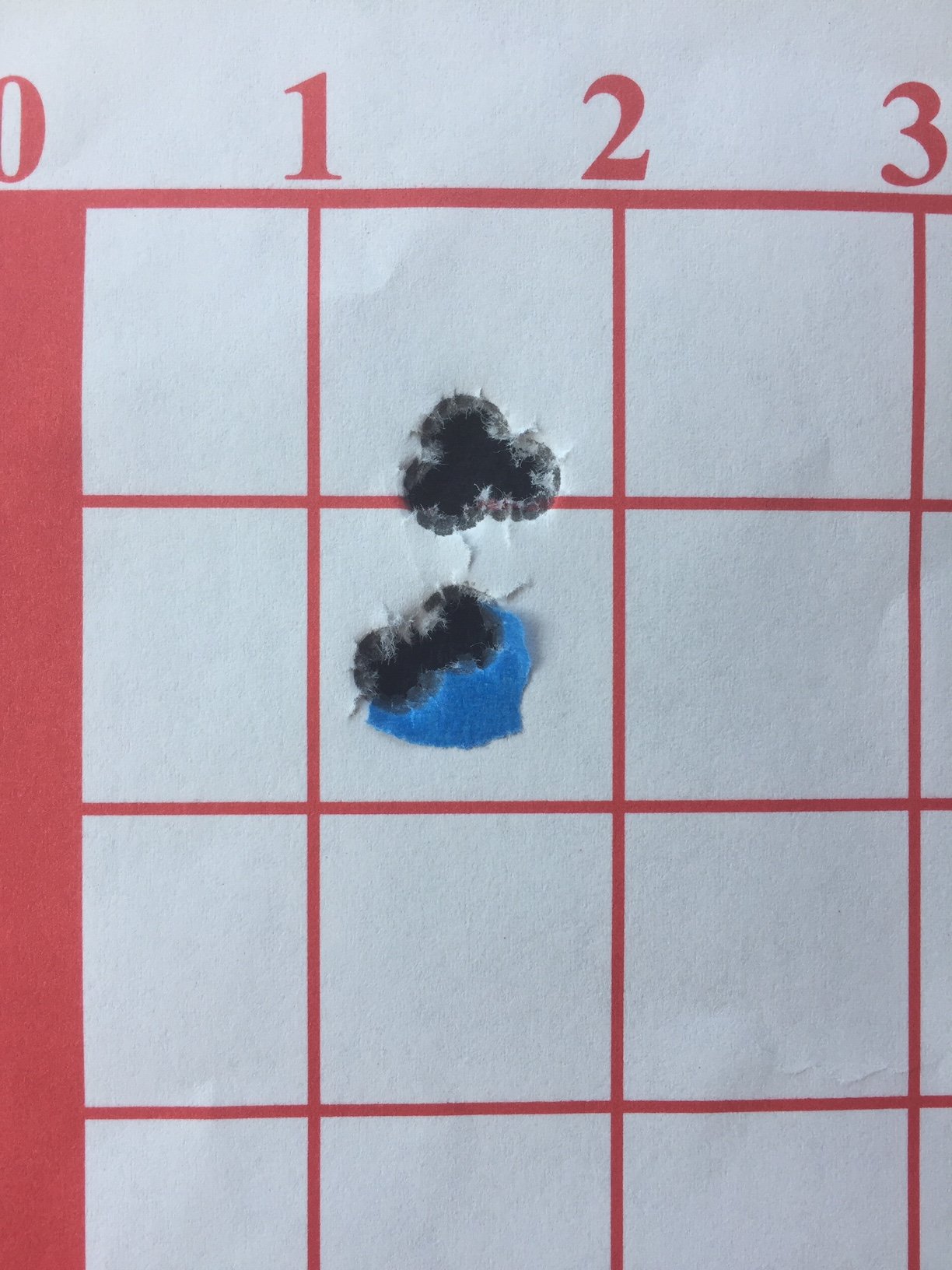

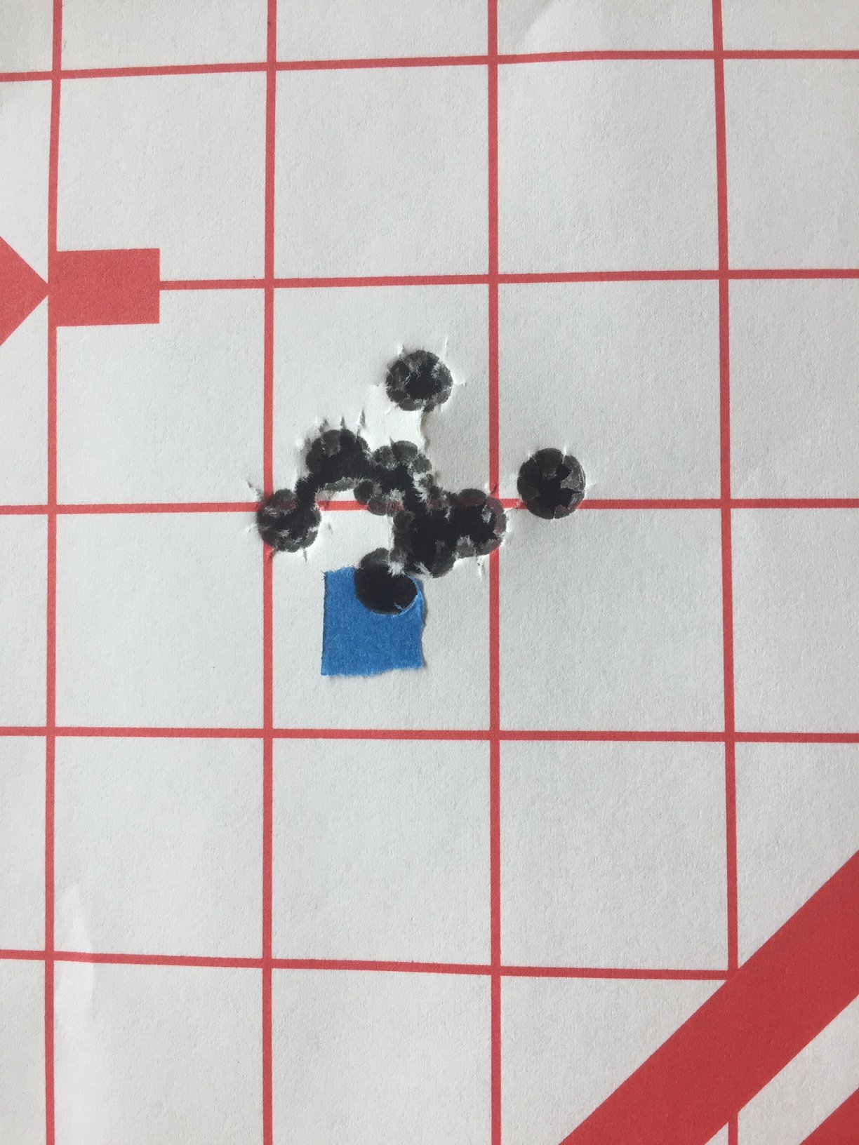

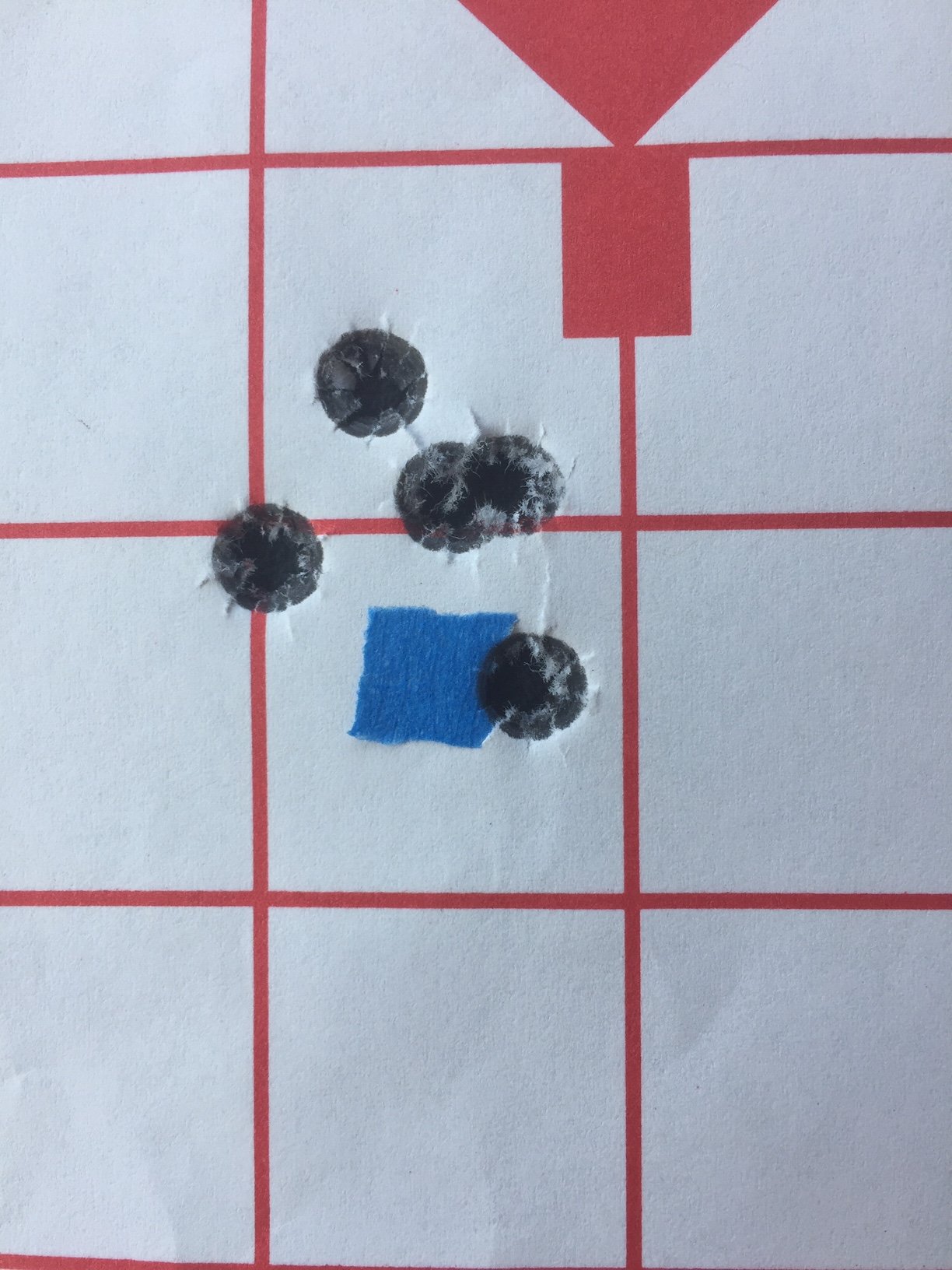

So I picked up some virgin ADG brass, a carbide mandrel .002" below bullet diameter, and a sinclair LE Wilson bullet seater die in a K&M arbor press. Tonight I loaded up my first rounds using my new components and processes and ran them through my hornady concentricy tool.
What is the goal for bullet concentricity?
When running my rounds through the tool after after coming out of the seater I was seeing concentricity between .001-.003". Just not sure what is considered normal. Should I use to the hornady concentricity tool to try and reduce the runout I'm seeing?
In the fantasy world, it's zero, zip, nada.
By "bullet concentricity", do you mean out near the meplat? I measure the brass at the neck and the bullet ~3mm from the tip of the meplat. If you look at factory, the results are fairly depressing. For example, some people talk as if Lapua is high quality. I bought 200 rounds of Lapua 338LM with 300 grain Scenar. Neck concentricity averaged just over 2 thousandths with an SD of 0.8 thousandths. After firing then sizing the neck with a Redding bushing die, and then running a mandrel, the neck concentricity dropped to 0.6 thousandths with an SD of about 0.3 thousandths.
Out near the meplat, the factory ammo ran 7.7 thousandths with an SD of 3.2 thousandths. Ouch. Handloading can cut those in half or better. But if nerd this out to the max, you probably want to measure consistency of neck thickness and before you know it, you'll be turning necks. It's a vicious cycle that could lead you over to the dark side where you read and worship benchrest fanatics and buy an apparatus that helps you to put both legs of your pants on at the same time.
For my 300 PRC, I started with virgin ADG brass, cleaned up the mouth and ran a .3055 mandrel and was ready to go. See post #14 on this thread:
So I've set my concentricity gauge to measure at the ogive on the bullet. When I made my post above about seeing a run out of .001-.003" I was loading in virgin ADG brass that I had run the mandrel through. This afternoon I loaded into 1x fired ADG brass and ended up seeing run out of all my bullets in the .001" range.
Very excited to hit the range tomorrow!

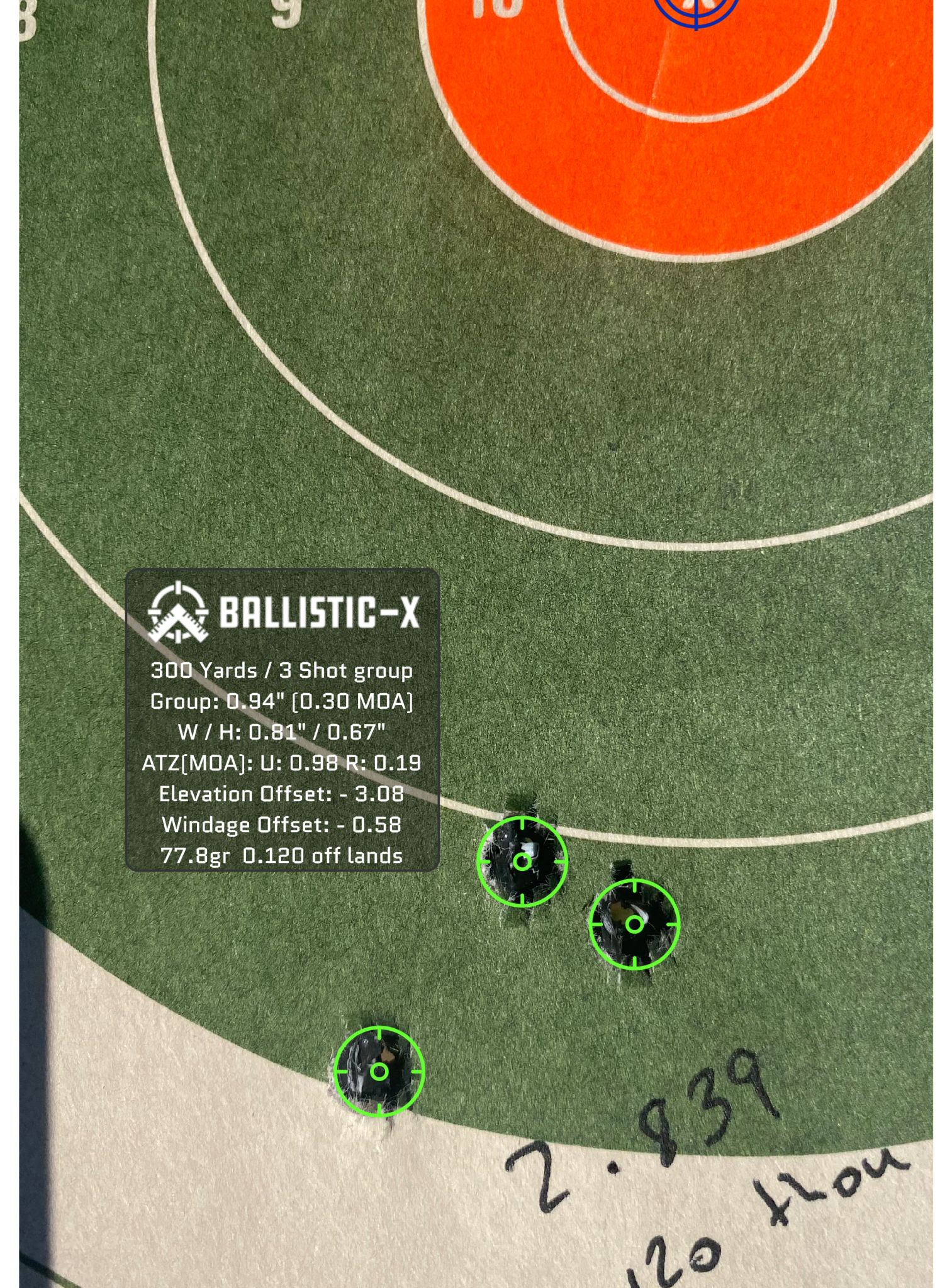

I still haven't achieved velocities that I'm really excited about but I've ended up with a load that I'm happy enough with..... I'm tired of shooting paper at 100 and I'm ready to stretch out and shoot some steel for a change.
Went out this morning with:
230 berger hybrids
77.8 gr H1000
Velocity averaged 2861, with an ES of 25 and an SD of 9.5. Not great but noticeably better than I've been seeing and it's shooting well. Hoping to stretch out to 1000+ maybe tomorrow.
The low rd was my cold bore:
Reactions: b2lee
