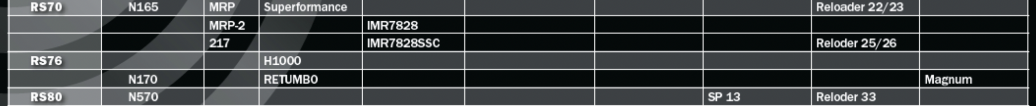

It's been a while I put up this post, but as I finally had the time and components to finalize my load, I consider it finished and a good one basically. The thing is...yesterday I just re-checked the velocities, and was surprised / concerned with the measurements. I got 2932, 2938 and 2936 fps speeds. Higher velocities are, beside mby other factors, caused due to the fact it's very hot these days in central Europe (in comparison when beginning doing the load dev. in the winter). But I have no pressure signs at all as far as I'm able to recognize these. I mean, from what I've read and discussed so far, it seems little bit too much for the 220 Gr SMK bullet. I'm on 80 Grs of Reload Swiss 76 and that also seems too much. It's a powder I guess isn't available and / or well known in the States, but it's on the same level at powder relative burn rate tables as H1000 and just a little bit faster than Retumbo. What are your thought about that? Should I be worried it's too much and wearing of the barrel etc.? Thanks a lot for any ideas.

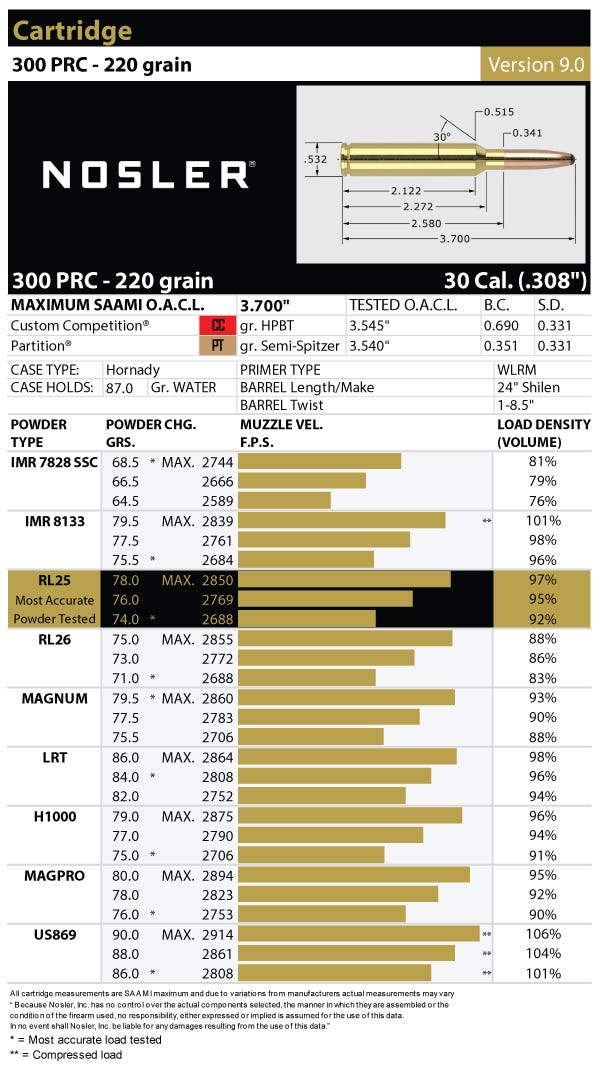

Hi there. Found this post VIA Google. I've got quite a few 220s and plan on using H1000. What would say is a starting charge for this projectile???
