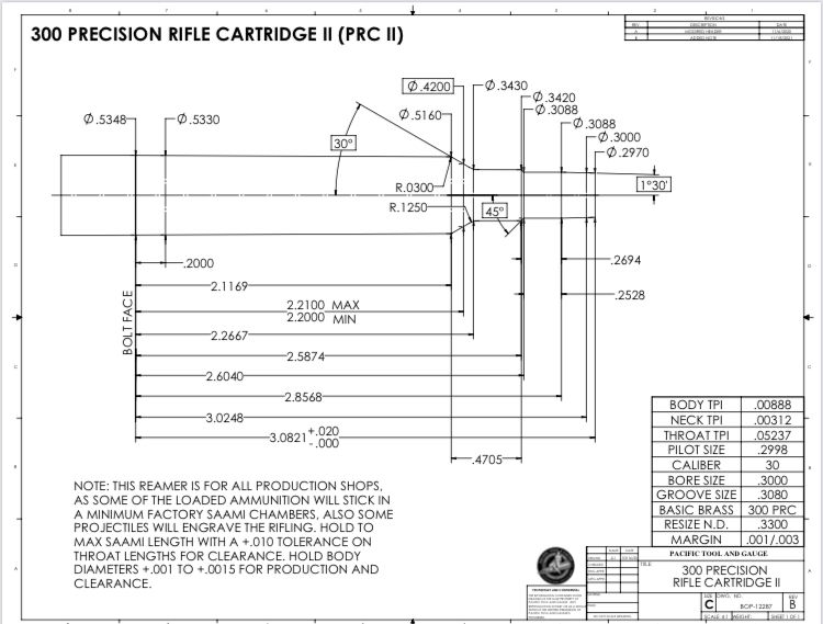

    My google search didn't come up with anything? What dimensions changed?
    Ive never heard or seen any reference to a PRC II. Where was this mentioned?
    If I was going to make a change to a PRC reamer, id add some base diameter. Its on the tight tight for existing dies in my experience.
    Maybe its the live pilot that makes it a gen2 reamer? I see they offer it in other cartridges.
    I didn’t want to say it 😂😂
    Reactions: Txmack
    Looks like the PRC they have is a custom reamer so you could probably order it with different freebore etc but the PRC II is the saami reamer.
    Reactions: Txmack
    No, that’s just an available option on everything they make. My first PRC reamer was saami, and came from PTG.
    Here’s the print.
    Reactions: BCX
    Thanks, i was to busy to get on the phone today.
