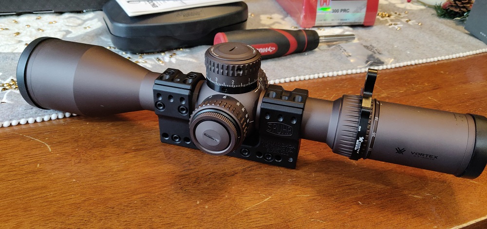

Vortex Razor HD Gen-II, H59 reticle FFP - Not much to say, this is a great scope in this price range with a great reticle.
Spuhr scope mount - This had an additional + 3 mil tilt to add to the + 6 mil scope base (NF Base). Also like the ability to add on other options if I later feel the need for something. One thing I like is the "send it" electronic level indicator and Spuhr sells a mount for it as an add on.

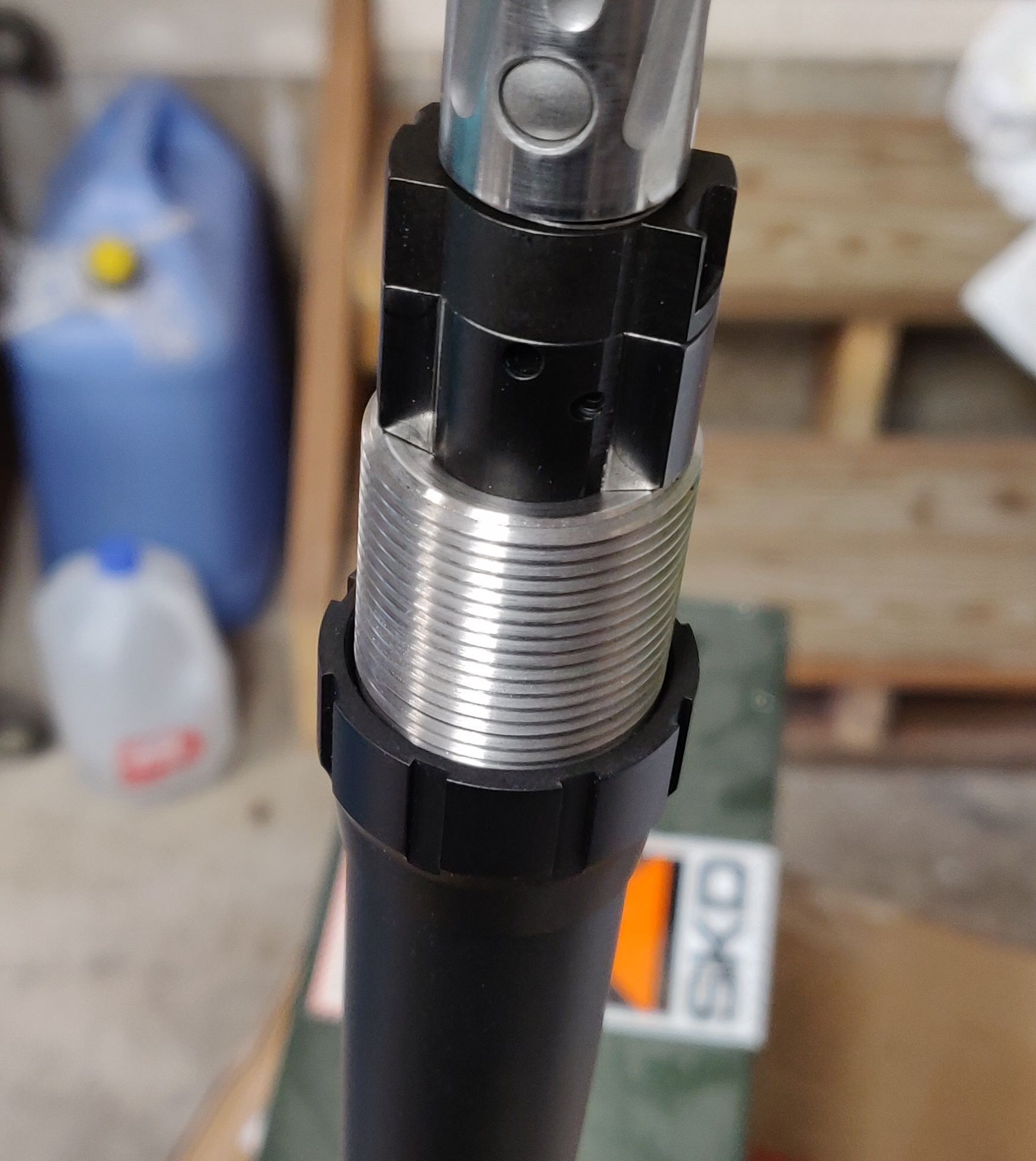

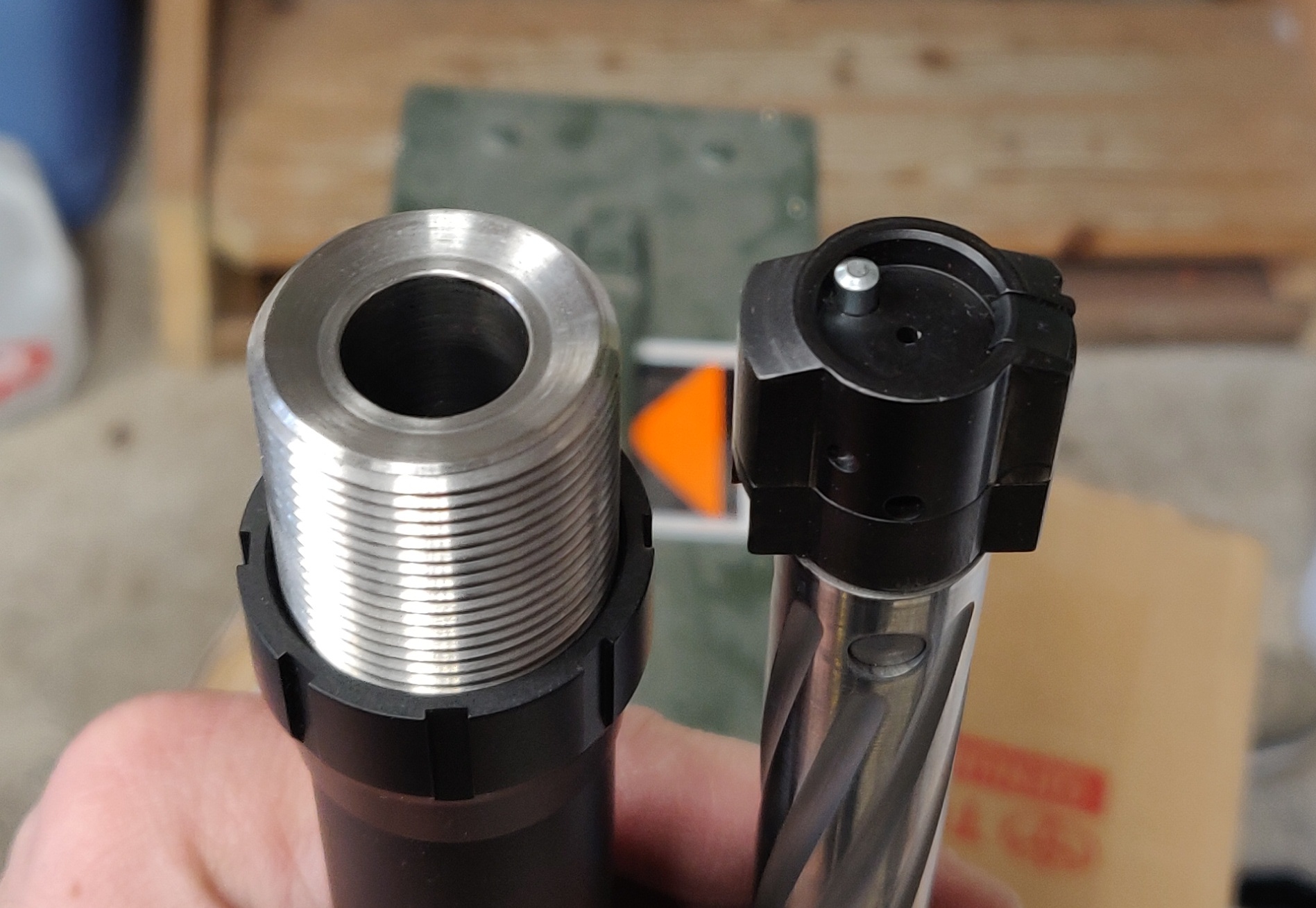

Hmmm may want to consult with a knowledgeable smith. The bergara premier has a coned bolt. To my knowledge, mixing a remage style chambered barrel with a coned bolt nose is a no no. This is why bergara rebarrel their actions and recommends NOT having a gunsmith replace a shot out barrel.
Thanks for the info. I will look into that.

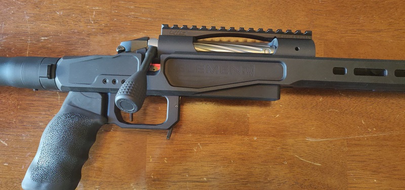

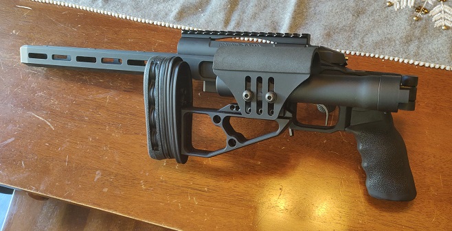

Well, it's been a long time. Some updates:
Was able to reach out to https://preferredbarrelblanks.com and have my barrel order updated to ensure fitment with the coned bolt face of the Bergara Premier Action. Thanks to @khuber84 for the insight to get this checked for fitment.
So here are some pics.
