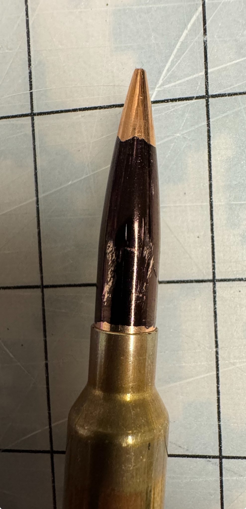

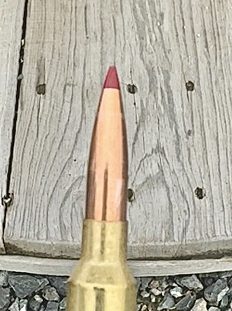

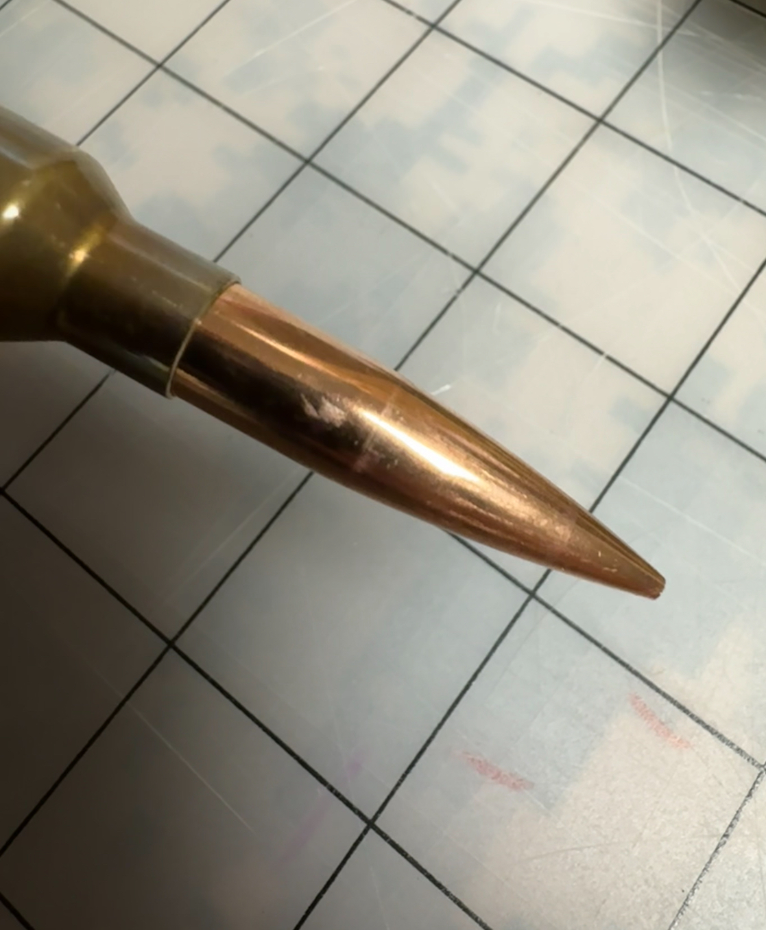

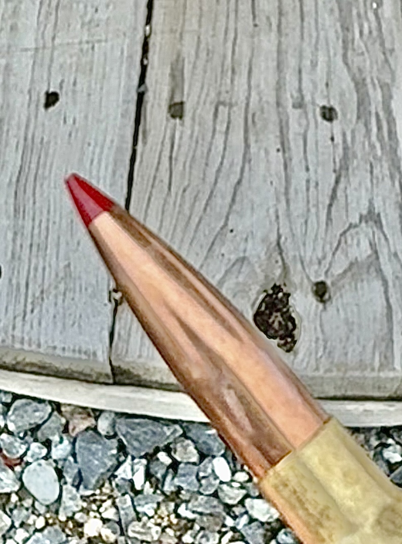

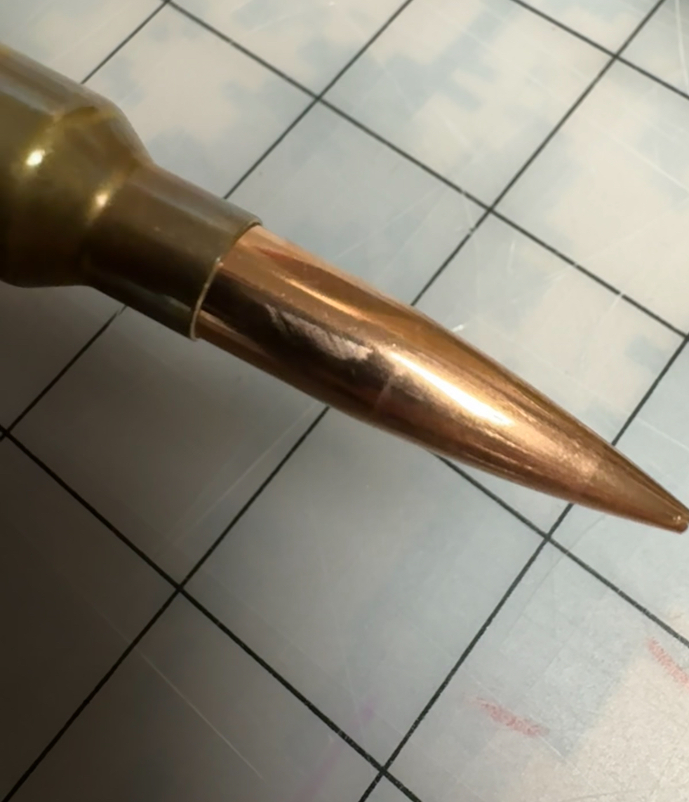

I’m wondering what is wrong with my chamber, I’m seeing rifling marks almost back to the case with factory ammo. “212 eldx” I have tried developing a load multiple times And am getting very inconsistent results, pressure spikes and horrible accuracy. Using jam -20 to start load development the bullets are very difficult to eject -50 still sticky with the same marks.
I get the same marks on Berger 215’s

3 contact points leave a long mark and 2 leave a shorter square looking mark

The quality of the pics is pretty bad. So can't really see what kind of marks you're getting.

But it leaves 5 long marks on the bullets that look like rifling all the way around.
I can get them in and out of the chamber without trouble, but they all have the same marks, even when seating them .200 in from Jam point.

Borescope or make a cast of the chamber. Sounds like there's no freebore for some reason. Or freebore didn't completely cut out the rifling. That could be why it doesn't seat the bullet deeper when you jam....it's not full height rifling since it was partially cut.
If it doesn't, send it back to whoever chambered it and have it fixed. If that's not an option, can either have a saami reamer run into it or have it cut and rechambered.
I guess it's possible that it was cut with zero freebore with the intent to throat it for whatever bullet was going to be used. If the rest of the chamber is correct, you could also just use a throater and cut the desired freebore.

Looking at the photo where you blackened the bullet, it looks to me like the marks are on the bullet shank (the part that is .308 diameter) and the shank extends far out of the case. Am I seeing your photo correctly?

it is sticking far out in this picture, but the marks don’t go away until the bullet is seated way back. 1 and a 1/2 thou (.0015) of neck tension, .3065 is the id of the case mouth.

A build up of carbon is what was creating the rifling marks. They go away after a deep clean but show up after about 18 rounds. It shoots shots 5-25 at 1/4 moa then starts opening up. At 36 rounds the group’s will open up to 2 moa and the rifle needs another deep clean. Has anyone ever seen this before?

Who's barrel and who chambered it?
We've seen a few examples of worn out reamers, or rifle builders ordering reamers AT SAAMI MIN (then getting any amount of wear on them) cutting the throat under SAAMI min (.3085") and it net results in rifles that are extremely sensitive to carbon fouling.
