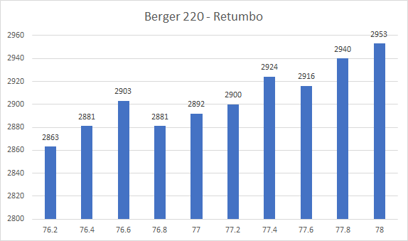

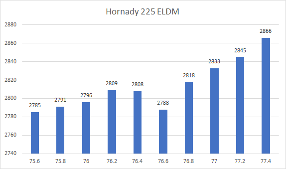

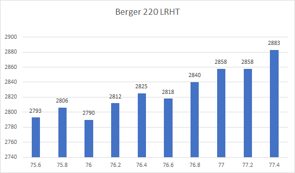

    So guys ... here's what I got in my 76.2-to-78.0 Ladder Test. I started seeing very light pressure signs about halfway through. So if I loaded a group test at 76.8 and get tight groups, am I "done"? For 300-PRC, is close to 2900-ish for Velocity acceptable to shoot out to a mile or so? Any advice is appreciated. I'm just not sure what an acceptable velocity is for 300-PRC ...
    Well, you know the top and bottom of the pressure window. My humble advice is to start load development now. As always with hand loading, you're as done as you want to be.
    At 2900 fps a 225 eldm stays super until 2200 yards....... Think you are going to be good buddy
    At 2800 it's like 2075 iirm
    Then that's the plan ... load to the charge weight just before the pressure signs, look for velocity in the high 2800's, with single-digit SD's and tight groups ... and then declare victory and go to the long-distance range to see if I can hit a mile target with my 300-PRC MRAD barrel. Thanks for the help guys. I've got great load data and terrific results with 300-WM and 6.5-CM, but this is my first time handloading 300-PRC.

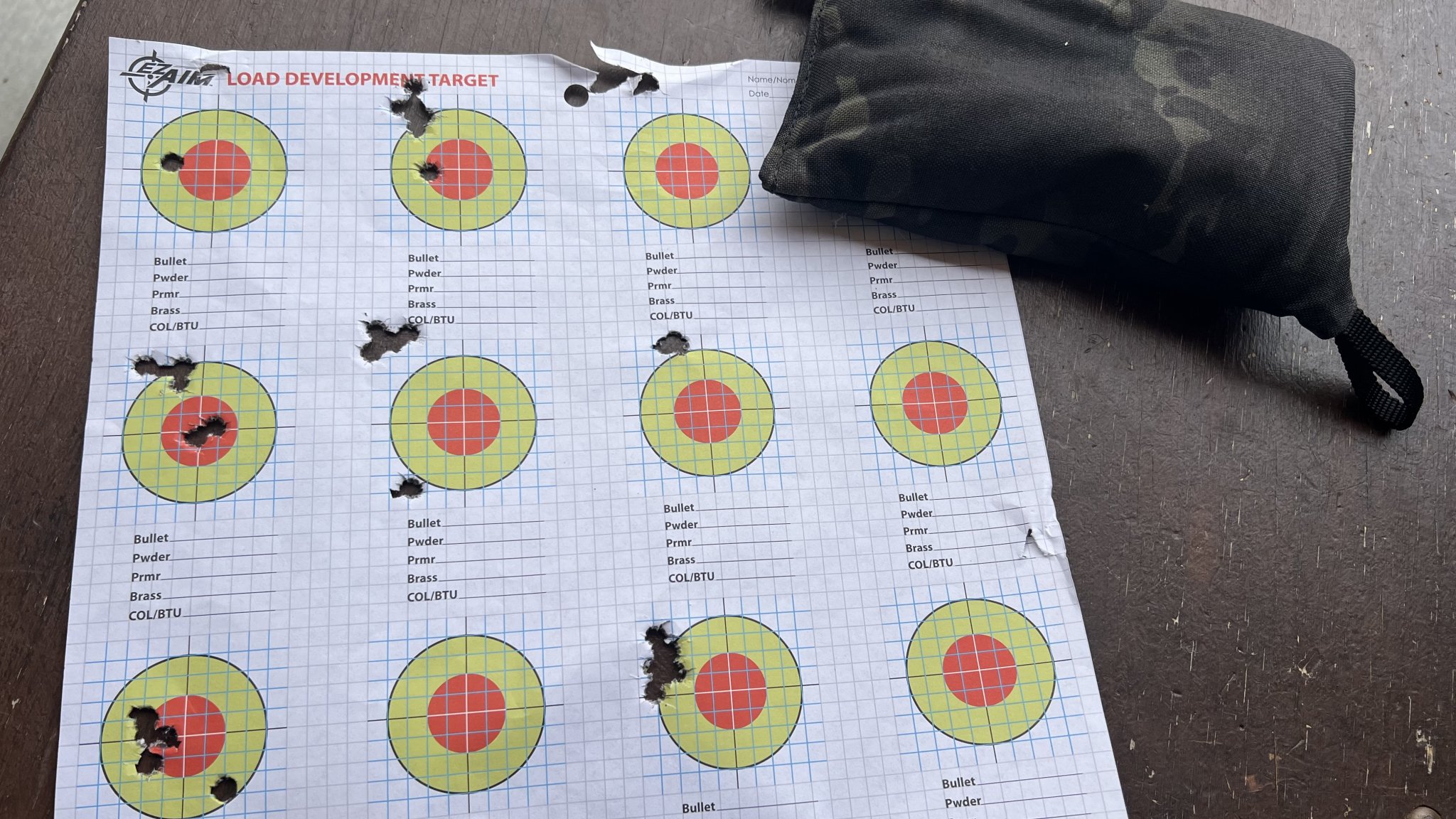

    Curious but do you have pictures of the targets for the other 43 rounds? If r where they not this load?
    Here is the picture
    Some of the shots were used for sighting in the scope on a different target
    My friend who is inexperienced shooter shot the first 2 columns on the leftbut anyway the worst group excluding flyers are around .7-.6 inches

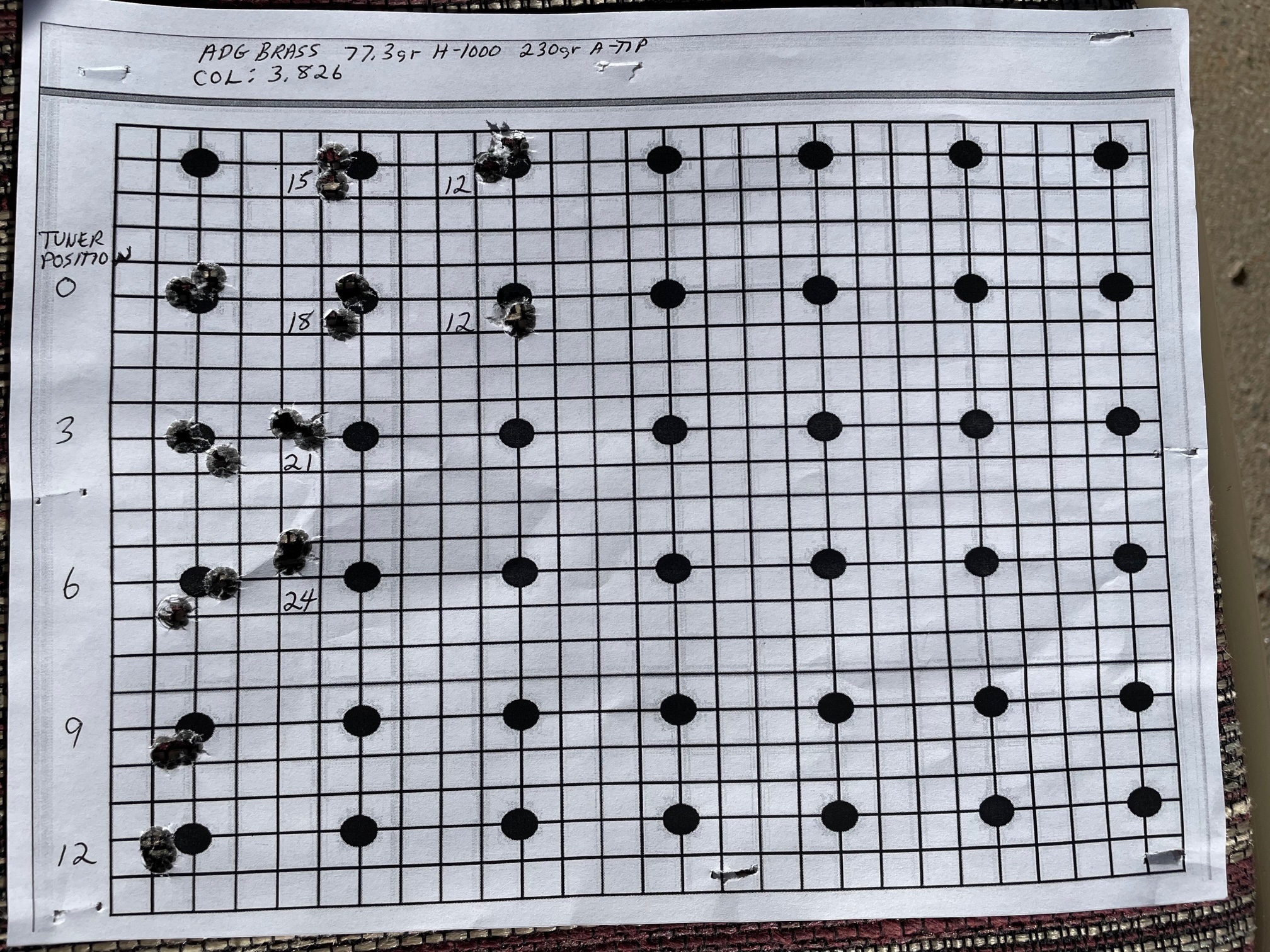

    Made it out to the range today. Loaded up 40 rounds with 77.3 gr of H-1000. Loaded long and had to single feed each round.
    Bartlein 30" 1:9 twist
    Virgin ADG brass
    Hornady 230 gr A-tip
    77.3 gr H-1000
    CCI 200 primers
    COL 3.826"
    Jump 0.015"
    Barrel looks it was still speeding up with 110 rounds down the pipe. Getting around 2865 FPS now.
    Barrel tuner test target. Looks like tuner in position 12 is dead nuts. Two shots at each dot.
    Reactions: Max_The_Phoenix

    I'd be cautious using this 2 shot test. Below I've taken all three groups labeled number 12 and put them on a single target.
    If you take the aggregate dispersion, you'll find that tuner settings 0, 3, 9, 15, and 18 would all find themselves inside this aggregate group size.

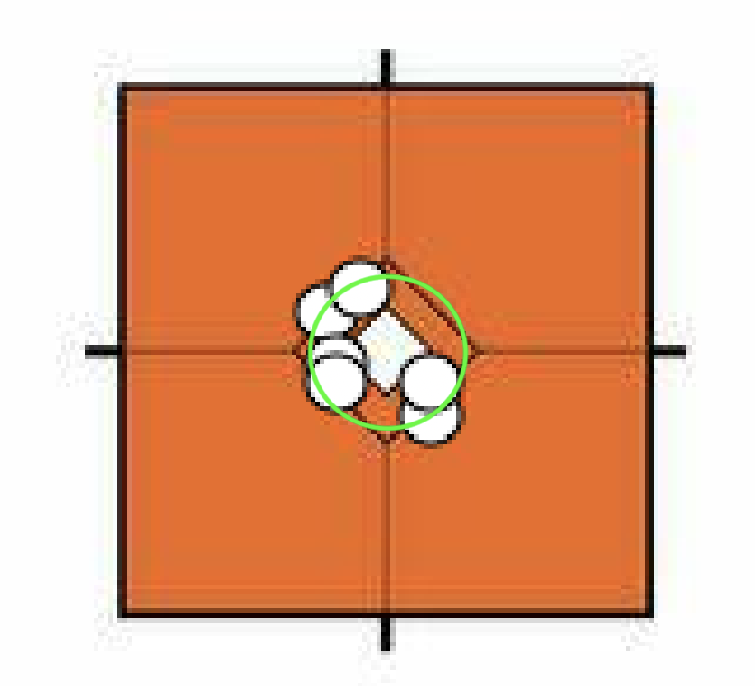

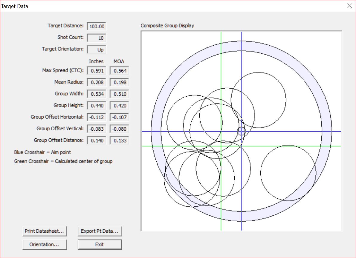

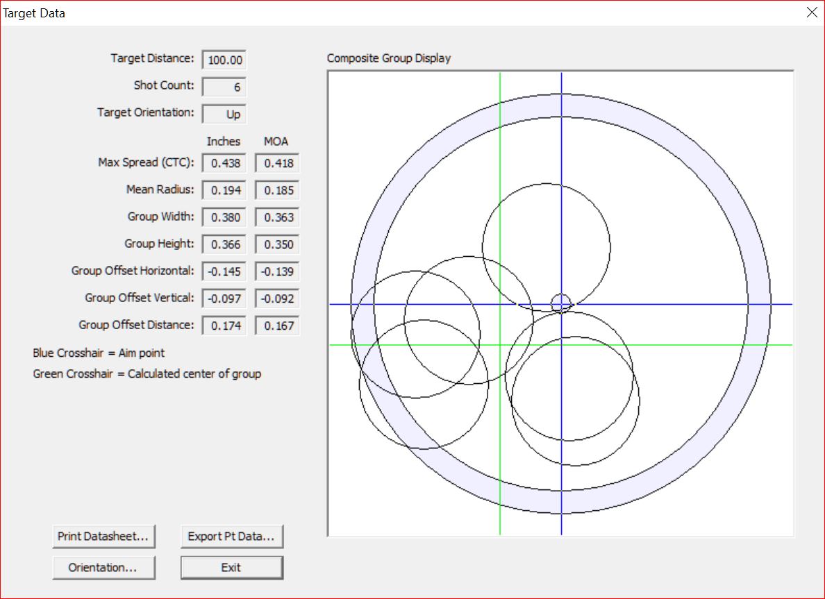

    I used OnTarget to map the groups you specified. I do see your point and I will be doing multiple 5 shot groups to verify load and tuner settings. Below is what I came up with for the two composite groups per your suggestion.
    Composite group with tuner set to 12:
    Composite group using tuner settings 0, 3, 9, 15, 18:
    Awesome.
    That will help you sort out the noise. Not knocking the tuner or anything else. Just easy to chase our tails if we don't look at big picture.
