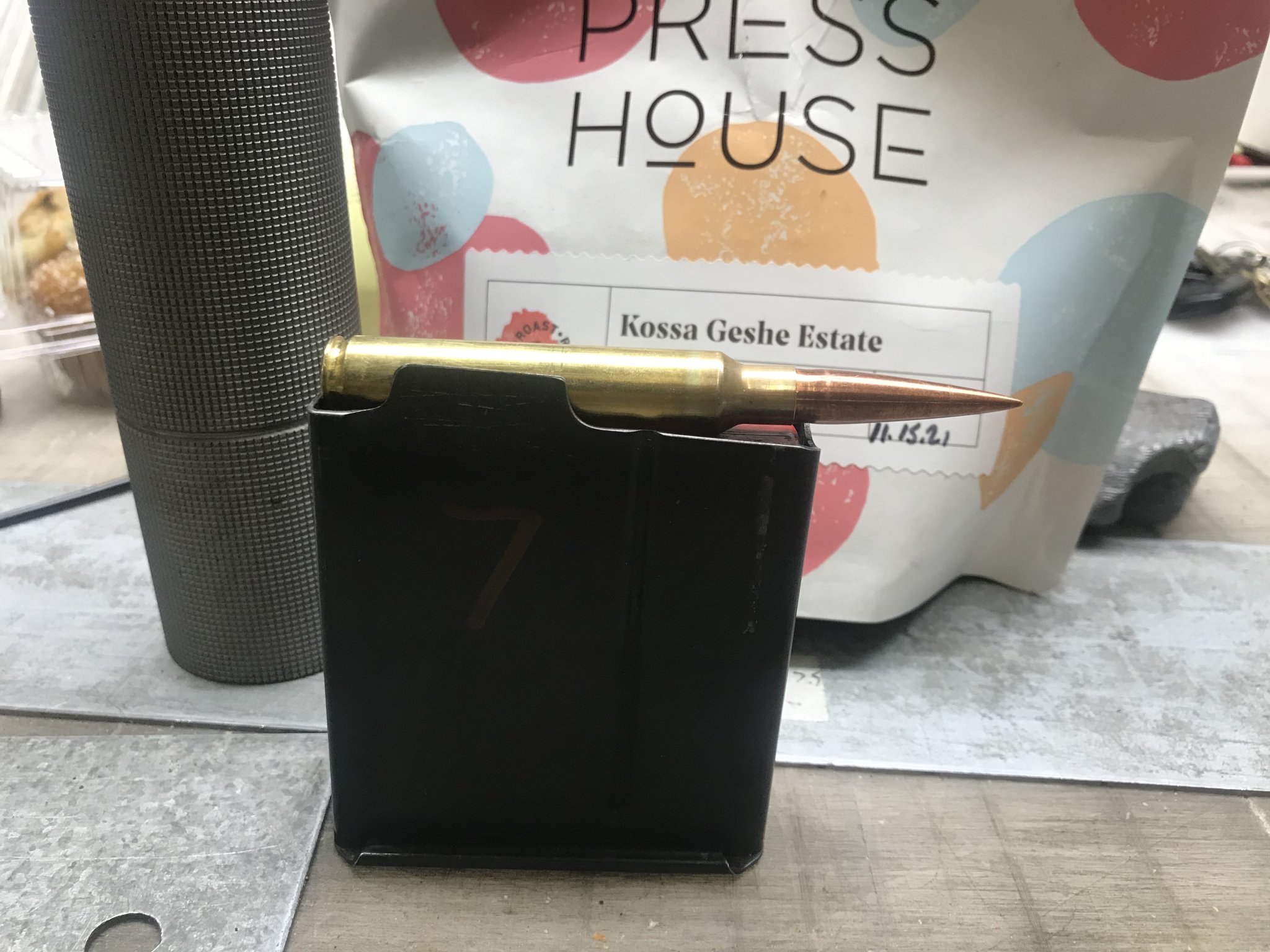

As others have already noted, if you make your own loads for 300WM and you have a long enough mag feed (or single feed) then 300PRC is not a significant upgrade over 300WM. However with factory rounds, 300PRC is a big upgrade over 300WM.

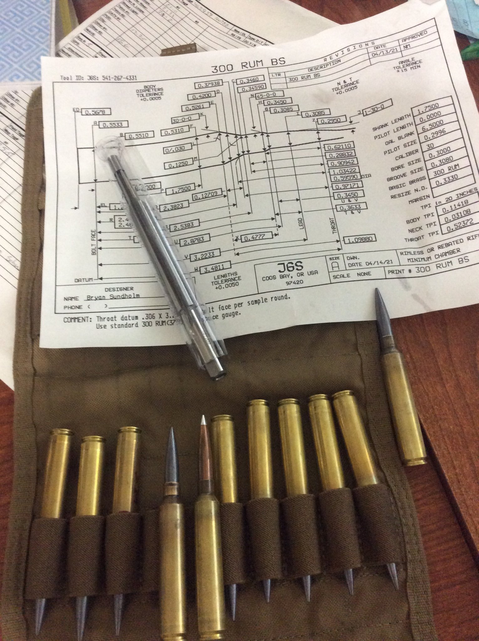

Is there a specific reamer you all are using for the RUM that allows the 245 / 250s to be seated so long? Thanks
It is a custom match chamber reamer with the throat set to allow the bullet base to sit at the neck and shoulder junction of the case. You can use a throat cutter also to set the length, but it may not have the alignment you need for Ultra long range performance. >2.5k

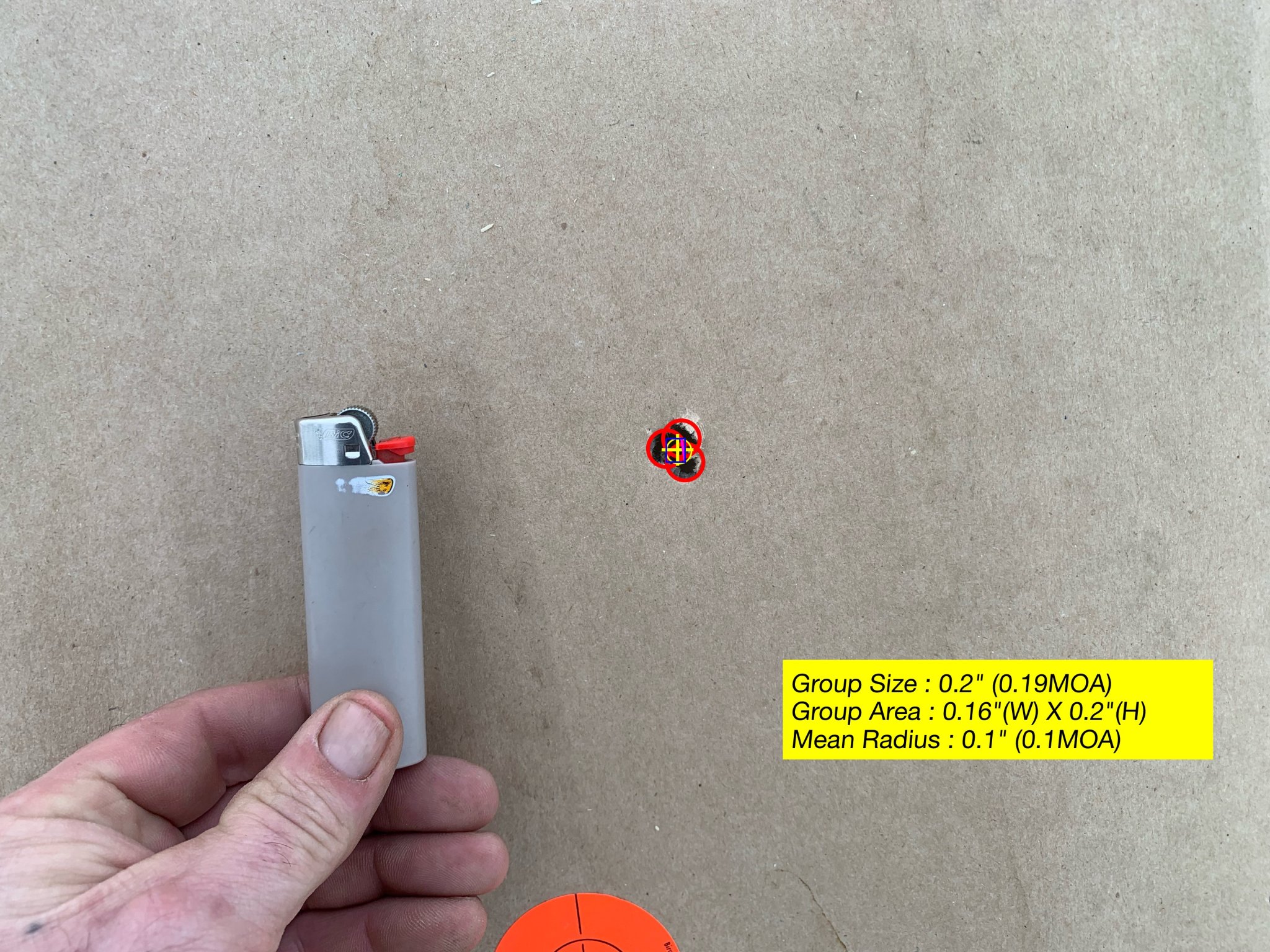

28" Krieger 10 twist here and 220 LRHT's @3170 fps from 93 grains 8133 and 3.94 COAL (15 off). 10/10 on 3" steel @ 460yds is typical when I'm on. 8-9/10 on 5" steel @910yds when wind cooperates.
