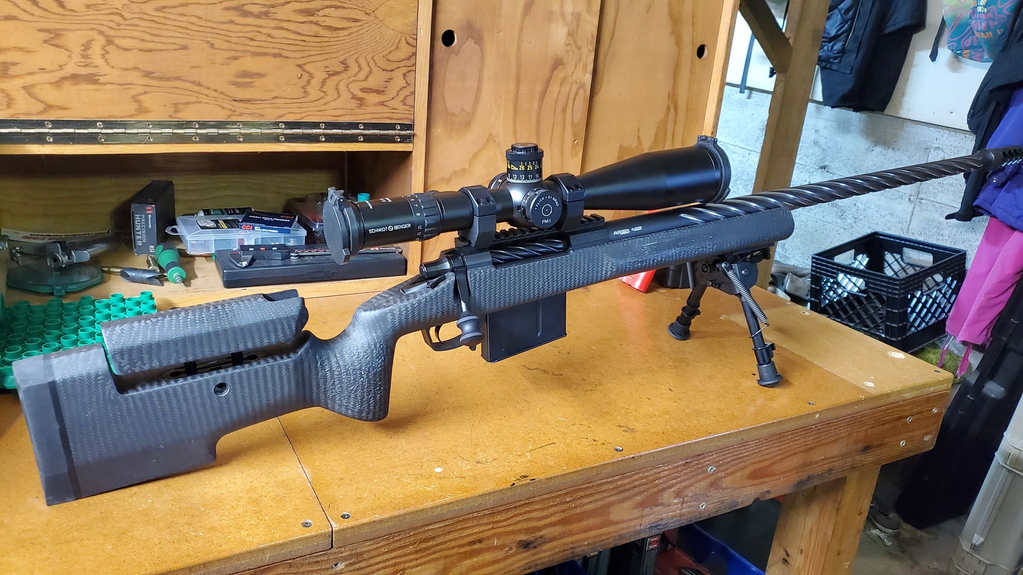

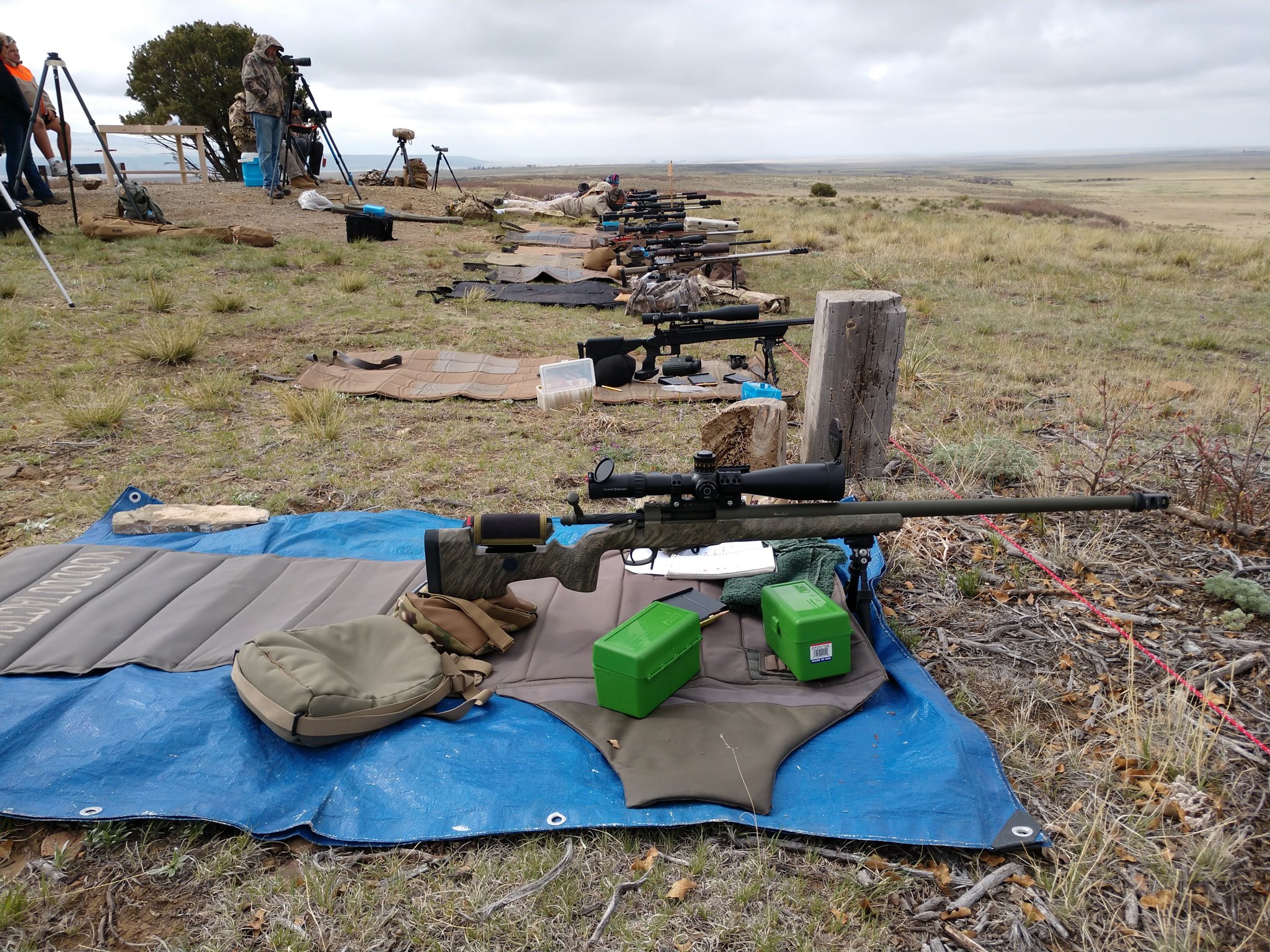

Why not a 30 Nosler? Here's my 30 Nosler, after hitting a 1-moa target at 1-mile with one shot. Bonus target at the end of the match, and I did it again a month later (ELR match in Raton NM).
I had the same rifle built previously as configured in the picture in 338LM, and now wish I didn't go with the 338LM on that build (and not my first 338LM either).
Looking at the ballistics, my 30 Nosler shooting the Berger Target Hybrid 230's, will go another 120-yards before going transonic comparing it to the 338LM using the Berger 300's.
as far as barrel life, I'm yet to experience that. I will say that about 10-years ago, I was talking with a Sako rep about the TRG's. We got on the topic of barrel life (TRG-42/338LM). He told me the Finnish Defense Forces change the barrels out at 3K rounds, regardless if it's still shooting sub-moa. He told me they don't often have to change a barrel out below the 3K mark.

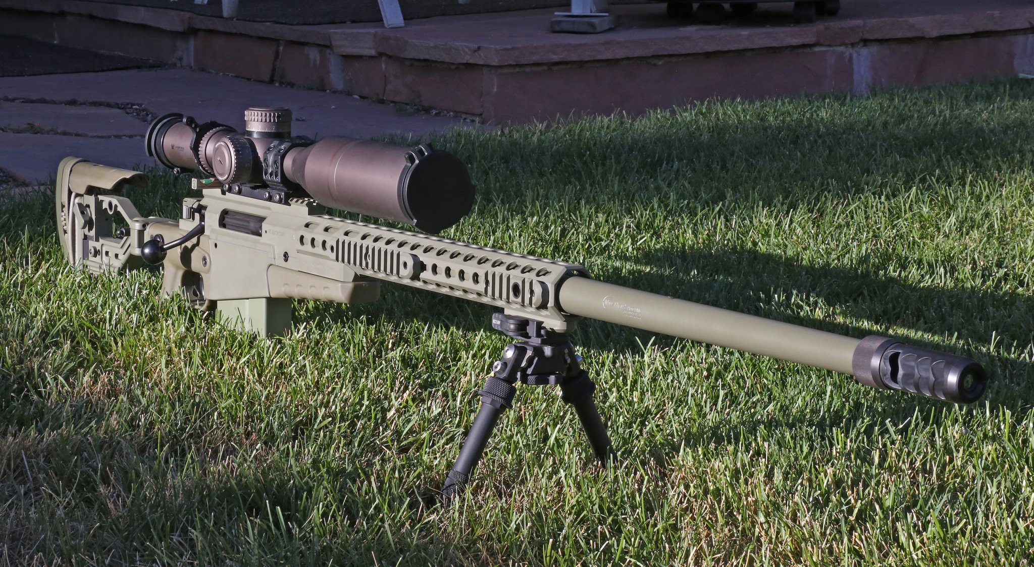

My Rifle Spec;
Defiance Rebel
Bartlein HV 5R 9-twist @28"
XTSP Mod 22
McMillan A5
Badger M5
Near Alpha Mount
SB 5-25 MSR
TB Ultra Brake
Beanland built.

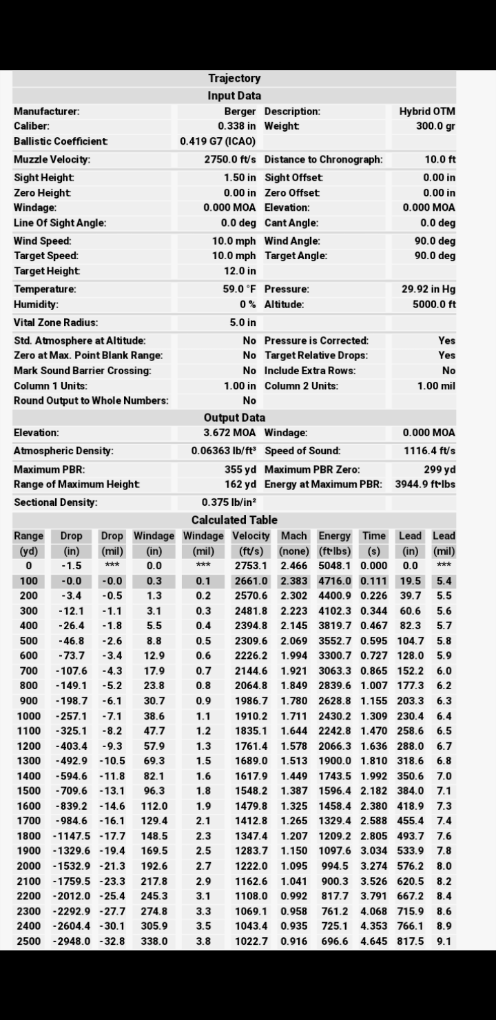

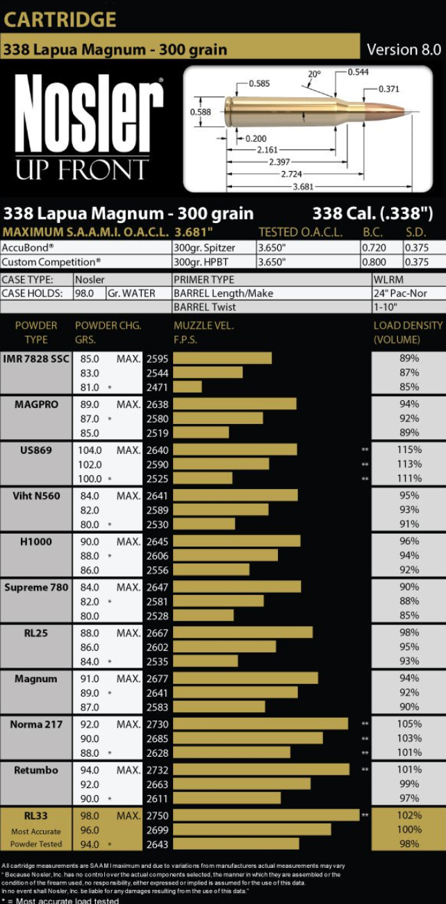

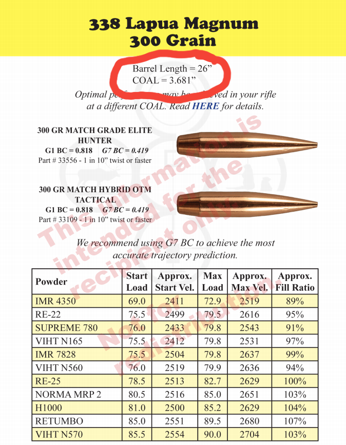

Is it possible to use a rifle chambered in 300 PRC (9 twist, 26-28” tube) to safely launch the 230 Berger at 3,000 feet per second, assuming a D/A of ~5000 feet?
If so, when plugging numbers into Shooter for the .338 lapua magnum (300 otm Berger at 2750 feet/sec) and the above mentioned PRC load, Shooter tells me the PRC goes subsonic at 2150 while the Lap Mag goes subsonic at 2100...energy is 859 lbs for the Lapua while the PRC load has 651 lbs. Lapua mag goes subsonic at 2200 if muzzle velocity is 2850; energy is 863.
Similar performance; 338 lapua has the energy advantage but not a huge disparity.
Assuming one can get 3000 ft/sec from the PRC while considering the marginal cost of shooting the .338 along with trade offs above are valid in terms of my numbers, I’m thinking the PRC may offer the best overall value.
338 LM AI is a game changer to your 300 PRC and it will shoot factory 338 LM accurately. If your looking for cheap factory ammo stick w the 300 PRC. How are your SD/ES numbers w Hornady ammo?

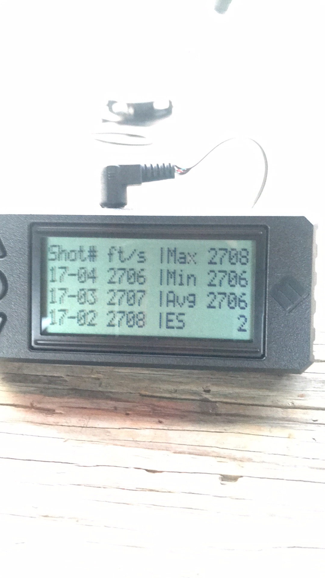

Exactly. That price is just unrealistic for high round count shooters. If one has to spend that much on brass to get what they need or want then they need to look into a different caliber/chambering. Benchrest - go for it.

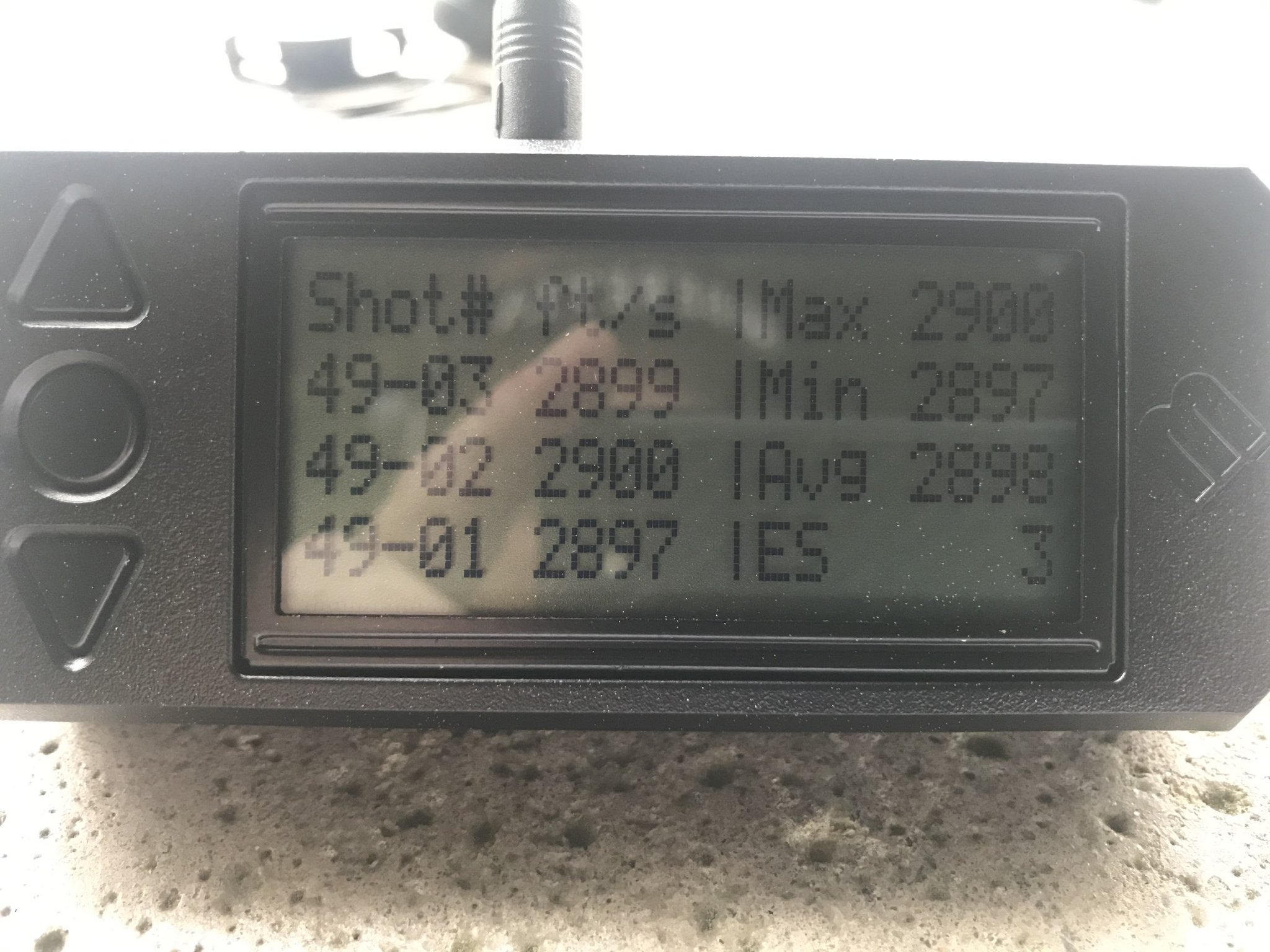

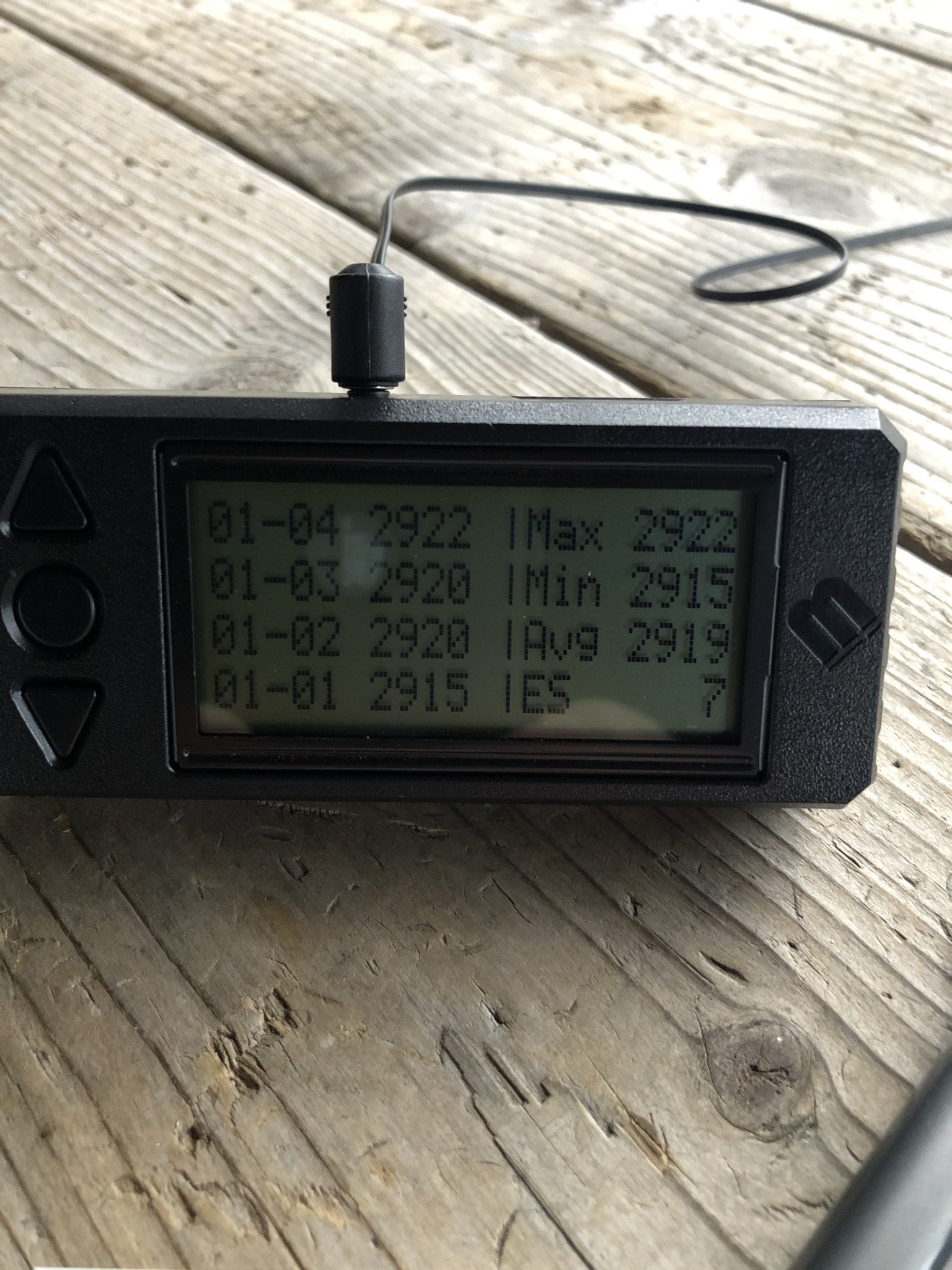

Like an ES of 9 on the first firing. ES of 6 after that. Single digits and it groups - load development done! Lapua has been holding true for quite a few firings now pushing 225 ELD-M’s at 3006 fps. I have a higher node at 3105 fps but with a mild bolt lift and semi-flat primers... Not worth the barrel torture.

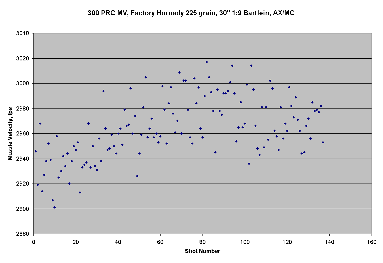

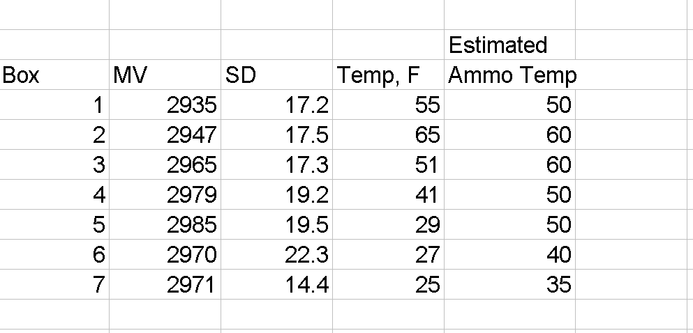

I'd think you could get close to 3000 fps with handloads. Below are the first 140 rounds through my 300 PRC so the barrel still might speed up a bit. All are factory Hornady 225 grain ELD-M and were shot across 3 days. I used a Kestrel to get the ambient temperature data but the ammo temperature estimates are an educated guess. Day 3 was 60 rounds as a cold front was moving in, thus the ammo temp drops.

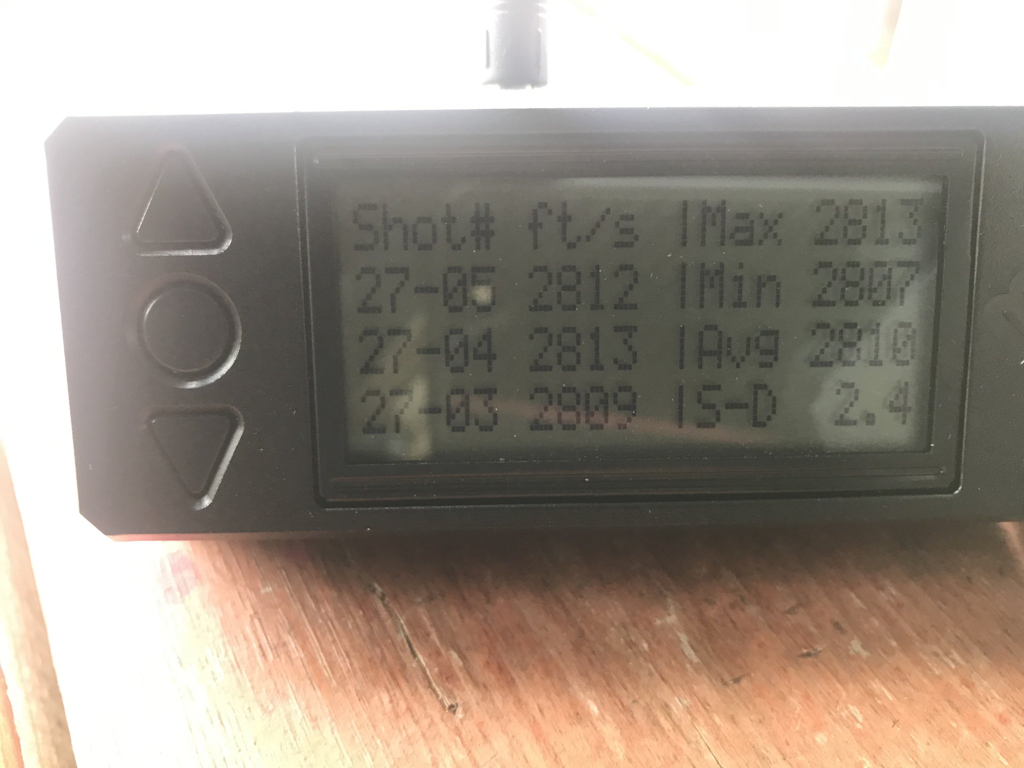

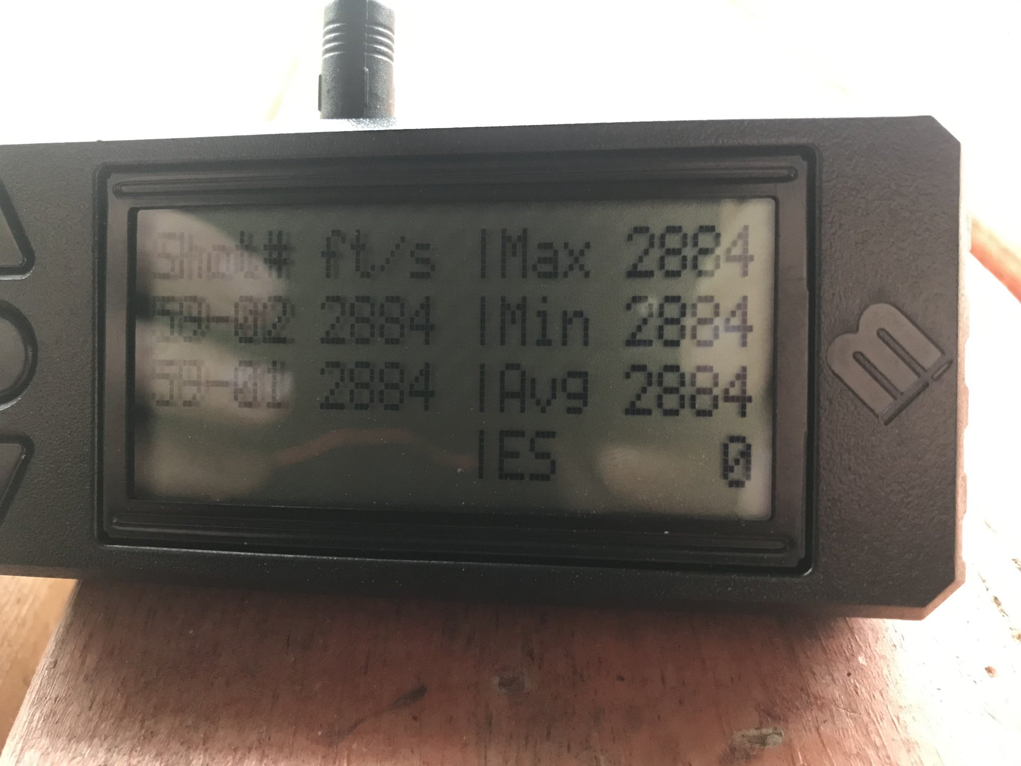

Just some quick loads thrown together on a Chargemaster 1500 in Alpha brass. RCC gonna net me any improvements here, @LakuNoc ?

Meh Just some quick loads thrown together on a Chargemaster 1500 in Alpha brass. RCC gonna net me any improvements here, @LakuNoc ?
Good information, @TripleBull. Thank you for the data...

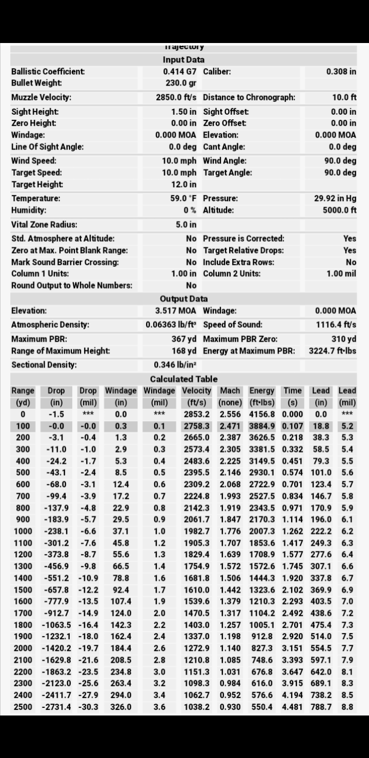

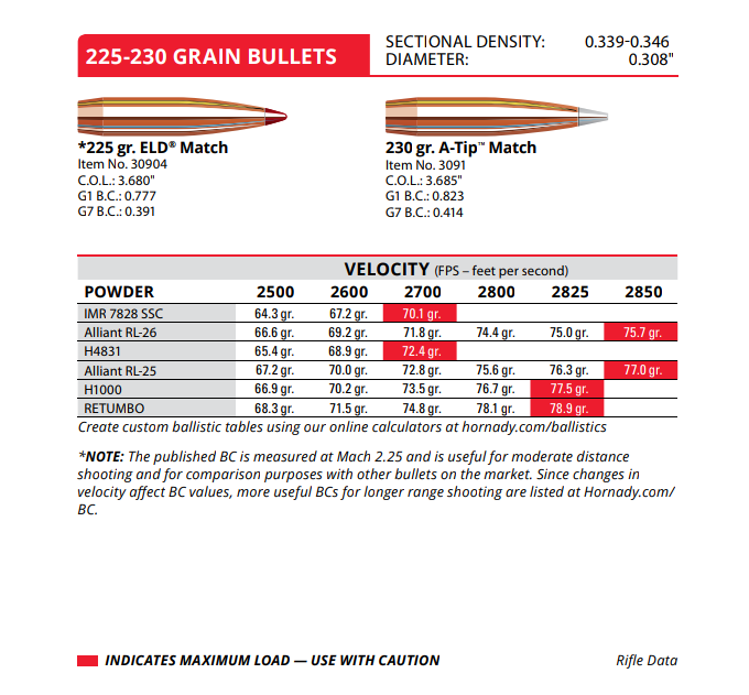

Assuming a 3-5% drop off in MV for the 230’s extra 5 grains and another 50-75 FPS reduction if a 26” barrel is used vs a 30” (I prefer barrel lengths on all my rifles at most 26” at most for personal preference reasons) thinking the PRC’s realistic velocity expectation for me is prob somewhere between 2800-2850ish....at that velocity, Shooter has it going subsonic at 2000 yards...
With a 30” tube, which would be the correct barrel length choice for the OP’s use case, one would still have to get those 230s really moving out of a PRC chamber to hit 3000k safely. Still a good performer with potential to make consistent hits at or slightly beyond 2k but prob runs out of enough steam to make performance at 2500 questionable.
Outside the scope of the original question but if someone wanted a ballistically predictable round that can consistently hit targets between 2000-2500+, something like a 338 Edge/ AI or a chamber in the 375+ class should be selected vs 300 PRC or 338 LM (375 Cheyenne Tac comes to mind).
Reactions: TripleBull
I was partly basing on data posted here:
So LakuNoc's getting ~2940 with the 230 A-Tip and reports no pressure signs. IIRC, he's shooting a 26" Proof barrel. Then again he's using RCC brass and probably sold his soul to the devil.
B2lee is running 230 ATips at over 3K out of a 28" Bartlein.
Anyway, I'd think you'll be in the 2900-3K range depending in part how hard you're willing to push your luck. I'd rather not push mine so I lug around that heavy, long barrel. I'd really like to someday have a 416B with a 40" barrel but then I'd need an assistant to get it over to the shooting mat.
230 grain A-Tip BC G7= .414
225 grain ELD-M BC G7= .391

I don’t push my luck either and stop increasing the charge weight as soon as I notice .001 case body expansion (I measure the body just above the extractor grove of the unfired and again after the case is fired).

I forgot to mention, all those chronograph readings are after multiple firings and multiple salt bath annealings.

#3. 300 PRC outperforms 338LM.
Here's ballistics for a 24" barrel 338LM with 300gr Berger VLD's using posted velocities from Nosler for 300gr bullets with 24" barrels at 2750 fps. If any 338LM guys are going to be upset by this comparison take note that I could have used Berger's posted load data but that's only 2700 FPS from a 26" so I'm using Nosler's.
The 300 PRC is also from a 24" barrel and velocities are Hornady's posted load data using 230gr A-TIP's at 2850 FPS. To keep things fair I'm using posted load data from major manufacturers on both not any individuals claimed numbers.
Both are ran at 5000 ft/alt
Note that 300NM is about 50-70 FPS faster than 300 PRC and that's something but it aint much in the grand scheme of things. Then you consider that 300NM is more expensive to load for and it doesn't have affordable bass cased ammo. I know 300NM guys are playing up the Lapua brass which 300 PRC doesn't have but you have to look to the future Lapua will get forced into 300 PRC just like they were forced into 6.5 Creedmoor. If you want to make money selling brass then you've got to sell brass in popular calibers and 300 PRC will soon be more popular than 300NM if it isn't already.
338LM top
300 PRC bottom.
The 300 PRC has less drop, less wind drift, slightly more supersonic range and 338LM's energy advantage at ELR ranges is not much the difference in spotting shot here is probably more or less a wash. Also this was using 230gr ATIPS rather than the 250gr ATIPS because Hornady's posted load data for the 250's tops out at 2700 FPS which seems strange to me that they 2850 FPS for the 230's but only 2700 FPS for the 250's. It's also good data point to note that the 230gr ATIPS $0.10/ea cheaper than the 300gr VLD's.

Note post edited to include load data from manufacturers since it was suggested that I had "optimistically fudged the numbers in favor of my favorite" although no explanation of how was given.
Notice that Berger's load data for the 338LM gives a max velocity of 2700fps for the 300gr VLD but this is with a 26" barrel (Hornady's load data is for a 24" barrel) this could be because the 300gr VLD is longer than Nosler's 300gr bullets and thus leaves less room in the case for powder. I actually used Nosler's 2750 fps for 300gr pills in 3338LM on the charts in the comparisons above to give 338LM the best velocity possible based on actual manufacturerers load data for both cartridges and not considering any individuals claimed velocities. Thus note that with 338LM this comparison is made are using one manufacturer who makes a higher BC bullet and a different manufacture who posts the highest velocity but with a different bullet.
