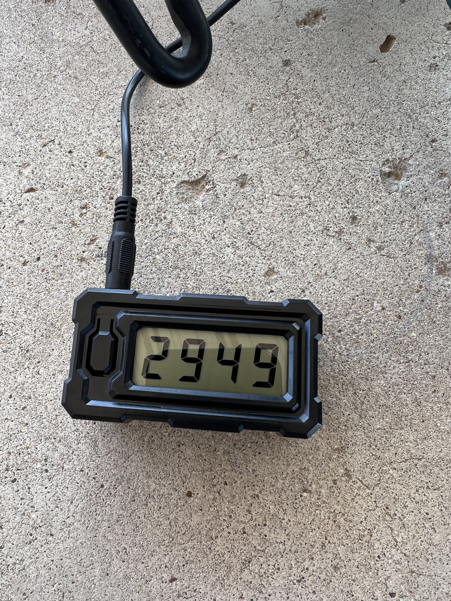

Retumbo 78.3
Hornady brass
Federal #215 primers
212 EDLX
Tiny bit of pressure
26” carbon wrapped barrel 1:8 twist
