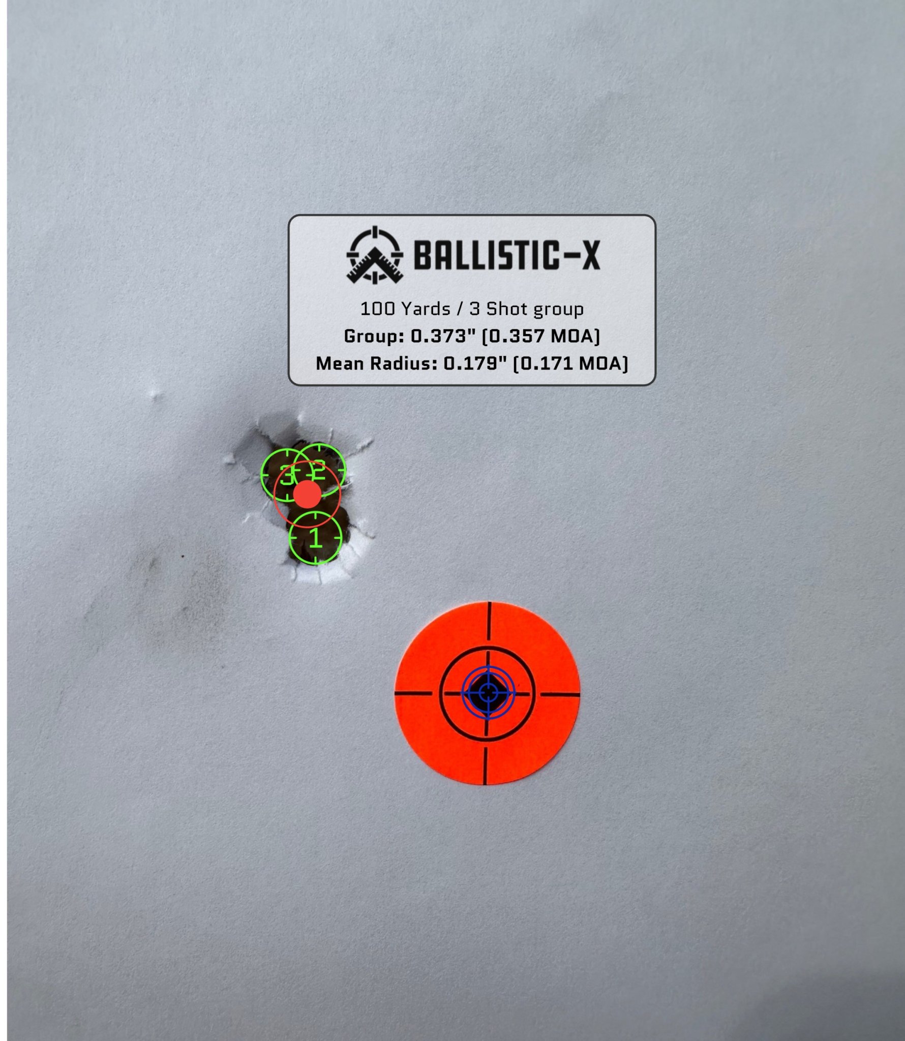

Velocity: 2975
SD is a disappointing 12 over 5 shots. Was just a random load and about .030 jump. Just testing waters with N565. Have been using N570 with very good results.
The other two shots are in there. Just got lucky they went through the larger hole the first three made.

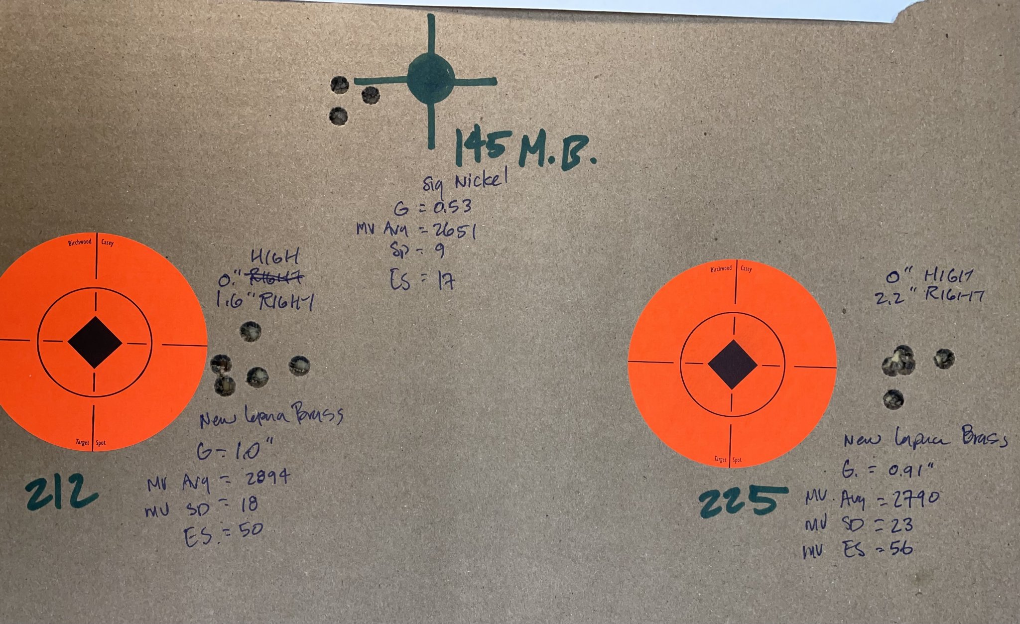

strange stuff with my 300PRC. these loads with new lapua brass clocked in 90 fps slower that the (mostly) equivalent loads with Hornady once fired brass. i did nothing to the new brass. i figure lapua knows how to sell ready to load brass. the seating operation was a shitshow. waaaaaaay tooooooo much force required.
anyway, the 1" groups were acceptable to me but the velocity metrics are not. the lapua brass is 5% larger in volume. reddit hive suggested the volume increase was biggest contributor to velocity drop. i'm too inexperienced to have developed instinct. I've since hit all the remaining virgin brass with a mandrel and will load out a new batch bumping the charge to get the velocity up and hope for smooth seating forces.
bottom line, i need 100 for an upcoming ELR match and dont want to go back the 1.6" groups the hornady 1x brass delivered.

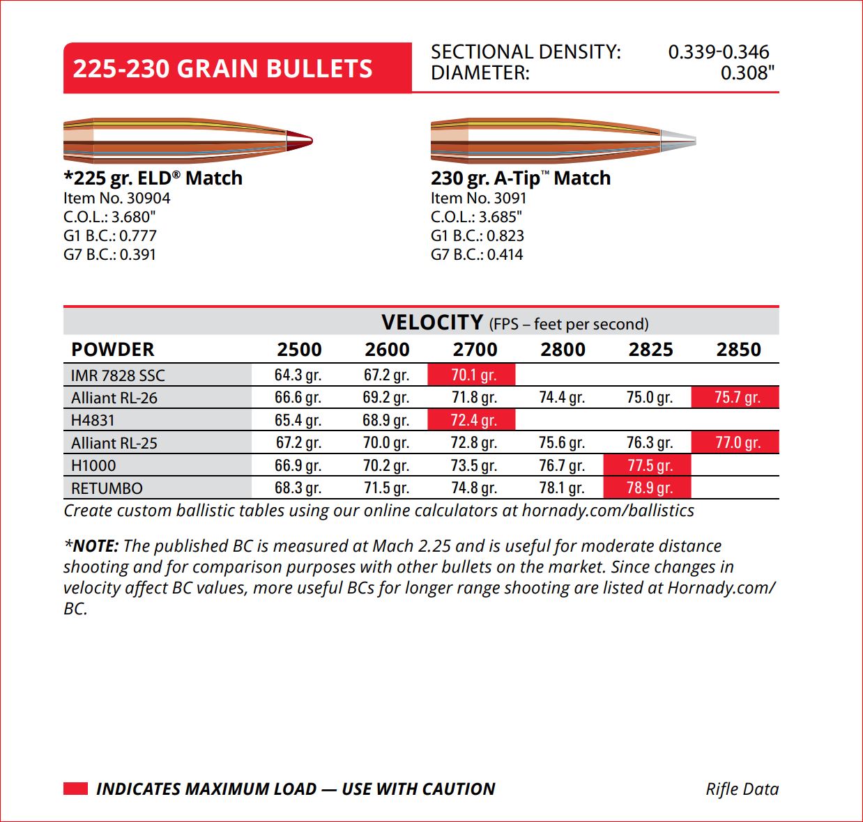

I have found the 300 PRC to be a very good shooting caliber. I've shot 225 ELDM's and 230 LRHT's using H1000, N570 and RL26. The barrel likes RL26 but it's been impossible for me to procure. My favorite Load so far is Berger 230 LRHT over 75.4 grains of RL26 20 shot average is 2891 fps with a 7.8 SD

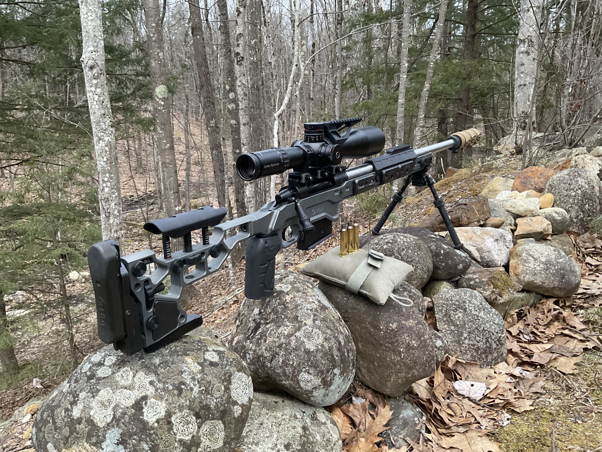

Rifle is an Origin Long Action with a PVA Osprey 26” M24 1:9T stainless barrel on it.
Load data is in the attached picture. The highlighted cells without data are simply because I have only run virgin ADG brass so far and haven’t resized to set the should bump or decide on a trim length yet. Load data for the dog is raw meat.
Velocity didn’t increase in the first 90 rounds, but SD actually tightened from 9 down to 6 (all on virgin brass). It isn’t the fastest load, but shoots super well at 0.4-0.6” CtoC groups @100yds, maybe a hair tighter if I am shooting well. Velocity was measured with a Magnetospeed and the suppressor on. Took the rifle out to 1100yds with no issues without truing velocity (I dont have easy access to 1300+ to true it anyways).
This rifle hammers at night. Since CNVD-LR and M2124-LR clip ons are actually rated to 338 Norma (confirmed when Barrett won the Mk22 contract), I have shot it with my CNVD-LR. I can’t recall what those rifles weigh, around 20lbs I think, and this is 26 unloaded. Only shot 500yds with it, but damn, the flash from the A-tip hitting steel was bright enough to see even without night vision.

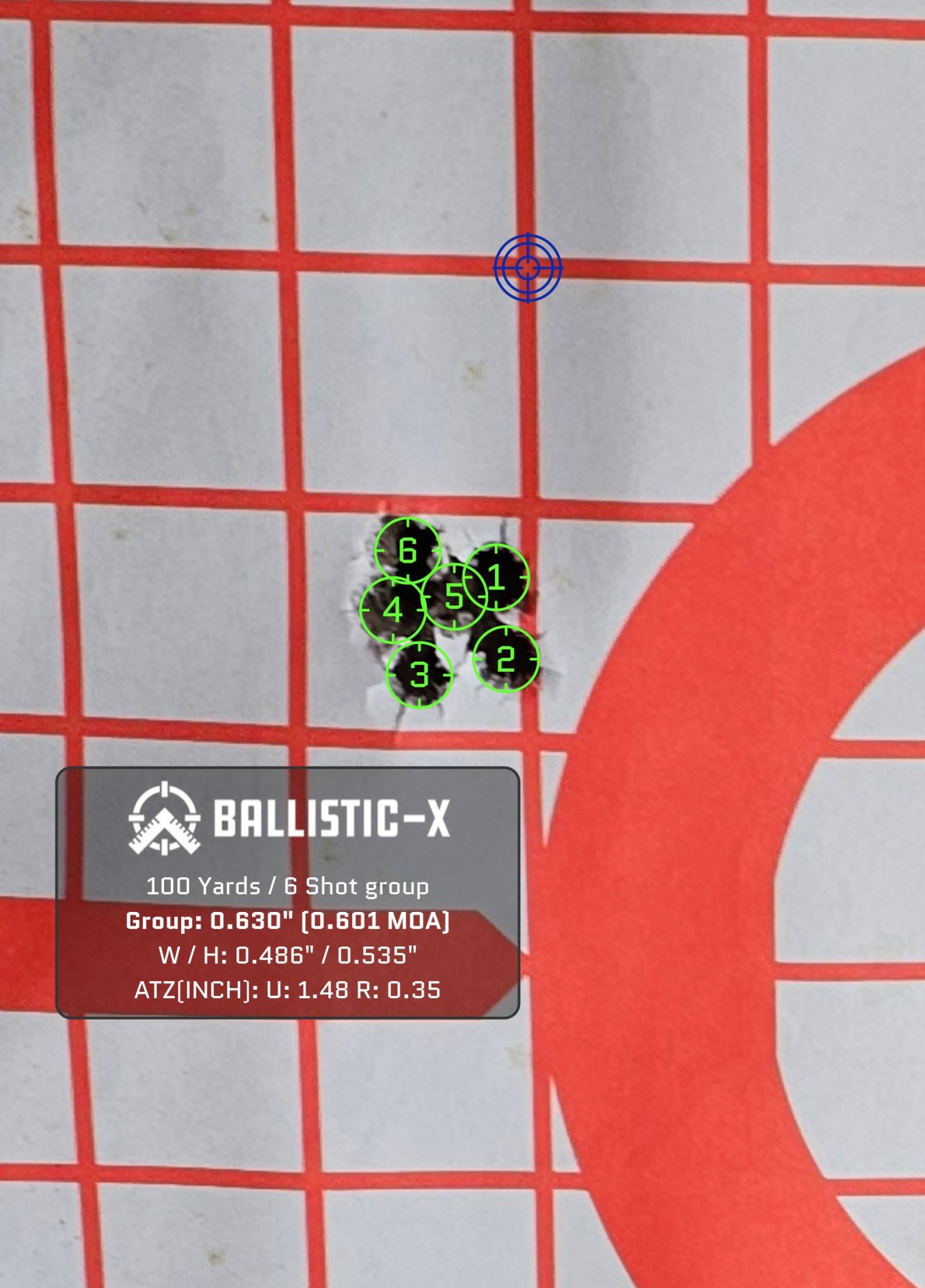

My quick ladder on the 190 LRX was
RL26 (Grains) Velocity (FPS)
77 - 2,794
77.2 - 2,835
77.4 - 2,826
77.6 - 2,862
77.8 - 2,890
78 - 2,874
78.2 - 2,926
78.4 - 2,949
I counted 6 holes here, for sure fired the 8 above. No other holes on the paper, so assuming / hoping 2 holes in holes. Held POA on the ladder in search of nodes...I think I found the really big node 😁

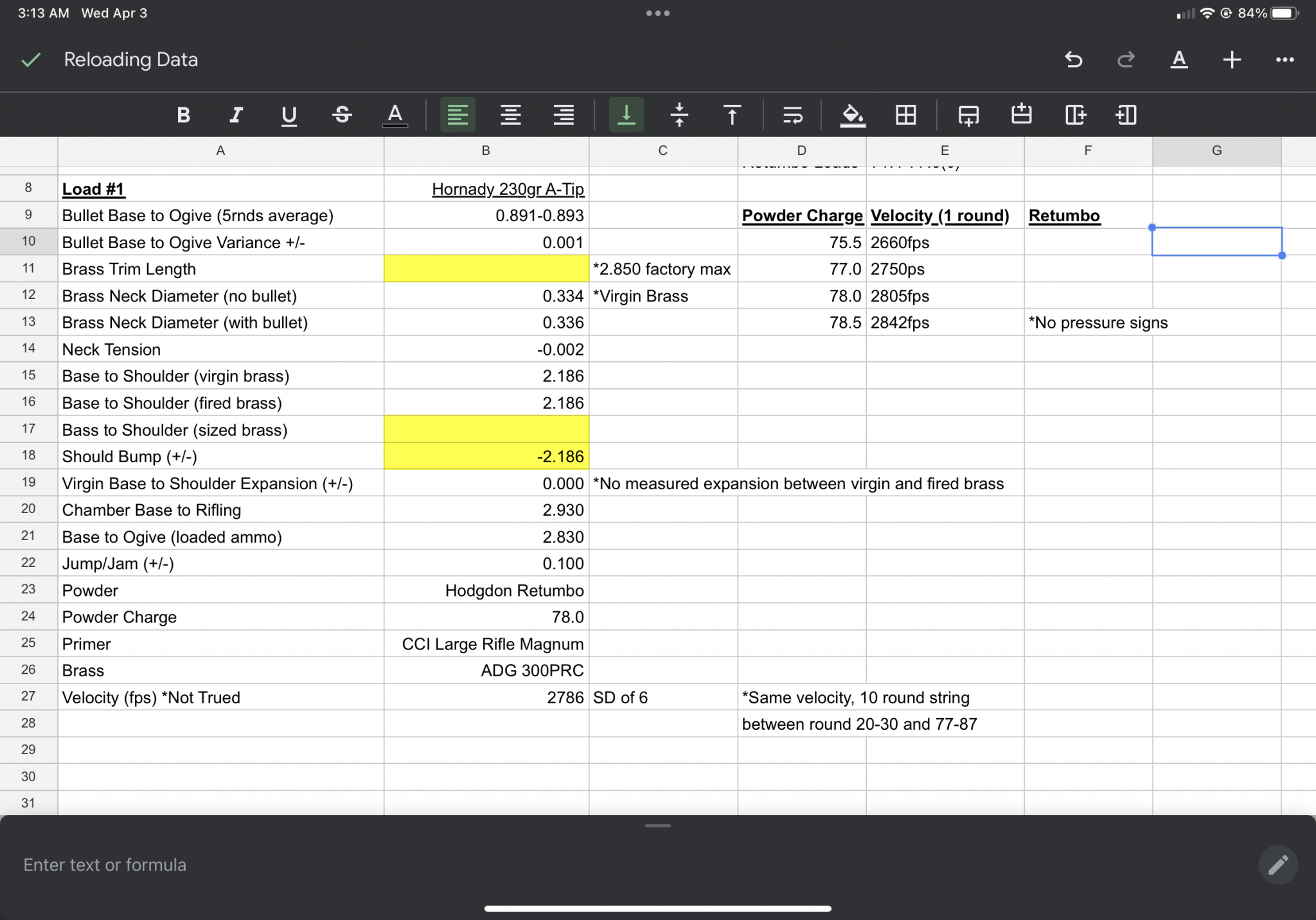

I tried loading 10x rounds of the 78.5 of Retumbo with the same 230gr ATip in the ADG brass.
I got 5 in and knew it wasn't as good. Velocity jumped to 2846fps (no pressure signs) but SD in just that string went to 21. Not gonna work. Accuracy opened as well.
Sticking with 2790fps and the node it's in.
