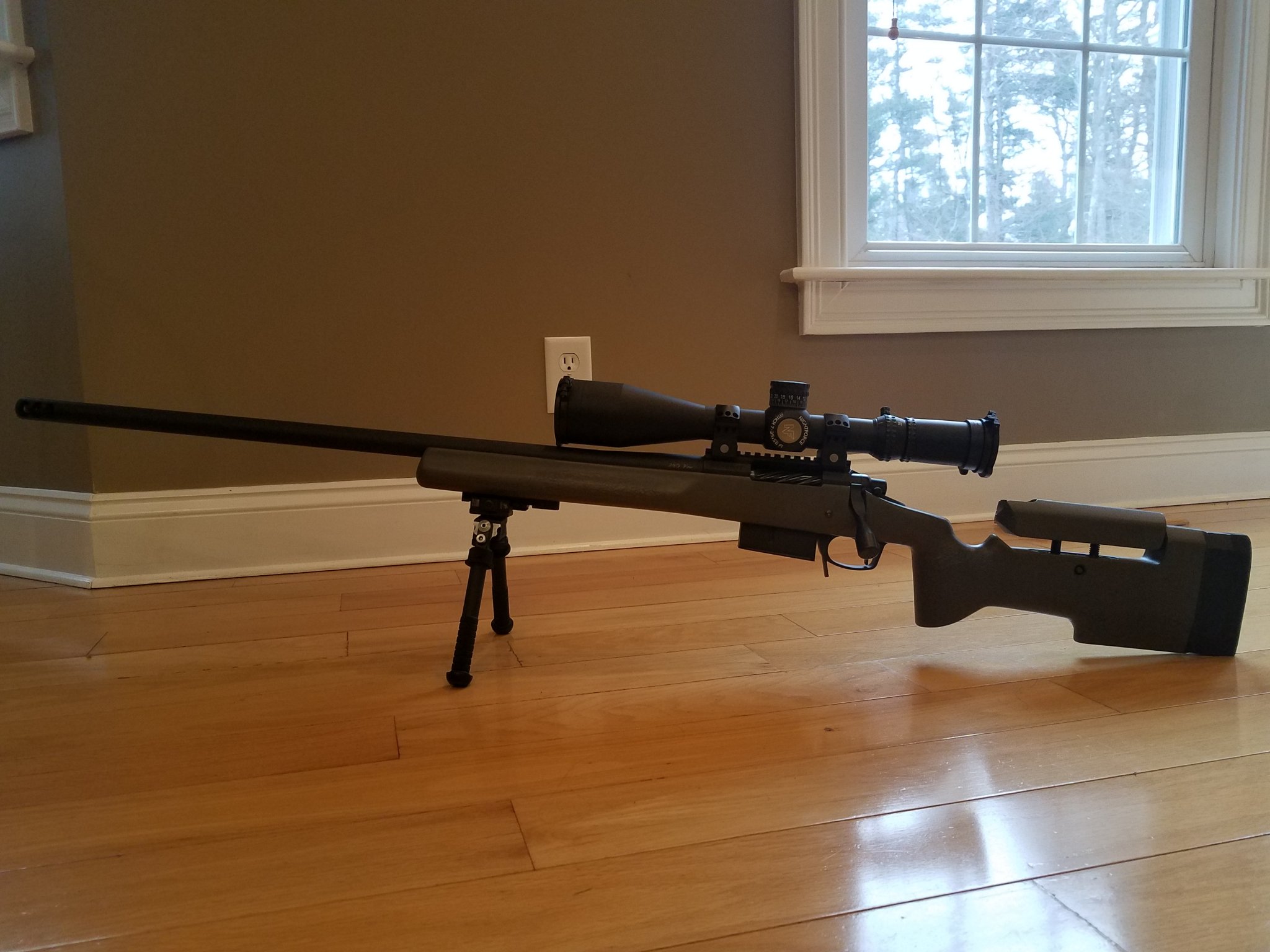

I spoke to a few people shooting both while planning my build. I went with RSAUM and I couldn’t be more pleased. I’m 7mm not 300, but close enough.
I’m 30 shots down the tube and shooting sub .25 MOA.
Thanks for the reply and info. Been away from the forum for awhile sorry for late reply
Is there advantage shooting 7mm over 300? Very nice rifle pic. What is the chassis and what are you running for action and barrel. I have been shooting a custom 260 Rem. for year . Have been looking to step it up a notch .

the reason I went 7mm over 30 is higher BC at lower weight. I built it around the Hornady 180eld-match. Basically less recoil and better long range ballistics.
My build is a rem 700 action, Bartlein #9 contour barrel finished at 28”. Action and bolt worked over, and barrel cut, crowned, and chambered by APR.
Is there advantage shooting 7mm over 300? Very nice rifle pic. What is the chassis and what are you running for action and barrel. I have been shooting a custom 260 Rem. for year . Have been looking to step it up a notch .View attachment 6892754
Sounds like a very nice rifle you got there. If I do another build will have to consider a similar build. Thanks for the info

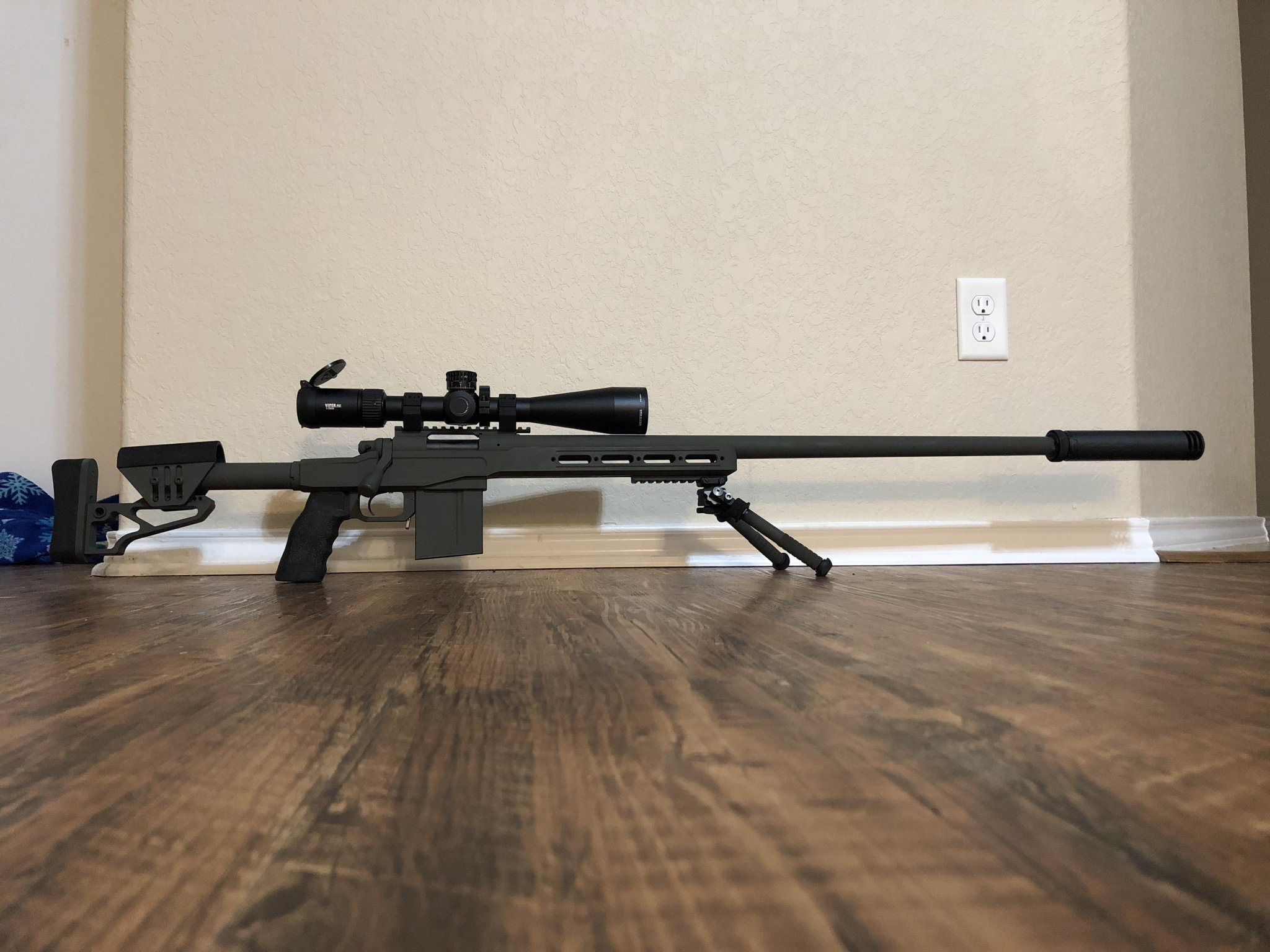

I'm using a 300 wsm. Stiller tac action 28 inch rock creek barrel suppressed with h4350 and 215 bergers and couldn't be happier. I haven't got past 1400 yards or so because of no good place to do it but I shoot at 1400 often. With no wind or very consistent wind it's surprising how good it shoots out there.
