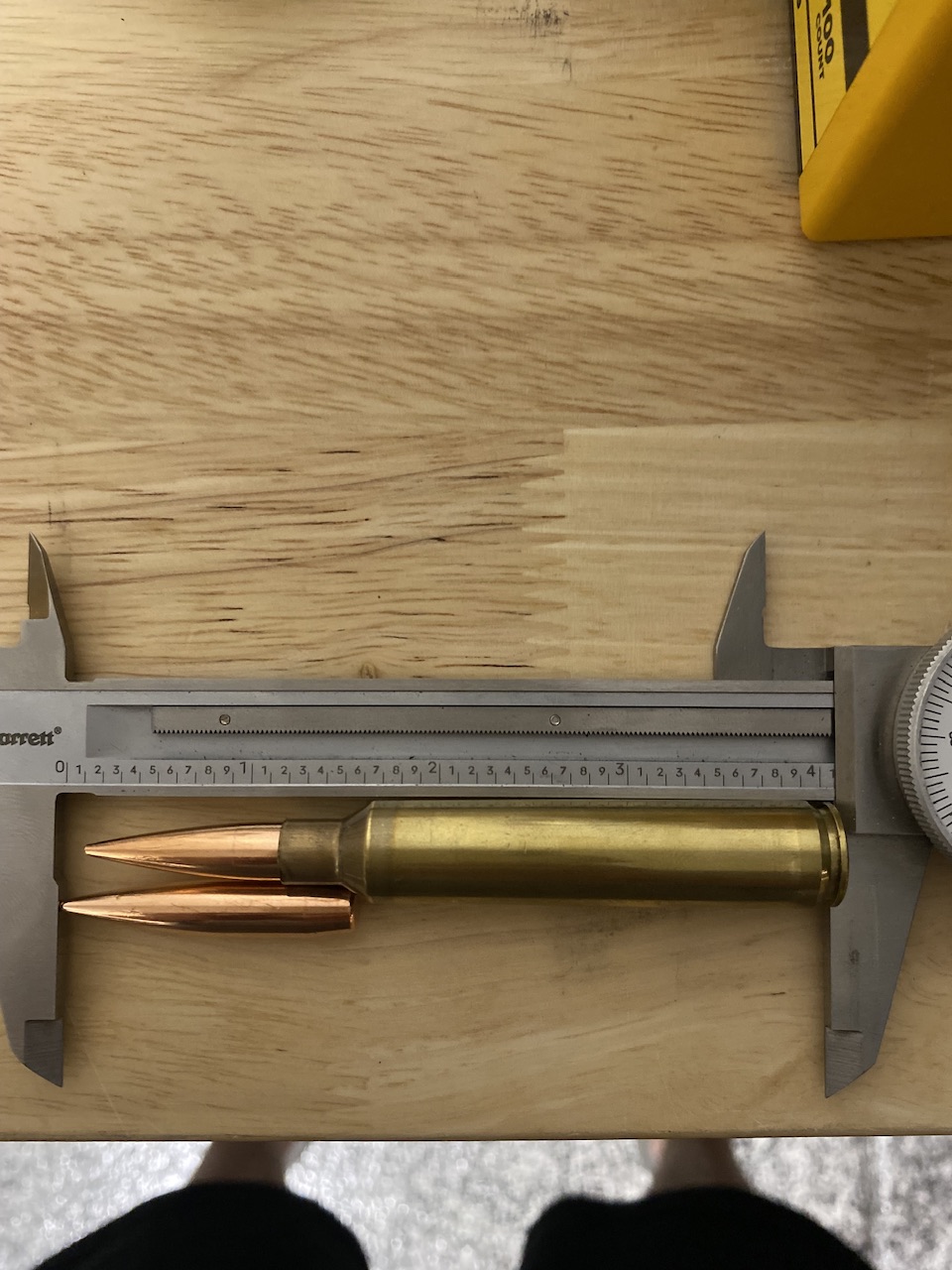

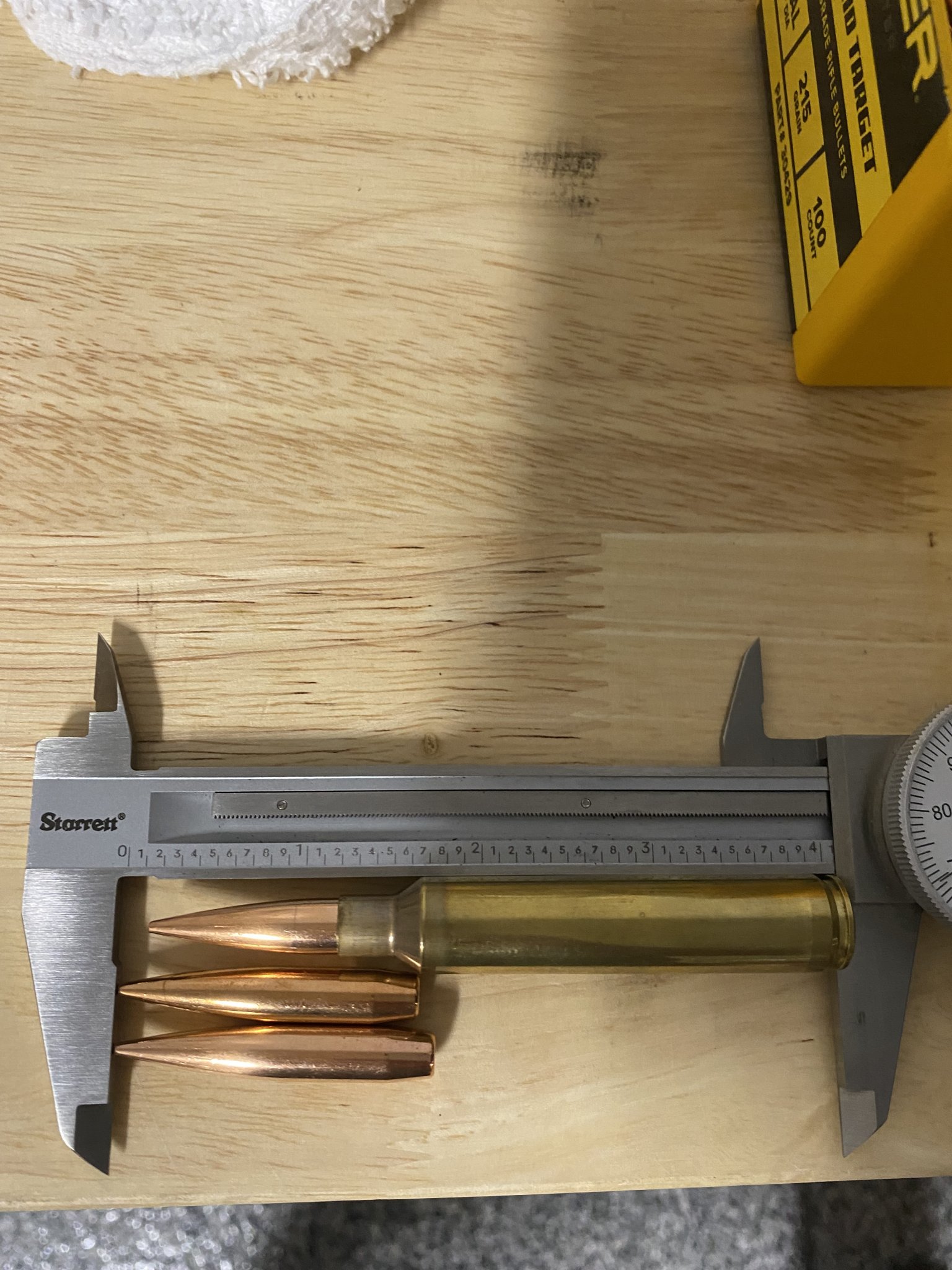

A 32” barrel with a 245 and N570 should get you 3000 FPS easily. You definitely need a custom throat. Good idea going single shot. Even a 4” box won’t do what you need. In the pictures show a 215, 230 and 245 at 4.070. The bullet seated is my 300 RUM around 3.83. I shoot 230’s at 3050 with 86.5 grains of H1000 out of a 30” barrel.
If you shoot slow and don’t get the barrel really hot you can get 800-1000. If you shoot one right after another, especially with N570 you will shorten barrel life.
The great thing about 4.070 is it gives you the option to run 215, 230 and 245’s. Lane precisions rifles reamer is set up for 4.070. Dallas lane said 3000fps with 245’s and N570 is doable out of a 26” barrel.

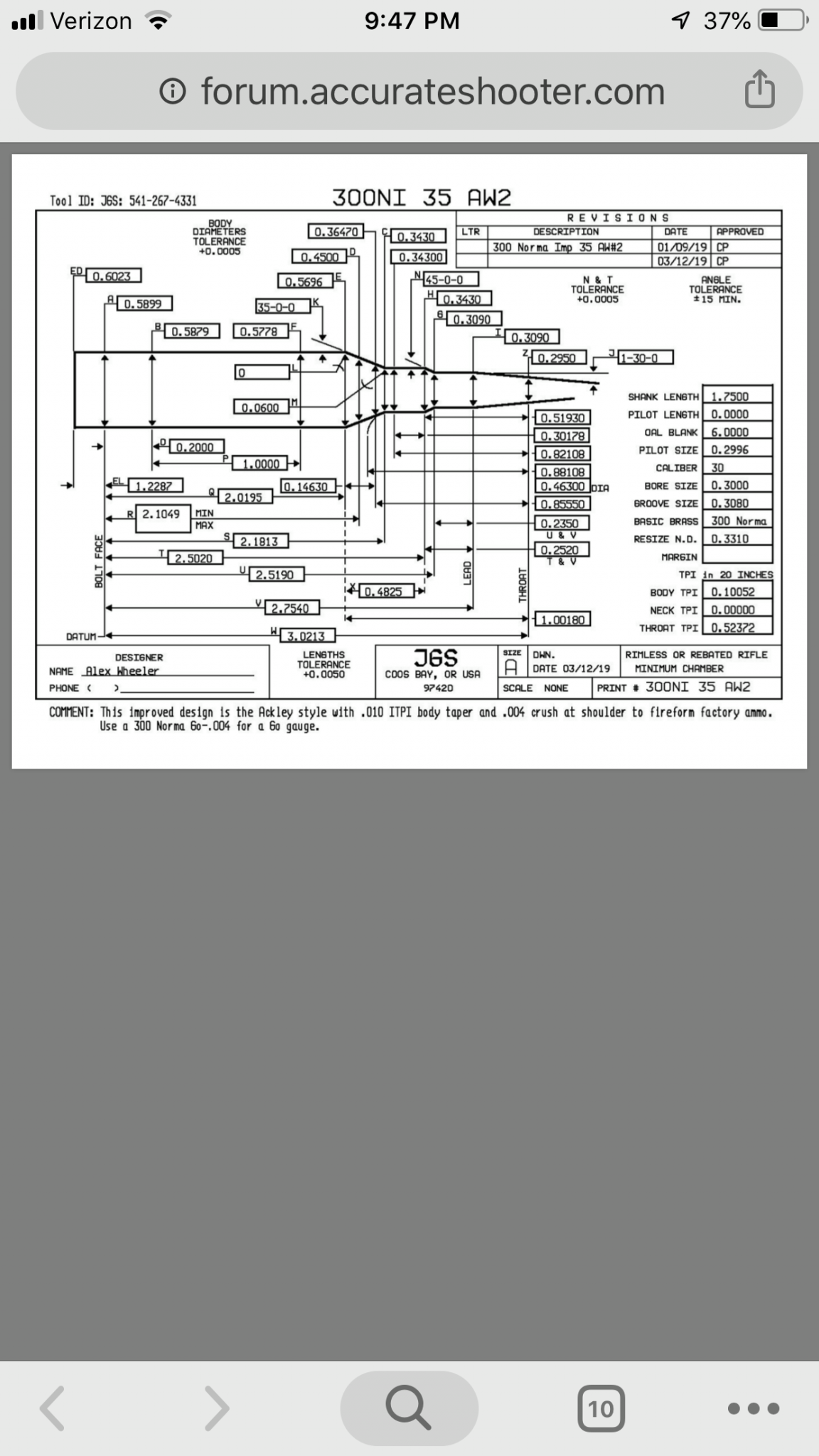

This one? Dedicated 245/250 could use a lil more freebore. N570 makes freebore in abundance tho.

This one? Dedicated 245/250 could use a lil more freebore. N570 makes freebore in abundance tho.View attachment 8221665

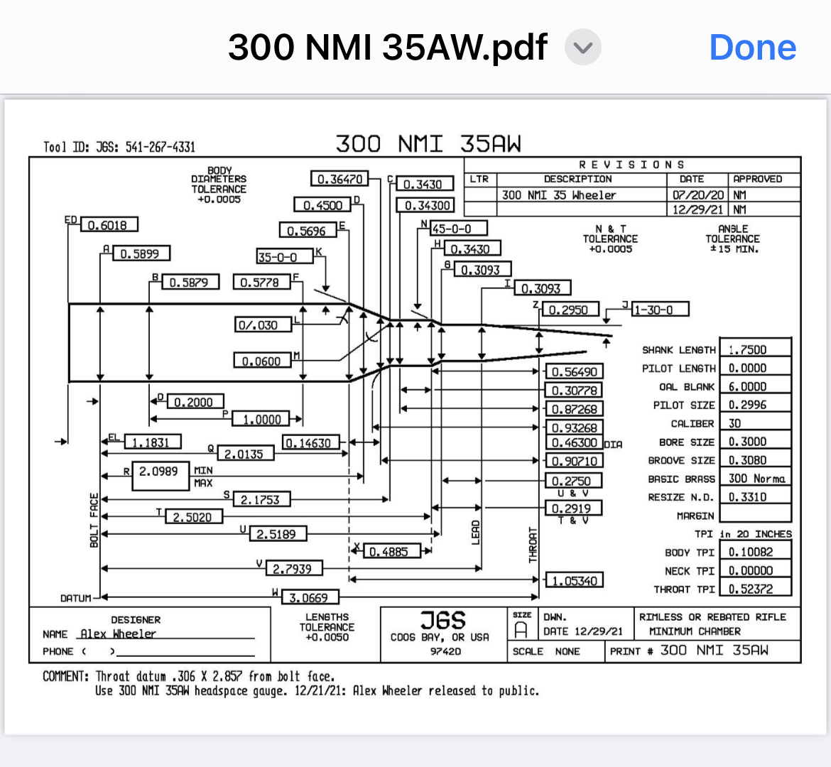

I am running the 35AW, not the AW2 (I attached my reamer print below), and if you shoot alex a message asking what freebore he has set up for the 250s he will pass that info. He has 3 freebore lengths tested. One for the 215/208 Bergers which I believe is the one you posted above. My reamer length which was setup for the 220/230s/will work with the 245s, and then one for the 250 specifically. Can’t recall the freebore for the 250 reamer off the top of my head but yea, it does have more than the print you posted.
This is my reamer:
