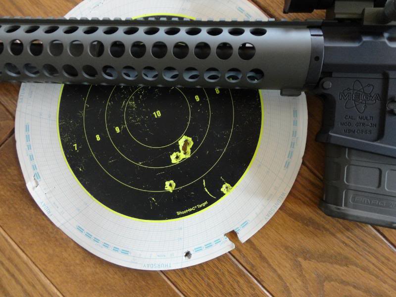

I also built an AR built with 8 twist barrel at 16.
I am happy with my accuracy with subs.
