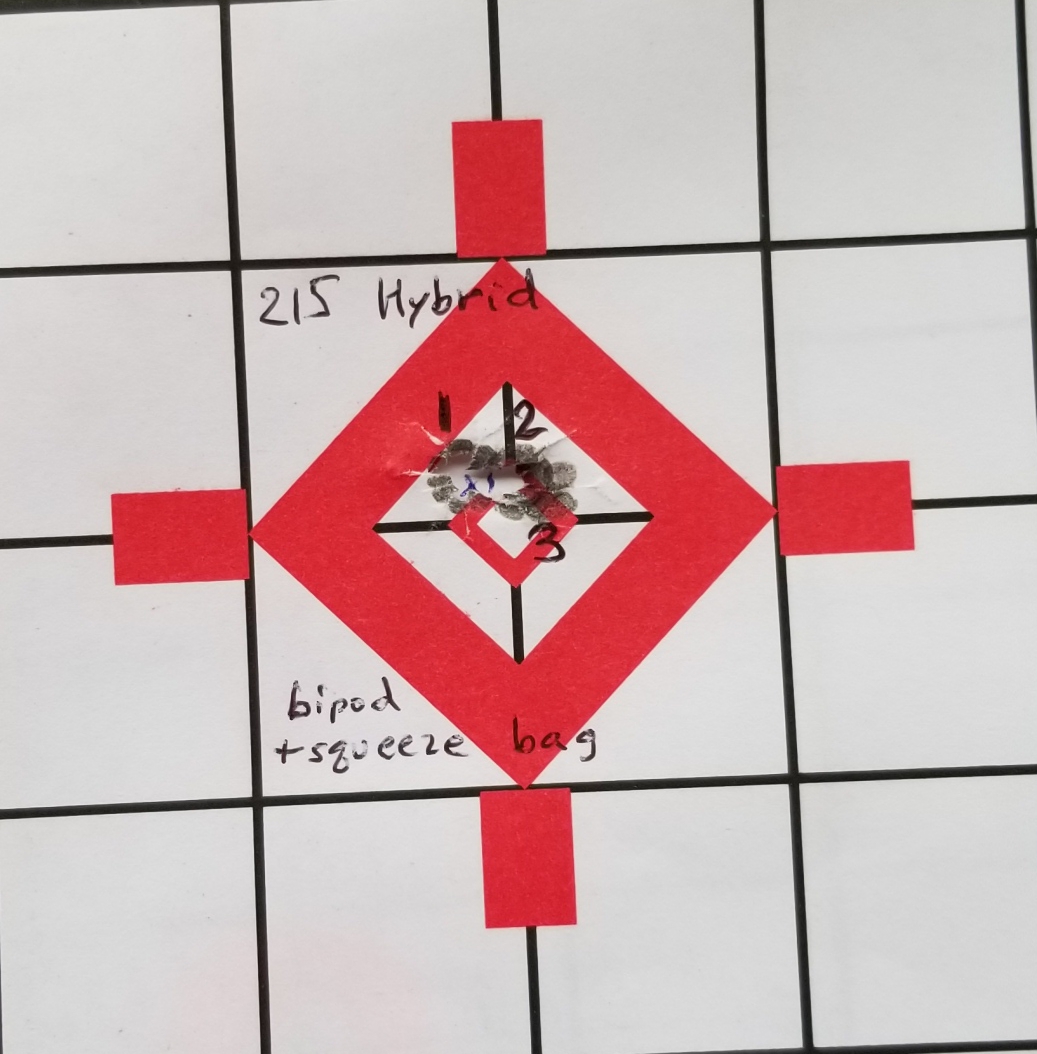

I've recently worked up a load for the 215 Hybrid. Shoots amazingly well. I'm using Norma brass, (the lite weight variety), CCI Magnum primer, and H1000. I needed them to fit in the magazine so I'm 0.050" off the lands. 2860 fps out of a 26" barrel.
Wow, that is an outstanding grouo. I have MDT 3.715 MAGs and they fit my bullets that are aboit .001 off the lands. I will definitely attempt your distance if the grouos arent tight. I have a 26in proof research barrel
