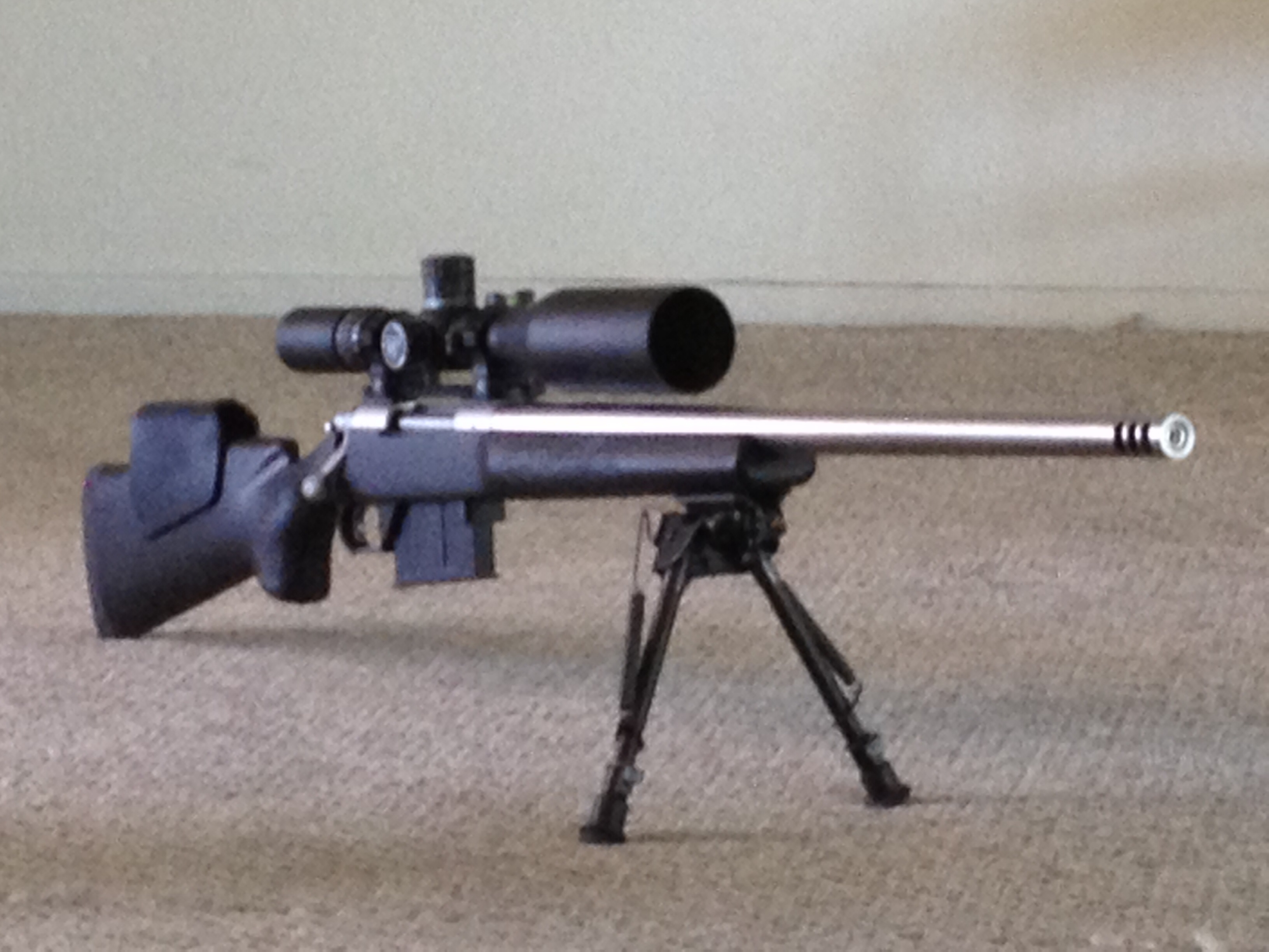

I just came across this old thread, and thought I would update a bit. I've been working with this rifle again lately. It never shot the 190 grain SMKs worth a crap as I had hoped.
But it LOVES 210 gr Berger VLDs over about 75 grains of H1000 seated about .015 off the lands. I'm about to load up several hundred of these.
Attached are a few early targets during load development. My best group ever was five shots into .56 inches at 200 yards (.28 MOA). More typical groups hover around a half MOA, give or take. If it keeps doing that, I guess I'll be a happy dude.
