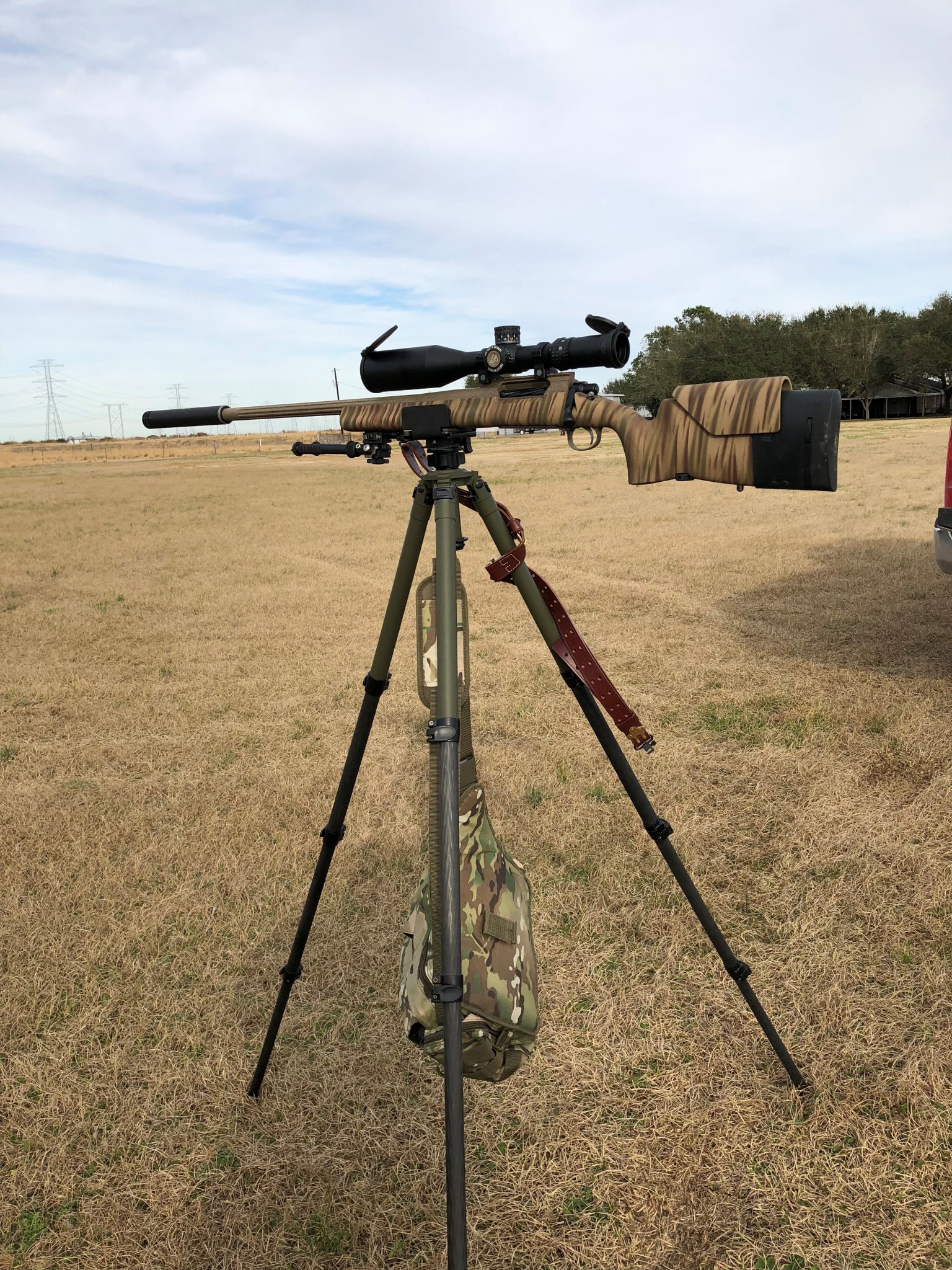

My 300WM is a 26" Krieger 5R in truck axle contour and I'm at 1400 chunking the 200gr eldx 2985. Rifle started off in the .2-.3 range and has come up to .6-7. After this hunting season I'm considering chunking it for a 1:9 to launch the heavies.

I've chased some , but am nearing the point of exceeding the length of my internal box mag....rifle is used for hunting and I really don't want to single feed. It's a pig to carry, but man it hammers these Texas deer and pigs.

Internal box mag. I have an issue where when cycling the bolt it will contact the adjustable cheek piece at the setting I normally leave it at.....when the rifle goes back to get a new tube I'll have that addressed along with setting the rifle up to run detachable mags. Rifle was built by a local guy and was my first custom build, some of the fit and final polish, like the damn bolt hitting the cheek piece, need to be cleaned up. It's been a laser beam and I've thoroughly enjoyed it, but some small changes are in order. My wife and I build cosmetically matching rifles for out wedding, she has a sporter stock but all the same finish in 7STW, so i want to keep the finish the same otherwise knowing what I know now I'd chunk it in a chassi.
