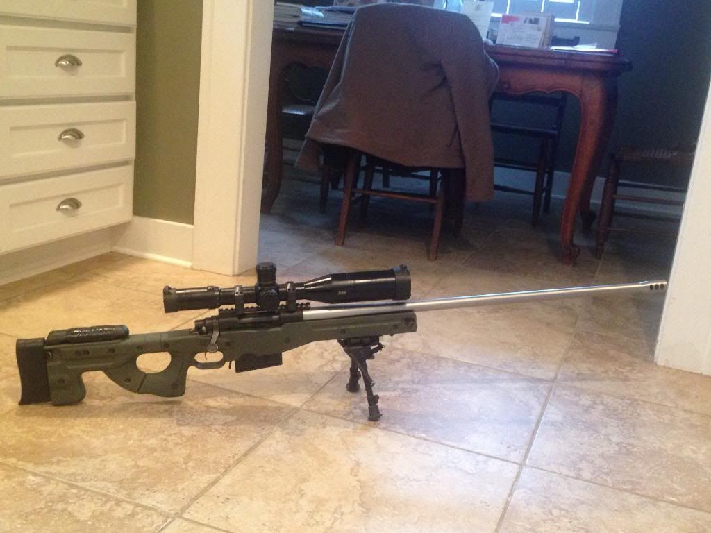

I want it as heavy as possible to reduce as much recoil as possible, unfortunately a brake is not on the cards due to f class rules and my local range rules. And of course it has to be long for optimum performance at the longer ranges.
This rifle is not meant to be very mobile! Lol.
All in all I already have a ripper .308 (pic attached) and my aim was to produce a 'big brother' version. Still using an AI chassis to keep ergonomics the same, but I wanted a bit more oomph for longer range.
Thanks again for the suggestions.
