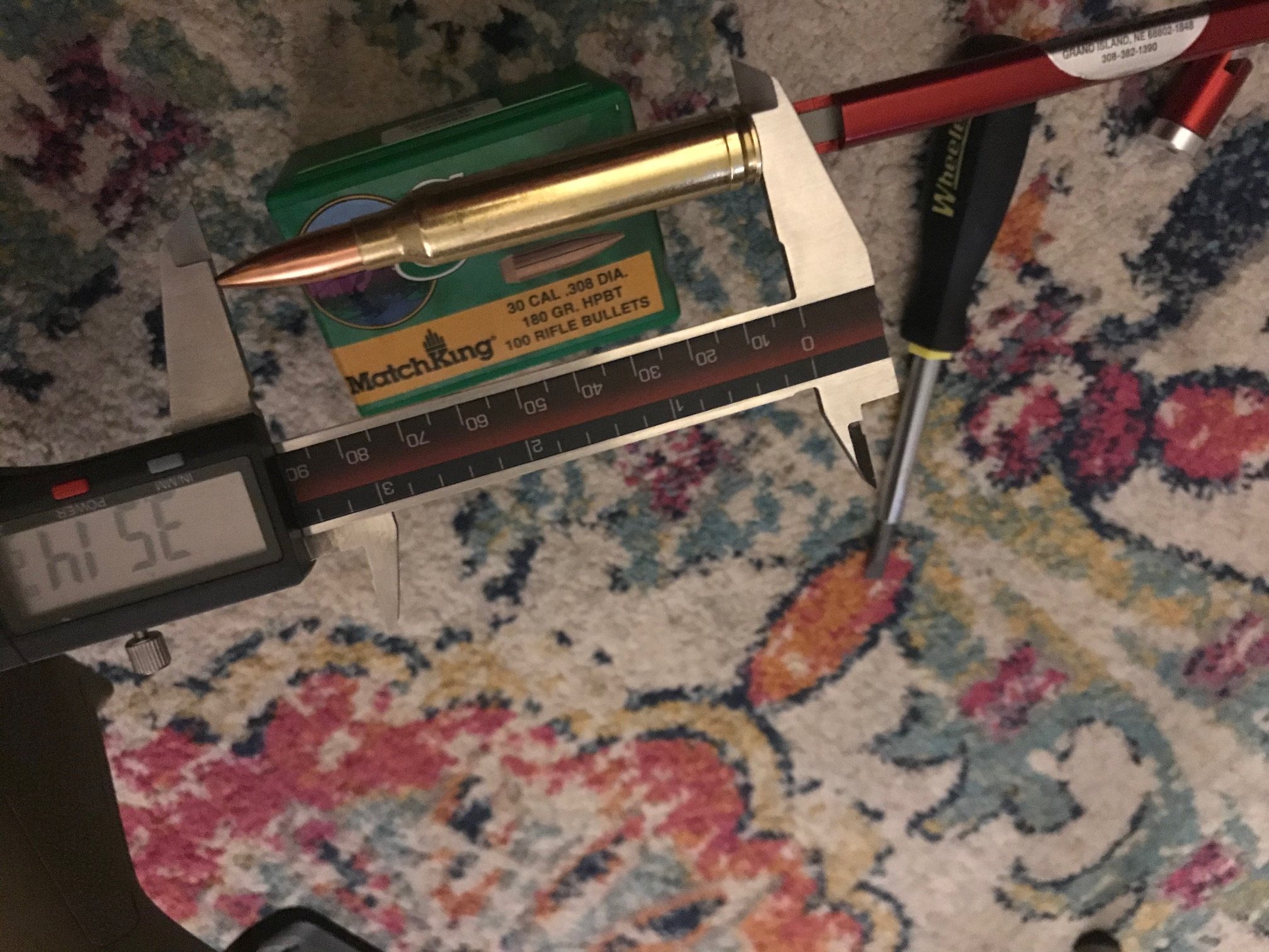

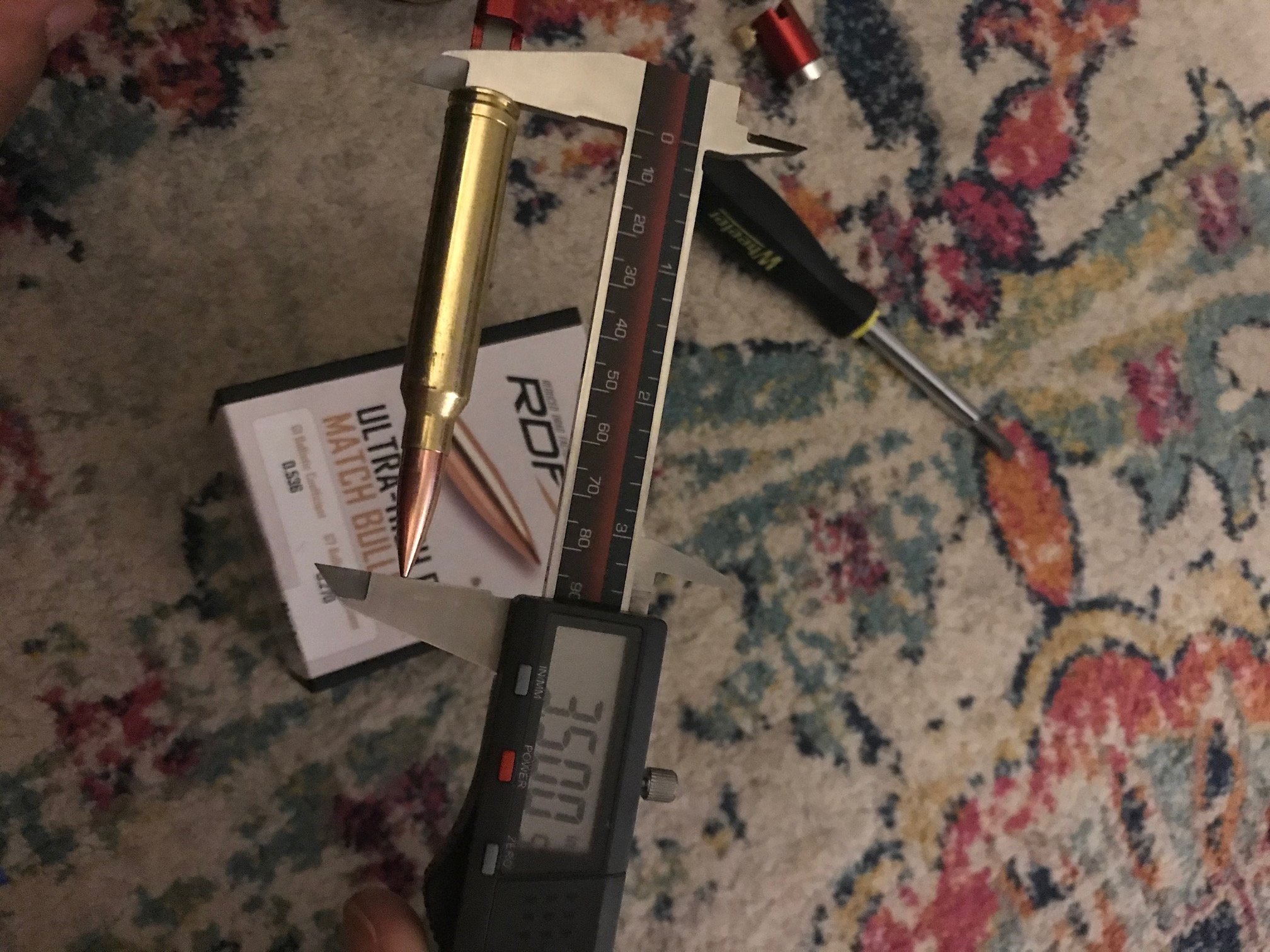

Re did the measurements again. Using modified case with OAL guage.
Federal GMM OAL OAL 3.331"
Modified case with guage measures 3.500" with 175 gr RDF bullet
Modified case with SMK 180 gr bullet 3.514"
Gauge was zeroed. Rechecked measurements 10 times and they were all consistent. No burrs.
So going forward, if I want to load to decrease free travel, it seems I should test from 3.47 OAL for RDF?

If that’s what you get then that’s what you get. You now know your max length for the chamber. Start at that length if it can fit in your mag, if not then shorten it until it does.
Next is to get the Hornady bullet comparators so that you can measure based on the ogive riiiiiight in front of the bearing surface where the bullet actually touches the barrel instead of the nose that floats in space.
I think it might be best to just load everything to max allowable magazine length and tweak accuracy with everything else. I’ve gone down this distance to lands rabbit hole and discovered some of my most accurate loads were .060-.095 off the lands.
