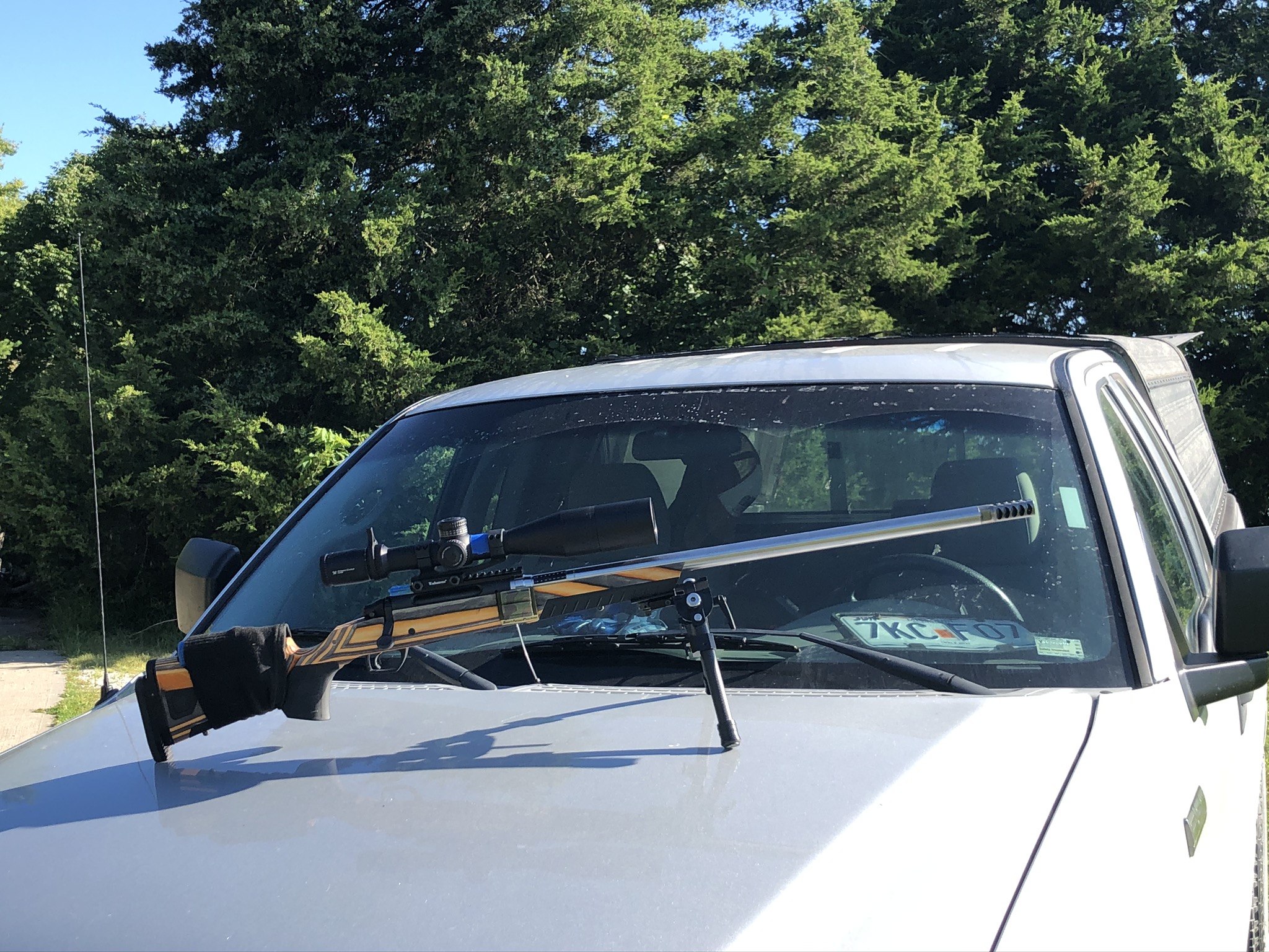

I built my “cheap” 300 WM out of a Remington 783. Replaced the factory barrel with a 26” Criterion bull match barrel and a Boyd’s stock. It has the factory magazine but PTG makes a bottom metal /box magazine for it.
